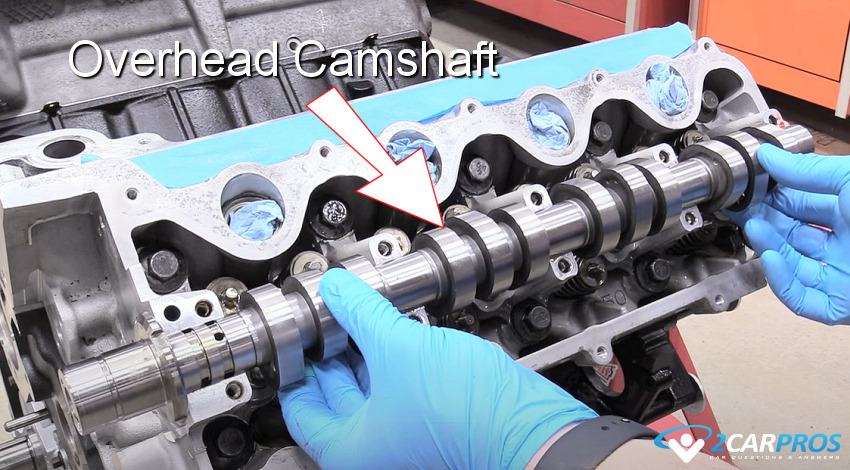

1. Overhead Camshafts
automotive engine overhead camshaft

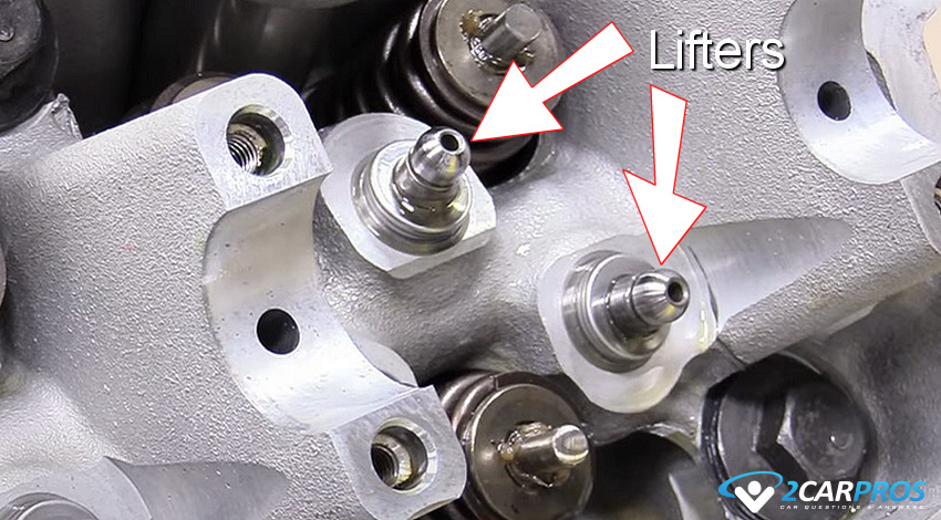

By far the most popular design is the over head camshaft because of its simplicity. Overhead camshaft designs include a lifter that is located in the cylinder head and is used to automatically adjust the valve lash (clearance). This lifter provides the adjustment between the camshaft and valve which allows the valve to fully close without excess clearance. The lifter galley oil passage is designed into the cylinder head to supply oil pressure provided by the engine's oil pump via the block's internal oil galleys which is used to lubricate the lifter as well as help it control valve lash (clearance).
engine camshaft lifters

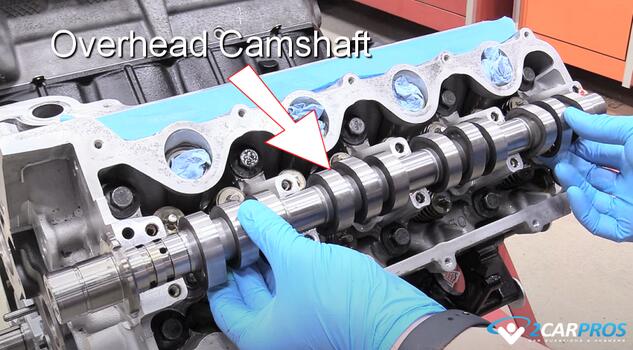

Here we show an overhead cam set up with the cylinder head and block cutaway, the lifters are directly over the valve spring with four valves per cylinder, two intake and two exhaust. On four valve set ups, the valves are slightly smaller in size but may allow more air flow than one larger valve.
overhead camshaft cutaway
As the camshaft rotates the lobe which protrudes from the centerline forces the cam follower downward which in turn opens the valve. The rocker is equipped with a needle bearing roller to reduce friction and help the engine's performance. This style of rocker arm is also known as a cam follower.

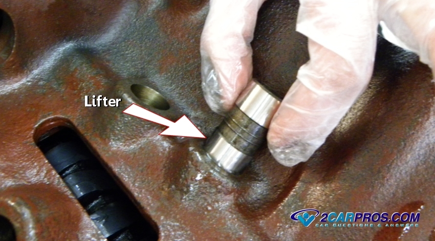

In this configuration the lifter rides inside a lifter bore which is located in the engine block itself. Roller lifters are exactly as the name implies, they are designed with a roller wheel and needle bearings that ride along the camshaft which reduces drag. A lifter can also be called a tappet, this picture shows the lifter being removed from the top side of the engine block.
lifter in block

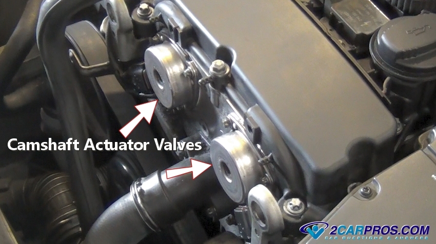

3. Variable Valve Timing Camshafts
Modern engines often use variable valve timing (VVT) systems to adjust the camshaft's position relative to the crankshaft. This adjustment improves engine efficiency, power, and emissions by optimizing valve timing for different operating conditions. More information: Variable Camshaft Timing
camshaft actuator valves

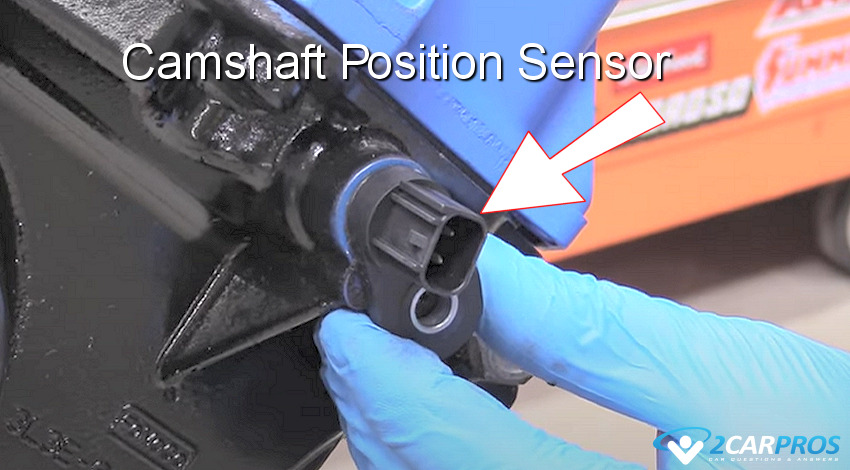

The camshaft position sensor can be located at the front or rear of the camshaft in most cases. These are simple two wire sensors, here is what they look like in the image below.
automotive engine camshaft position sensor
