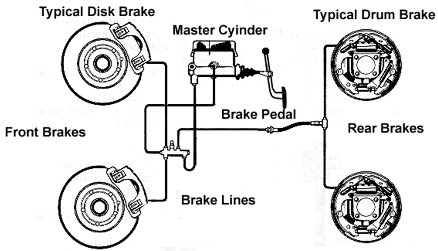

Brake systems are designed to slow the vehicles wheel movement through friction. There are primarily two brake types of systems, ABS and non ABS (anti-lock brake system). Both systems work on basic hydraulics and utilize a brake master cylinder (connected to the brake pedal) that supplies brake fluid pressure to the front brake calipers and rear wheel cylinder or brake calipers if so equipped.  The brake system requires hydraulic force that is many times greater than the force applied by the foot. This added hydraulic force is achieved by leverage multiplication.
Power brake systems utilize either vacuum (vacuum assist) or power steering (hydro-boost) to multiply the force without added pedal effort. When the brake pedal is forced down brake fluid from the master cylinder is transferred to the brake caliper piston, pressurized fluid is transmitted to the brake calipers or wheel cylinders.
Brake System
Typical Non ABS Brake System
A major problem to a brake system is a brake fluid leakage, if there is a slow leak in the system it will affect the brake master cylinder by allowing air into the system creating a low pedal and eventual brake operation failure. If a large brake fluid leak is present, fluid escapes, leading to a major brake failure on one half of the system (front or rear.) A master cylinder has a built in safety device, two separate hydraulic systems a primary and secondary, with separate reservoirs separating front and rear brake operation. In case of front or rear brake operation failure, one system will still be present.
