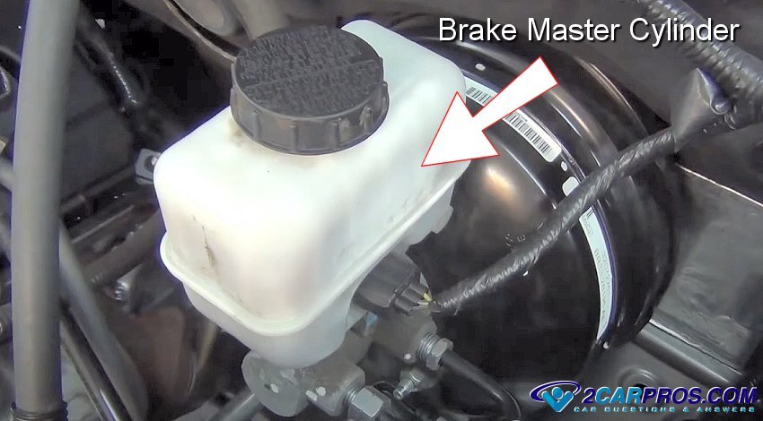

The brake master cylinder is the hydraulic pressure part of the brake system which holds brake fluid in it's reservoir. When the brake pedal is pushed down the plunger inside the brake master cylinder housing is forced forward which transfers pressurized fluid to the brake calipers or wheel cylinders which then activates the brake system to slow the car down.
The master cylinder is divided into two separate sections, a primary and secondary pressure system. This "built in" safety system was created inside the master cylinder so if one half of the brake system fails, the car will still have the remaining half to help slow the vehicle down. This safety precaution is divided into front or rear brake systems.

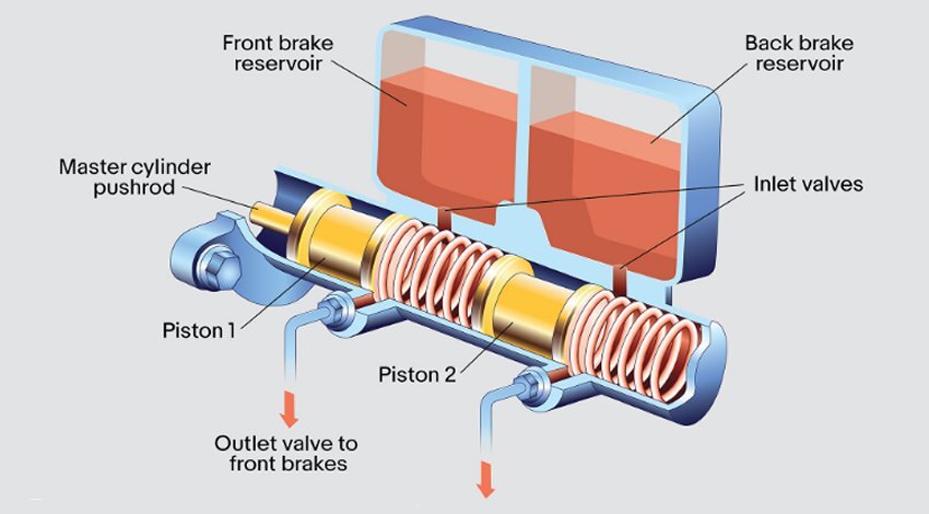

Brake Master Cylinder Exploded View
Here you can see the inner workers of a typical brake master cylinder included the brake fluid reservoir.

1. When the brake master is at rest (not in use) the piston or plunger rests at the rear on the master housing bore and is held in place by return springs. These springs are responsible for pushing back the brake pedal along with the piston after a braking event to allow the brake system to release.
2. The brake fluid reservoir is used to store brake fluid while allowing fluid to enter the piston chamber through two small orifices at the top of the housing and below the fluid reservoir, these ports supply the brake system with brake fluid.
3. As you can see by the image above, the system is designed with two separate seal and plunger applications which help stop the car if either the front, or rear brake system has failed. Older cars only had one chamber which was hazardous.
4. When the driver applies the brakes, a pushrod at the top of the brake pedal actuates the brake booster which, in turn transfers the force to the master cylinder and depress the piston which moves forward and creates hydraulic pressure. This pressure is transmitted through the brake lines through the ABS system and then to the calipers or wheel cylinders at each wheel.
5. When the brake pedal is released the master cylinder and brake booster return springs force the brake pedal into the upright or natural position while allowing the brake fluid to travel back into the fluid reservoir for future use.
