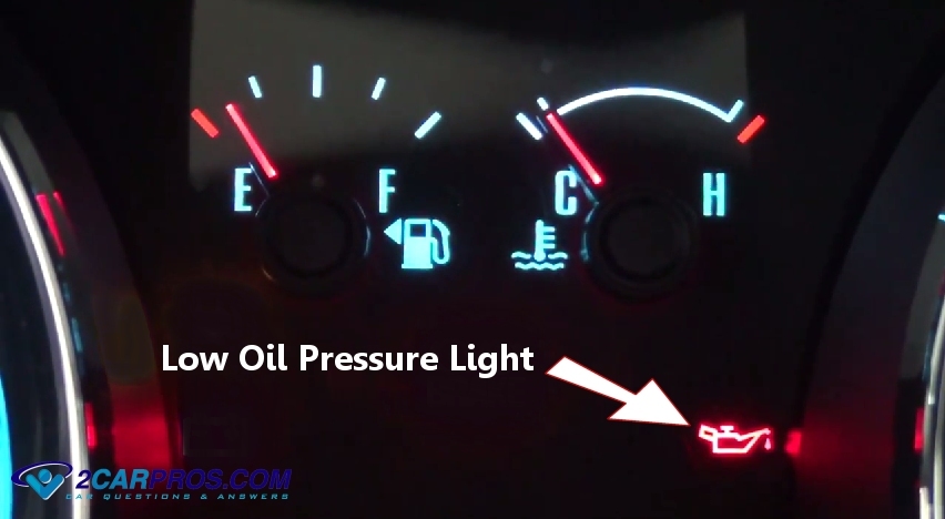

To verify the engine oil pressure is low, start the engine (cold) and observe the gauge or light.
oil low pressure

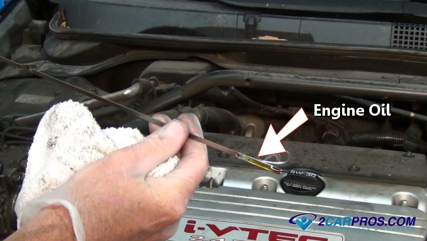

Using the engine oil dip stick, check the oil level of the engine and ensure a proper level.
engine oil

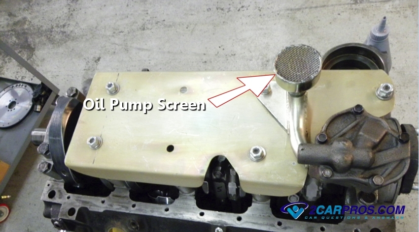

The oil pump uses a screen to keep out impurities before entering the pump. If this screen becomes plugged with sludge due to lack of maintenance, the pump will scavenge causing low pressure. (Engine oil pan removed while turned over.)
oil pump pick up screen

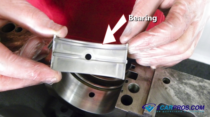

An engine bearing is designed to support the crankshaft and other various engine parts while in motion. When these bearings wear, they can allow more oil to escape causing low oil pressure, this is a sign the engine has worn out and replacement or rebuilding is needed.
engine bearing

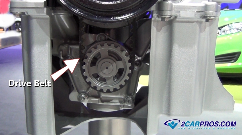

If the engine has no oil pressure, suspect the oil pump drive, some manufactures use a belt to drive the pump which are prone to failure.
oil pump drive belt
