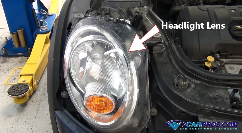

Identify the headlight lens and housing by lifting the hood, please visit our hood release guide for further instructions.

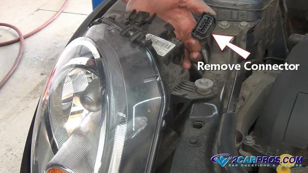

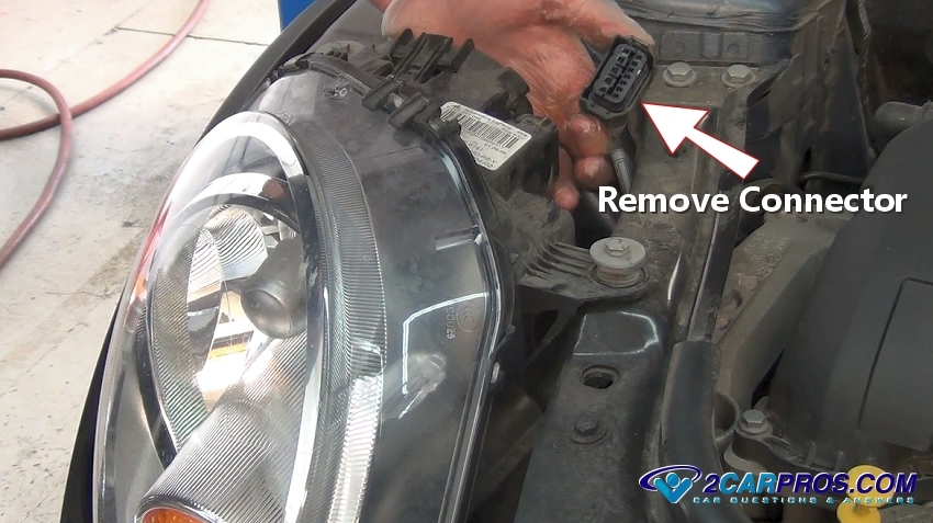

Start by locating and removing the headlight electrical connector by releasing the safety clip. (Note: If the connector is not accessible this step can be performed in later steps.)
remove electrical connector headlight lens

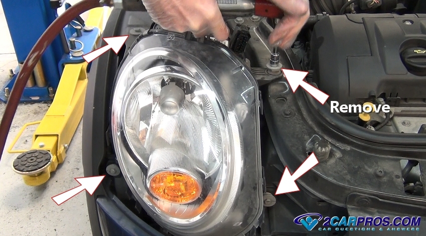

Locate and remove the headlight lens housing mounting bolts, some could be obscure and might need to be accessed from under the car.
remove headlight lens mounting bolts

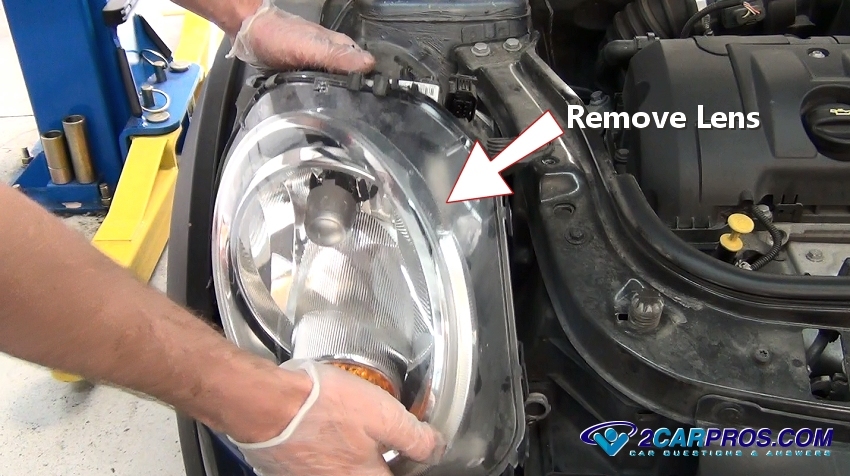

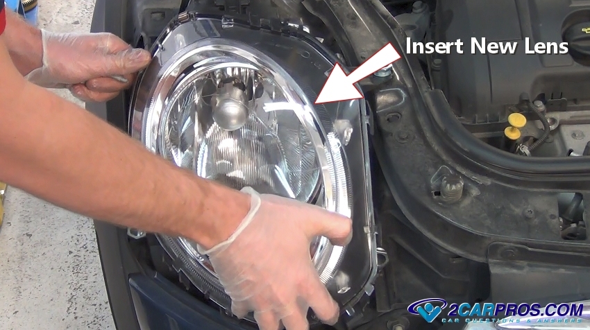

Once all mounting bolts have been removed, firmly grasp the headlight lens and remove it.

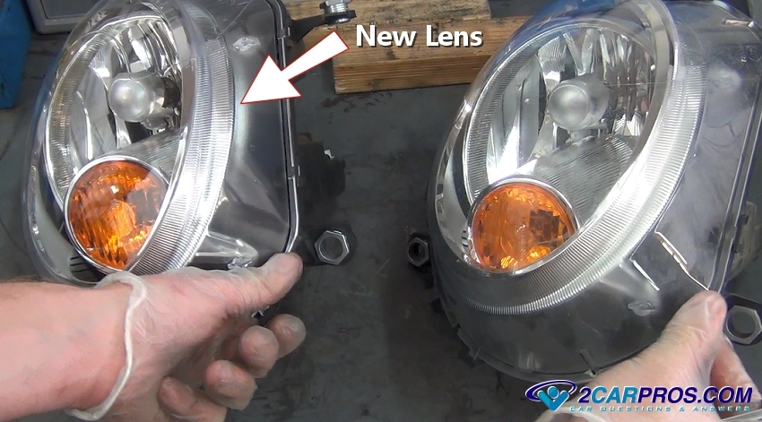

Once removed, compare the new lens to the old assembly, they should match identically.
new headlight lens

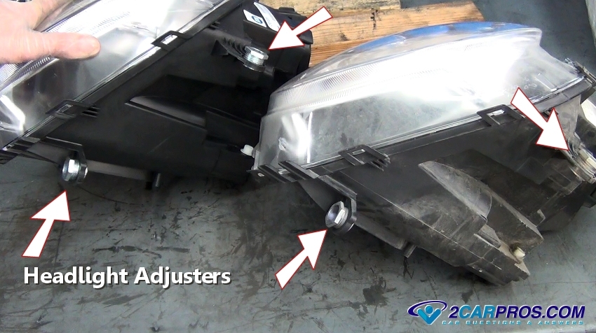

When matching the new lens to the old unit, take note of the adjuster position and match the number of threads showing to the new assembly. These adjustments control the height and right to left direction and need to be as close as possible. (Note: If further adjustment is needed once completed use a flat driveway and garage door (down) at night to help level the beams.)
headlight adjusters
Once the necessary adjustments have been made gently lower the new assembly into place while keeping the wiring harness out of the way.
insert new headlight lens

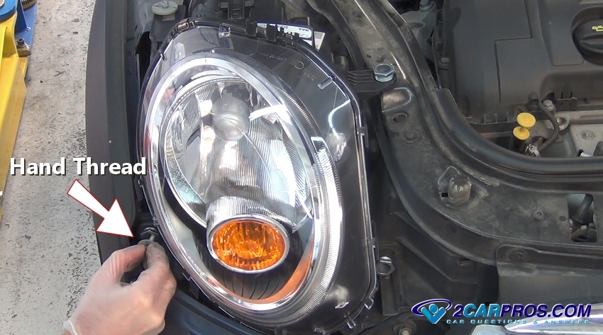

Hand thread headlight lens mounting bolts to avoid cross threading.
install headlight lens mounting bolts

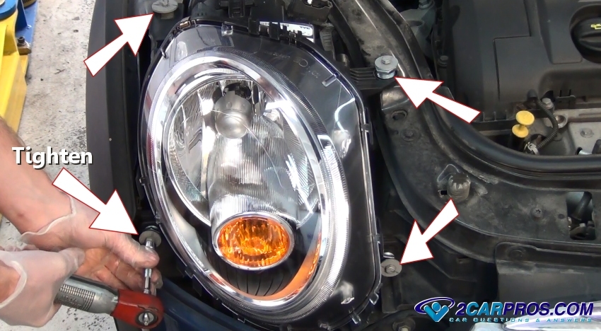

After all mounting bolts are hand threaded, tighten the bolts evenly in a cross pattern (do not over tighten).
tighten headlight lens mounting bolts

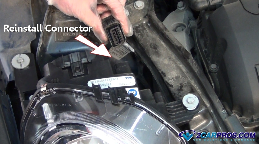

Inspect the electrical connector for dirt, corrosion or burn marks and replace if damaged, then reinstall the connector to the headlight lens receptacle.
reinstall headlight lens electrical connector
