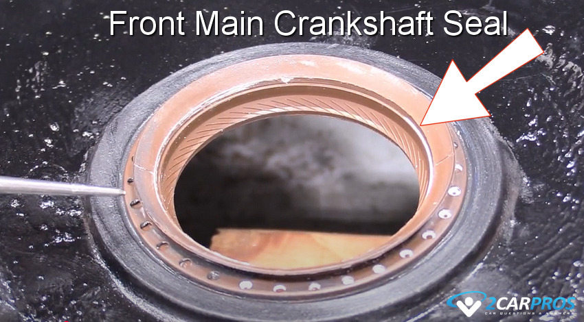

The front main seal will now be exposed at the front of the crankshaft. Use a large standard screwdriver or seal puller and pop the seal loose from the timing chain cover or seal housing. Work the seal loose by gently prying round the seal being careful not to score the metal of the seal housing or timing cover. Any major grooves into these parts can cause a leak once the new seal is installed. Once the seal has been removed inspect it for obvious failures such as dried, torn or dilapidated lip seals or a broken seal spring.

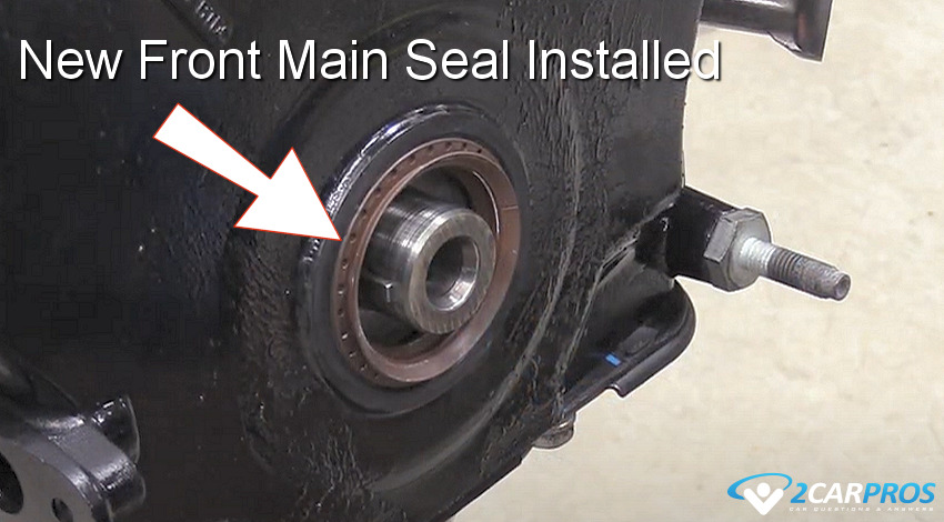

Be careful at this point because if you install the seal backward it will leak. The lip of the seal must be pointing inward toward the engine. Gently set the seal in place into the timing cover or seal housing. Now it is ready for installation, use a hammer and large socket or seal installer which you can rent from the local auto parts store. Gently tap the seal into place making sure the seal stays square throughout the installation process. The seal will sit flush or almost flush once it is fully installed, (do not push the seal too far inward).
automotive engine new crankshaft front main seal installed

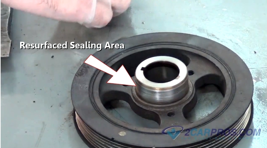

Inspect the balancer's sealing hub for damage or grooves where the old seal rode against. You should see burnt oil residue which is present in all engines, use a small piece of emery cloth or fine sandpaper and prepare a new clean surface for the new front main seal to ride against. If these grooves are too deep or a fresh surface cannot be made smooth the dampener must be replaced or the new seal will leak.
In the image below you can see what it should look like once you are finished preparing the balancer seal hub. Clean the hub using a shop towel and make sure there is no sanding grit left behind.
resurfaced front main seal area

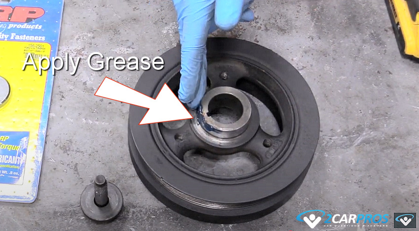

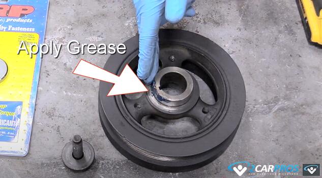

Apply a small amount of grease to the balancer hub sealing surface. This will lubricate the seal once the engine is started up. If you do not add grease at this point when the engine is started, the balancer will rotate burning the seal and jeopardizing its ability to work correctly.
apply grease front seal rotating surface
