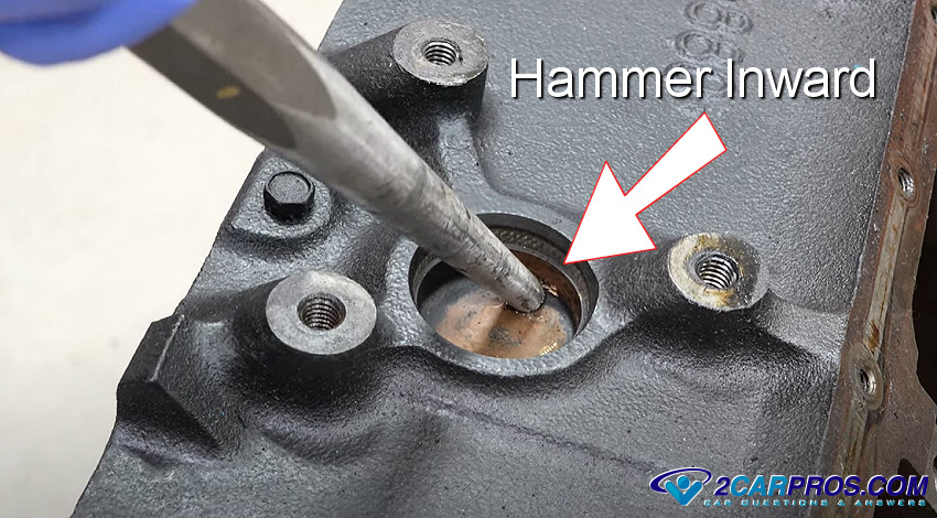

1. Push Freeze Plug Inward: Once you have disassembled and removed any obstructions that hinder the freeze plug service, use a large punch and hammer to force the freeze plug inward. Do not "score" the engine block during removal or it will cause a leak for the new soft plug.
hammer freeze plug inward

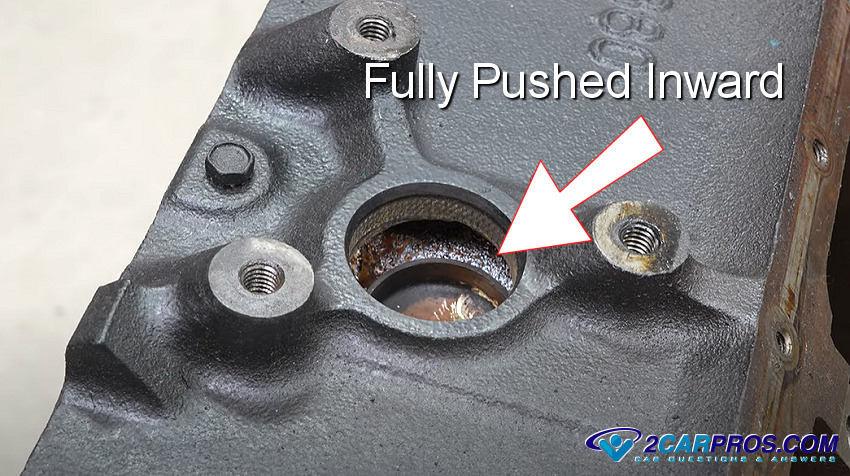

2. Fully Pushed Inward: Here is what it looks like when the freeze plug is fully pushed into the engine block. Some say you can just leave it there and install the new one, but I can tell you it can create a "hot spot" inside the engine as it impedes coolant flow.

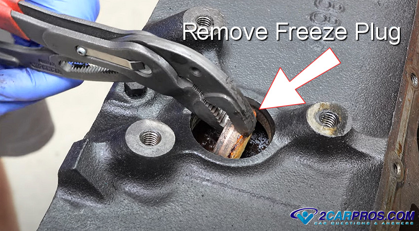

3. Remove Freeze Plug: Use a pair of channel locks to help grasp the freeze plug and pull it from the engine block, this can take some doing so hang in there.

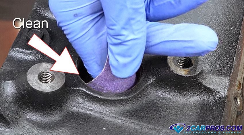

4. Clean Hole: You must clean out any rust or corrosion from the freeze plug hole to ensure a proper seal when the new freeze plug is installed. Clean the hole walls using emery cloth or sand paper until smooth.

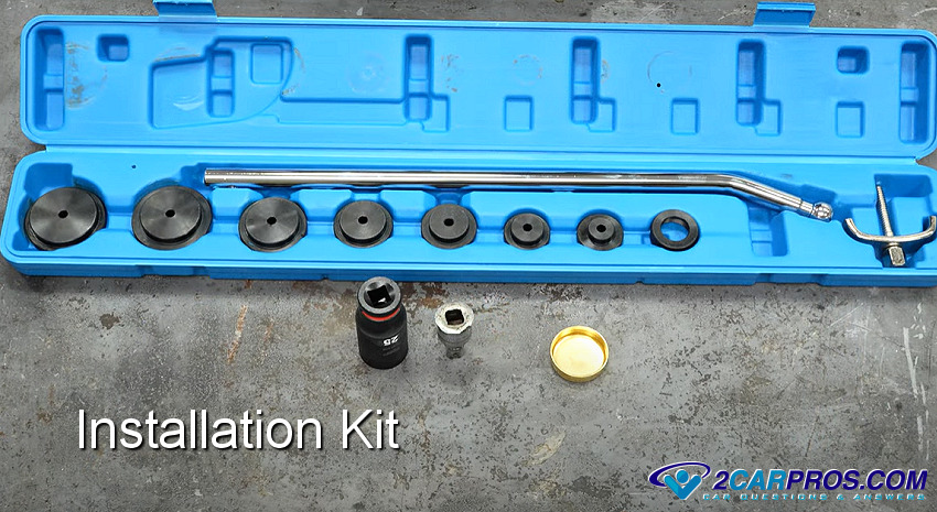

5. Freeze Plug Installation Kit: In some instances you will be able to use a socket to fit just inside the freeze plug to hammer it into place but most of the time you will need a freeze plug installation kit which enables you to install plugs into tight areas.

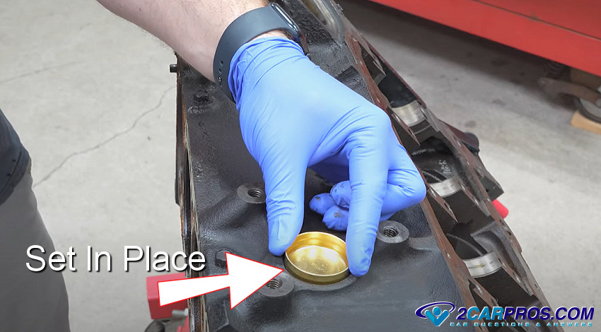

6. Set in Place: We prefer to apply a thin layer of RTV silicone to the edges of the plug for added sealing which is applied before installation. Remove the freeze plug from the freezer and push it into place, it should stay.

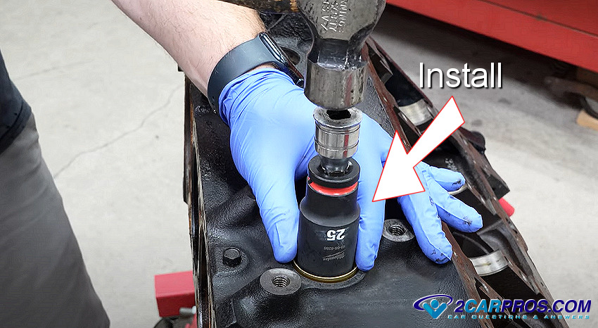

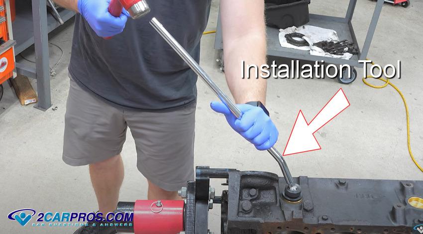

7. Install freeze Plug: You will need to assess the particular application to see if the simple hammer and deep well socket will work or if you need the added maneuverability of the installation tool. The goal is to drive the plug straight into the bore without tilting or damaging it.
install automotive engine block freeze plug
8. Freeze Plug Installation Tool: Attach the proper size adapter onto the freeze plug installation tool. This can help press the plug into the bock at precarious angles which can be handy when a regular hammer and socket cannot be used.
freeze plug installation tool in action

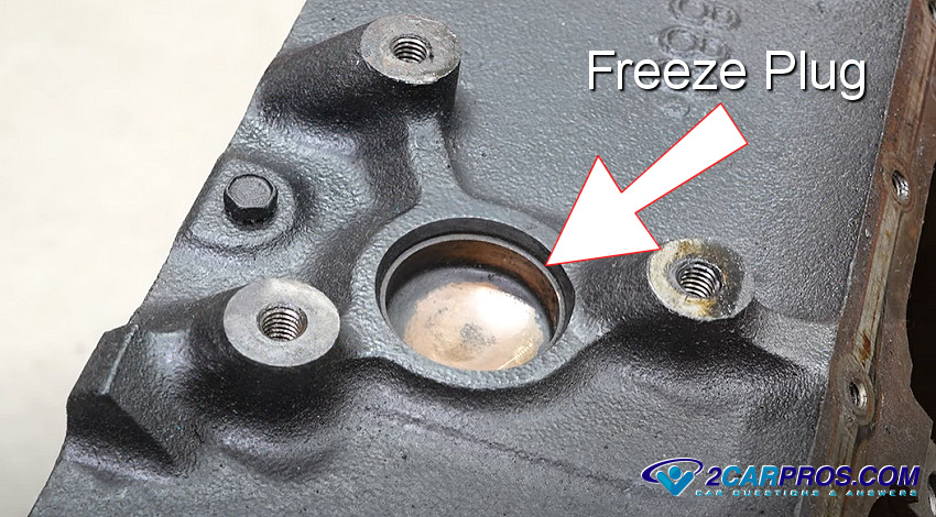

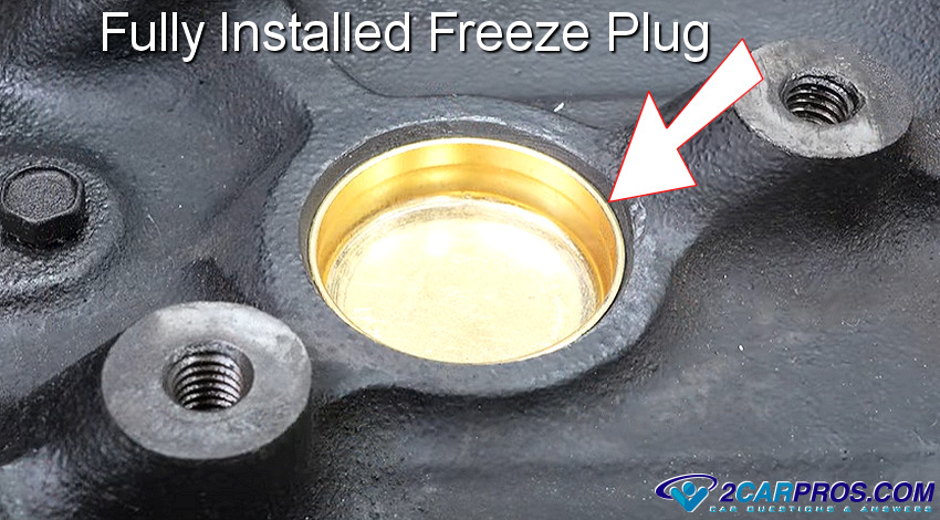

9. Fully Installed Freeze Plug: The freeze plug does not stop at a particular depth, so halt the installation once the rim of the freeze plug is at the top of the hole in the engine block. It is possible to push the new plug into the block much like the old plug.
fully installed automotive engine block freeze plug
