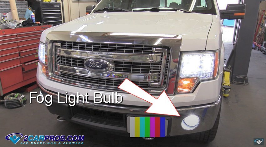

Park your car on level ground with the parking brake set, and the engine off. You may need to raise the front of the car to gain access to the fog light which is usually at the lower part of the front valance or bumper. It's also advisable to wear gloves to protect your hands and avoid getting oils from your skin on the new bulb, which can reduce its lifespan.

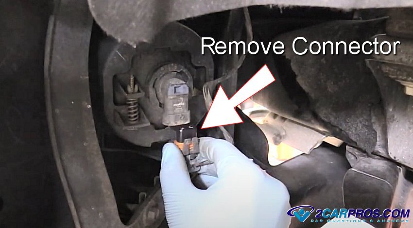

1. Once the car or truck is safely raised up, turn the front wheels to gain access to the rear of the fog light fixture, some vehicles will need to have the inner fender liner removed. Next, locate the bulb wiring connector and discounted it, this will have a clip safety that will need to be released. Avoid pulling on the wires directly to prevent damage.

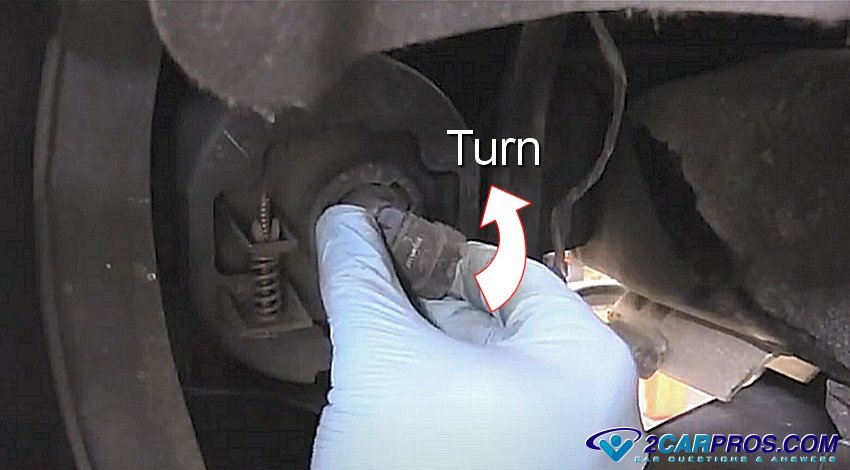

2. Grasp the fog light bulb and turn it counterclockwise while pushing inward slightly, this will dislodge the bulb from the fog light lens housing. Sometimes they can be a little stuck in which case you can use a pair of pliers to help break it loose. Depending on your vehicle, the bulb may be secured with a locking ring which can be released by being twisted it counterclockwise as well.

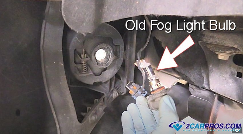

3. Gently remove the bulb from the housing for inspection, here is what the old fog light bulb looks like. The bulb may have a burned mark or be light blue in color indicating a leak in the glass, in either case the bulb is no good.
burned out fog light bulb

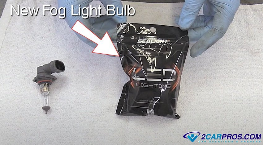

4. Match the old bulb to the new fog light bulb they should match identically unless they are being switched out to a LED style of bulb which will be different in appearance. Using a microfiber cloth, clean the new bulb to ensure there are no fingerprints or contaminants on the glass.

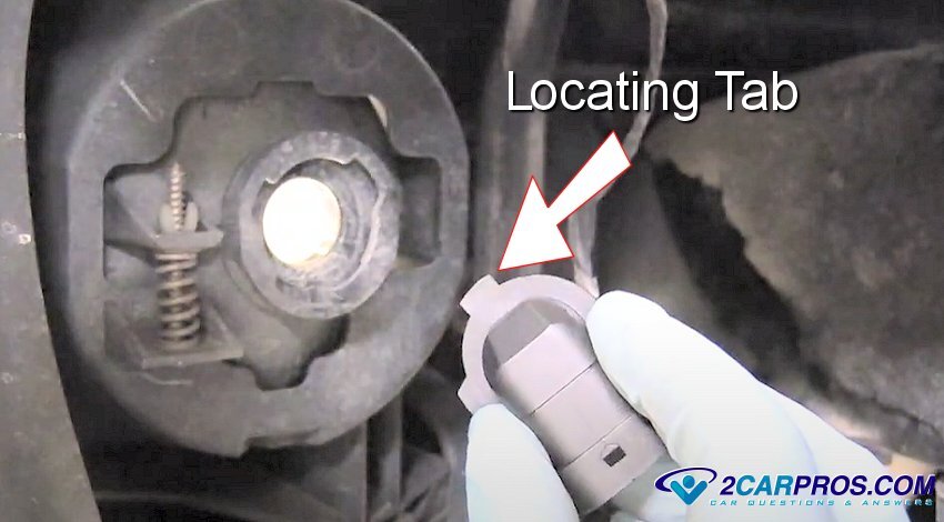

5. On the bulb, there will be locating tabs which must go into the fog light housing correctly, this helps the bulb filament orientation and location to be centered inside the lens. These tabs will be different sizes to avoid confusion.
fog light bulb locating tab

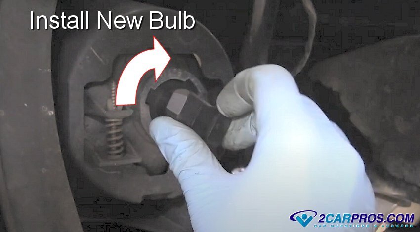

6. Insert the new fog light bulb into the fog light lens, make there is no moisture inside the lens before installation because it can make the bulb fail prematurely. If your vehicle uses a locking ring, place it over the bulb and turn it clockwise to secure the bulb in place.

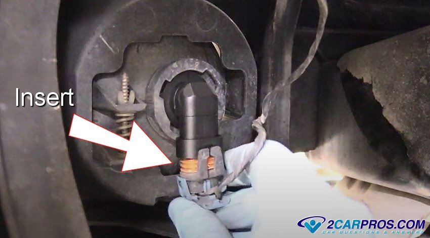

7. Make sure the electrical connector of free from dirt or grease, it helps to use a small amount of dielectric grease before re-inserting the connector to the bulb. Push the connector into the new bulb ensuring it clicks into place securely.
insert fog light electrical connector
