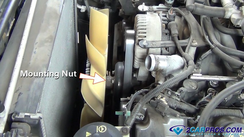

1. Identify the Nut Size

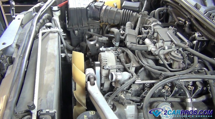

Each fan clutch will have its own mounting nut size which will range from 22mm to 36mm depending on the application and manufacturer. You can also use a large adjustable wrench if you do not have the proper tool. You may need to remove the fan shroud to get at the cooling fan.
fan clutch mounting nut

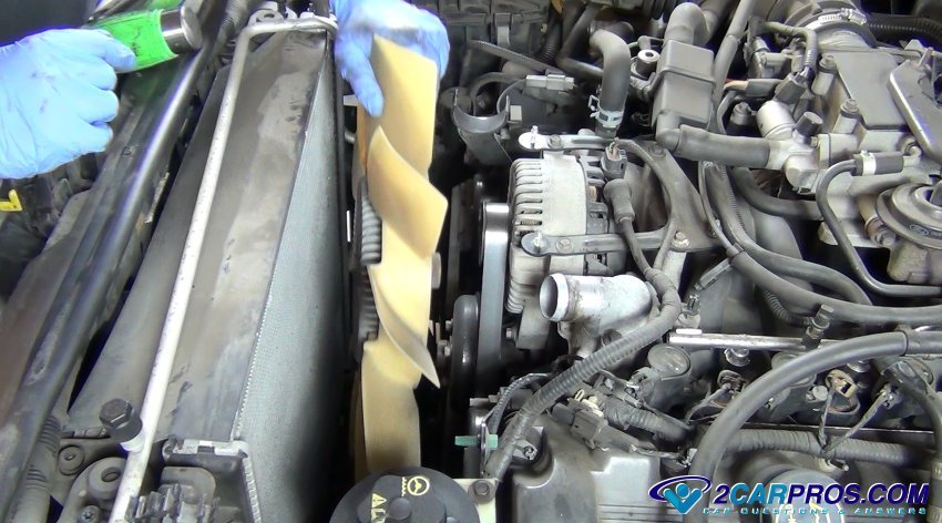

2. Hold the Water Pump Pulley
You must hold the water pump pulley in order to remove the fan clutch from the water pump. They make a special tool for this which you can get from Amazon for about $20.00 bucks or you can rent one for free from your local auto parts store. We loaned out our tool for this job and are waiting for its return so in the meantime we have this large pipe wrench which we were able to sneak onto the pulley to hold it for removal.

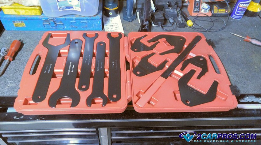

This is what the proper tool kit looks like to remove most fan clutches which cost about $80.00 on Amazon. You can get the one specifically for your car for about $20.00 from Amazon as well.
fan clutch removal tool set

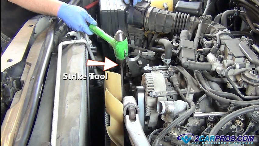

Next we installed a large crescent wrench onto the fan clutch nut. Then we hit it with a hammer to loosen the fan. If you are ever wondering which way to loosen the fan nut (some are reverse thread) it will always loosen in the same direction as the fan turns when the engine is running.
radiator fan removal

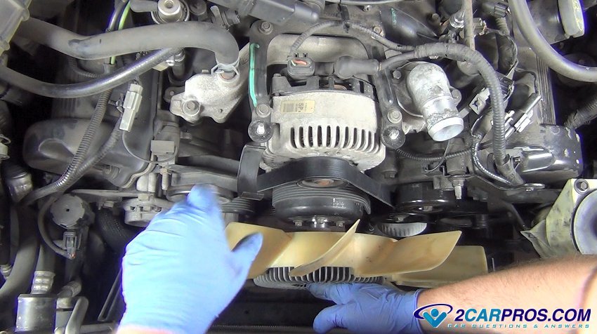

Once the fan is loose simply keep rotating the fan in the same direction while watching the threads to make sure the fan clutch in turning without the nut. If the nut is not turning use the wrench to help it along. Use your opposite hand to support the fan blade so it does not hit the radiator and cause a leak when the fan becomes loose. That would take the fun out of the job. The image below shows the two handed removal method.
support the fan clutch while removing

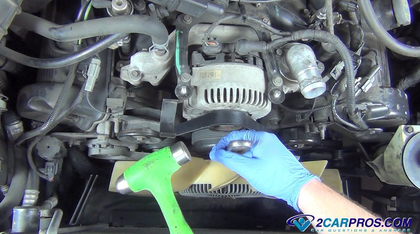

There will be four to six 10mm bolts that will hold the actual clutch part of the fan to the fan blade itself. Remove these nuts and the clutch will come free from the blade. Once you have matched up the old fan clutch to the new unit reassemble it by installing and tightening the nuts in a cross pattern.

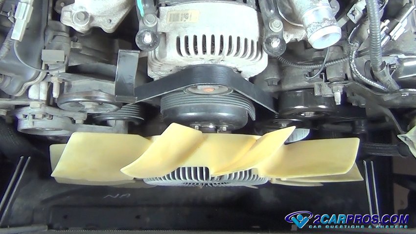

Once the new part has been installed gently slip the fan clutch down in front of the water pump using caution as to not contact the radiator or damage the plastic fan blade.
reinstall fan clutch
The threads on the water pump flange are large and can be cross threaded easily so we advise you to start the fan nut by hand before taking a wrench to it. This will eliminate any change of hurting the threads in which case the water pump would need to be replaced. Steady the fan by holding the center of the clutch while watching the threads to make sure you are square to the the water pump. Once threaded on insert the large wrench or tool to finish installing the fan clutch onto the threads and then and tap the fan to completely tighten it and you are all set.
tighten fan clutch
