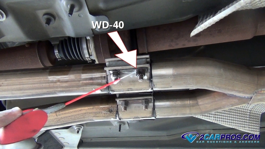

Apply WD40 to all mounting and manifold flange bolts to ease removal.
dw 40 exhaust system

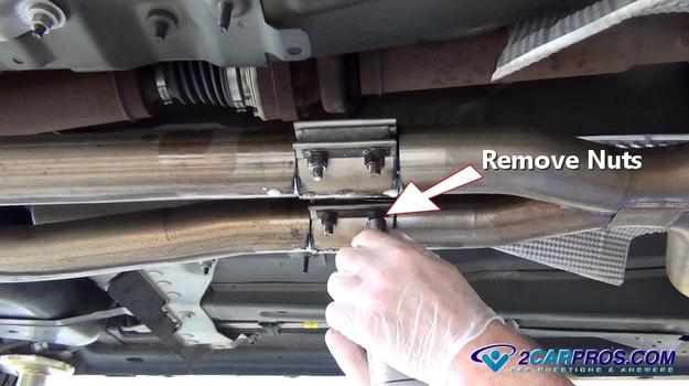

Remove tube connector nuts to start to disassemble.
remove exhaust system mounting nuts

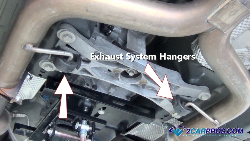

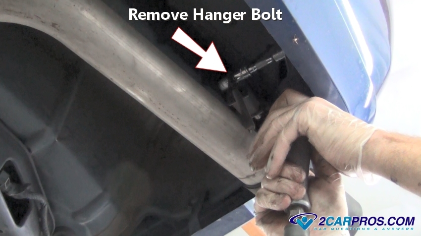

Remove rear exhaust system hanger bolts to allow more room.
remove exhaust hanger bolt

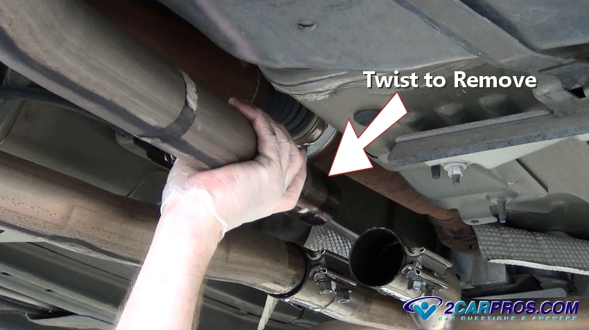

Twist and pull simultaneously to remove secondary tubes.
removing back half exhaust

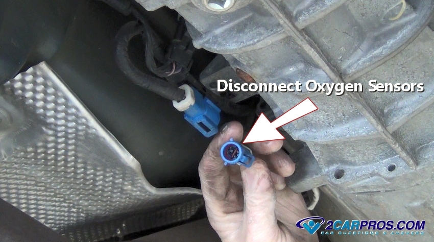

Locate and disconnect all oxygen sensors
disconnect oxygen sensors

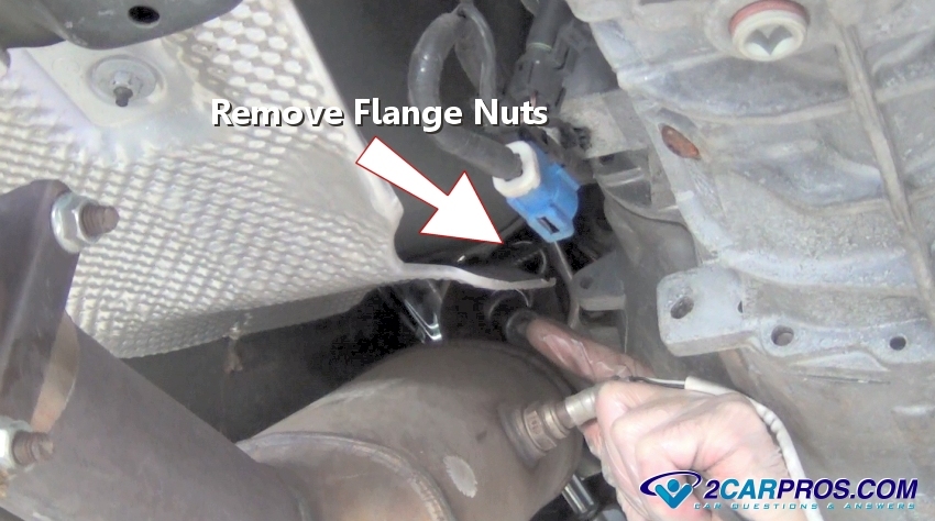

Locate and remove flange mounting nuts or bolts, the primary section of the system will become loose. The primary system will need to be pulled back away from the exhaust manifolds before complete removal.
remove exhaust flange nuts
Remove primary exhaust hangers.
exhaust system hangers

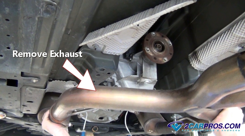

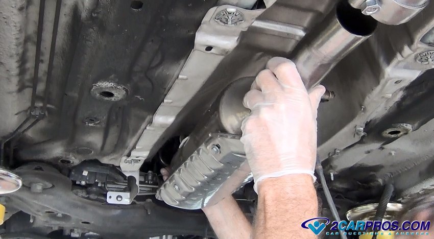

Firmly grasp the primary system and pull outward to remove.

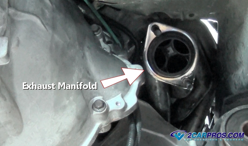

Inspect the exhaust manifold flange for damage. (Note: Some systems use a gasket to seal the head pipe to the flange.)
