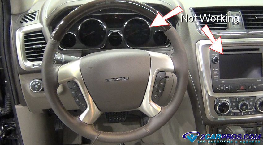

Everything electrical inside the car go out? Do you have lights on the dash that go dark when you try to start the car? This can be a simple problem of a bad connection at the battery terminals, in this guide will we show you how to fix this simple problem and get back on the road.

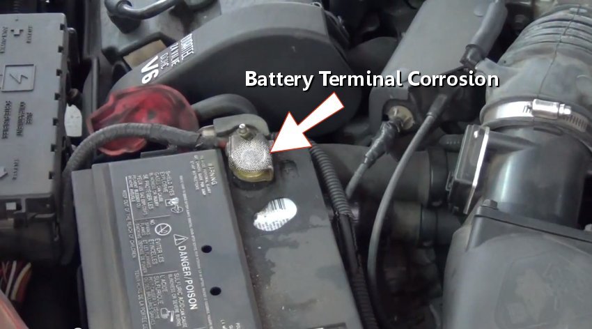

1. Check Battery Cables: Grasp the battery cable and try to wiggle them loose while inspecting the terminals for corrosion. In the image below corrosion is present causing the electrical to go dead. This problem is common for the positive battery terminal and cable.

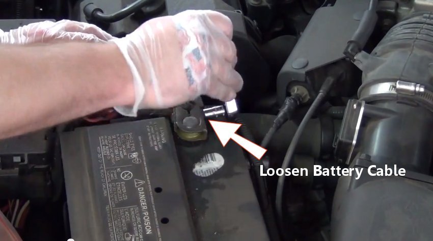

2. Remove Cable for Cleaning: With the ignition key, off use a 8mm or 10mm socket or wrench to loosen the cable by turning it counterclockwise.

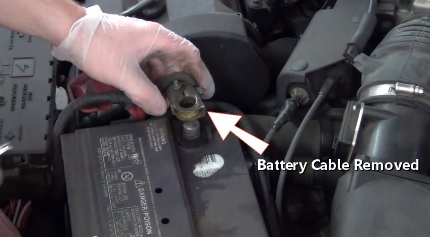

3. Twist and lift the cable end from the battery, there might be a small spark which is normal.

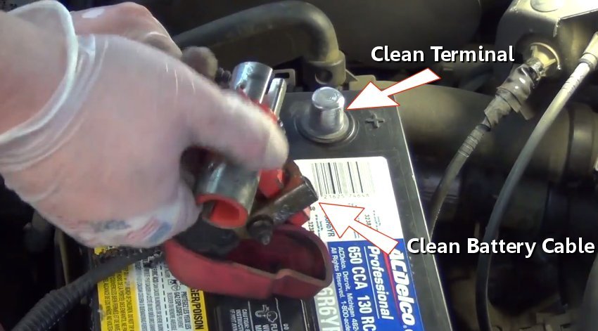

4. Use a wiring brush or a battery cleaning tool which you can get from Amazon for about $5.00 (US) and work it into the battery cable end to remove all corrosion. Also clean the adjacent battery terminal as well.

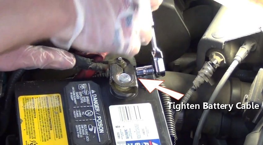

5. Reinstall the battery cable by pushing downward while tightening the nut. Do not over tighten the nut to avoid stripping.
tighten battery cable

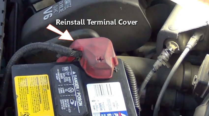

6. Once tightened grasp the cable end and check it for tightness to the battery terminal then reinstall the terminal cover and you are all set.
