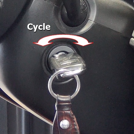

 The ignition switch controls the electrical system to the engine and vehicle, connections inside the switch can become overheated causing an electrical disconnect. Once the connection has cooled, cycle the switch from on and off many times without cranking the engine over. This can clean off the contacts and get the car running again.

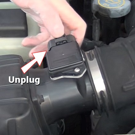

Most vehicles unitize a mass air flow sensor (MAF) which measures the air volume entering the engine. The problem occurs when the sensor starts to fail, this is because it will report 0 air flow to the engine computer, which in turn shuts down the fuel system causing the engine to stall. Simply unplug the sensor, this can get you going because the computer will now use a default value while turning the fuel back on to the engine, if this works replace the mass air sensor when you get home.

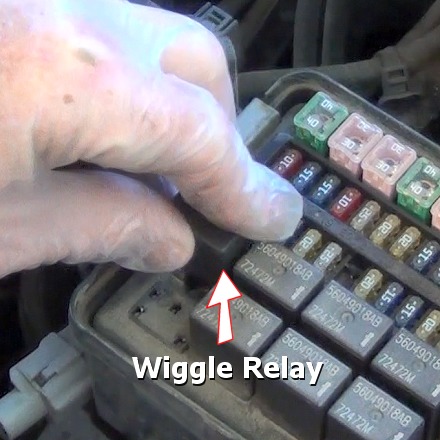

When a fuse or relay becomes warm it can disconnect the electrical supply to a vital circuit causing an engine stall. Many mechanics will employ the "wiggle test" to find such a condition, with the engine running (idle) wiggle all main fuses and relays to see if the engine stalls, if found remove the fuse or relay and look for signs of overheated or melted connections, then replace the fuse or relay and enhance and clean the electrical terminals to fix the problem.
