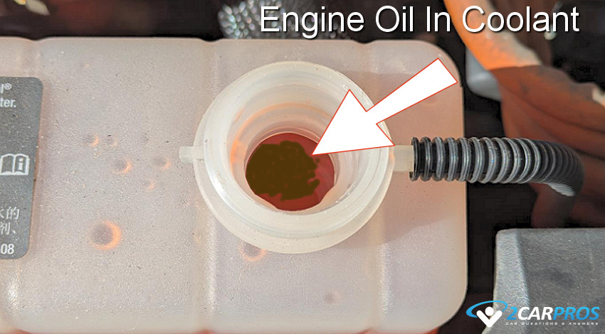

Finding engine oil in the radiator can be alarming, this is because the engine oil should never mix with the radiator coolant. You might have noticed this problem by simply checking the engine coolant level which will be above normal levels in some cases. This dark color is a sign there could be a serious problem inside the engine but not always, in this guide we will go over the causes of this issue.

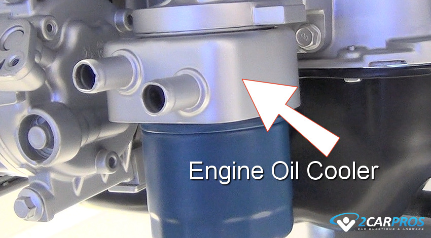

1. By far the most popular cause of oil inside the radiator or reservoir is engine oil cooler, which can be located inside the radiator or near the engine oil filter. Although this is difficult to check, it's worth the effort to replace the cooler. Engine oil pressure is higher than the cooling system pressure, which allows the oil transfer while the engine is running. Depending on the nature of the leak, coolant can flow back into the engine oil in some cases once the engine is shut off. Here you can see the coolant hose connections which is how the engine oil is circulated into the cooling system.
automotive engine oil cooler
