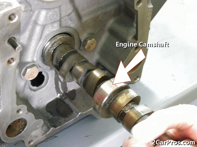

If a tapping or ticking noise is coming from the upper half of the engine remove the valve covers. This condition is sometimes accompanied by an engine misfire. Each valve utilizes a spring that returns it to its original closed position. If a valve spring has broken or a camshaft lobe is worn down it will cause the engine to create a tapping or clicking sound due to the excess clearance.
To test for this condition disable the ignition system or fuel pump by removing the system fuse. Have a helper crank the engine over while watching the rocker arms or cam lobes making sure all valves are traveling the same amount. If one or more lobes are traveling less than the others the engine has a flattened cam lob and the camshaft needs to be replaced or the hydraulic lifter/follower has collapsed and will also need to be replaced.
Look for broken springs using a flashlight and a small mirror. If a broken valve spring is discovered replacement is required to correct the problem. When checking valve springs compare the retainers in the closed position they should be exactly the same height. If one valve is higher or lower something is wrong with the cylinder head, valve or valve seat and removal is required.
engine camshaft
