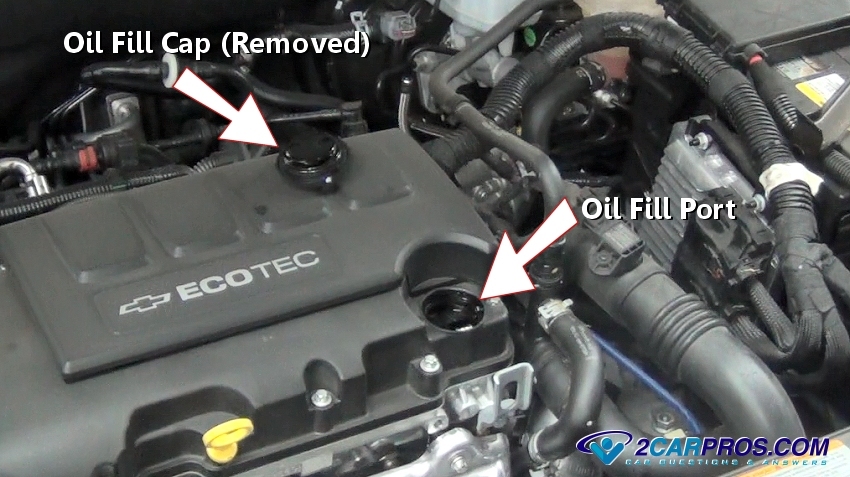

1. Oil Fill Cap Leak
The oil fill cap is used to add oil to the engine and is usually located on a valve cover. If this cap becomes loose or seal is broken or has failed to be reinstalled correctly after adding oil it will cause a leak. Check for leakage around the cap and tighten replace or reinstall the cap as needed.
oil fill cap removed

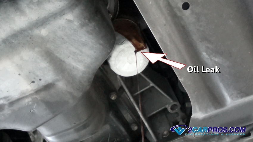

2. Oil Filter Leak
The oil filter is used to remove carbon and other impurities created by the combustion process. This filter is subject to oil pressure supplied by the oil pump and will leak if the filter is loose or the seal from the old oil filter is still on the block which can surface well after the oil change has been done. Use a flashlight check the oil filter for a leak and remove or tighten the filter and recheck. Wipe the area clean and recheck the leak after a short time.
oil filter leak

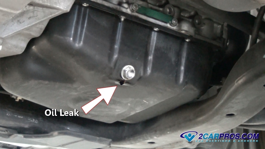

3. Oil Pan Drain Plug Leak
A drain plug is used to remove oil from the engine. This threaded plug uses a sealing washer which tightens flush against the oil pan and the plug. If the drain plug is loose or the sealing washer is missing or worn it can cause an oil leak. Check to see if oil is dripping from the plug and then check its tightness. If the drain plug is loose and will not tighten the threads on the drain plug are stripped and must be replaced or the oil pan repaired. It is common for a drain plug to be tight and still leaking due to a failed sealing washer. To replace the sealing washer will require draining the oil.
drain plug oil leak

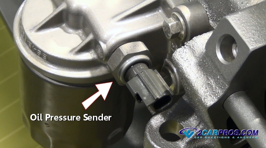

4. Oil Pressure Sensor Leak
The oil pressure sensor is used to send feedback data to the PCM (powertrain control module) and oil pressure gauge or light in the instrument cluster. This sensor is subject to oil pressure much like the oil filter and when failure occurs can leak. This sensor is typically located near the oil filter and will have a one or two wire connector.

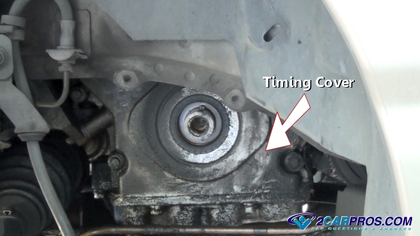

7. Timing Cover Gasket Leak
A timing cover is designed to control engine oil on timing chain style of engines. This cover is sealed to the engine block using a gasket which can leak due to age and heat. This kind of leak can be difficult to find so sometimes it's best to clean the engine first. This is because the cover is in close proximity to the front main seal. When replacing the timing cover gasket it is highly recommended to replace the front main seal as well.
timing cover

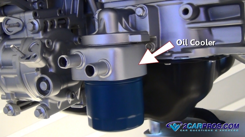

9. Oil Cooler Adapter Leak
Some engines are designed with an engine oil cooler or adapter that can leak due to seals going bad which stop oil from leaking between the block and the O ring seal. This seal or gasket will go bad due to heat and engine vibration which can cause an oil leak. Use a flashlight and look above the oil filter to confirm the leak which will run down over the oil filter and can fool you into thinking it is the oil filter that is leaking.
oil cooler

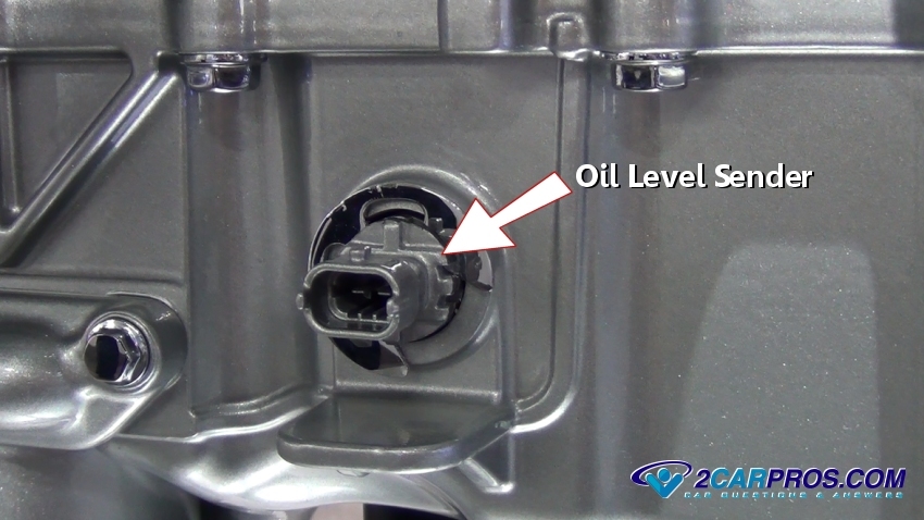

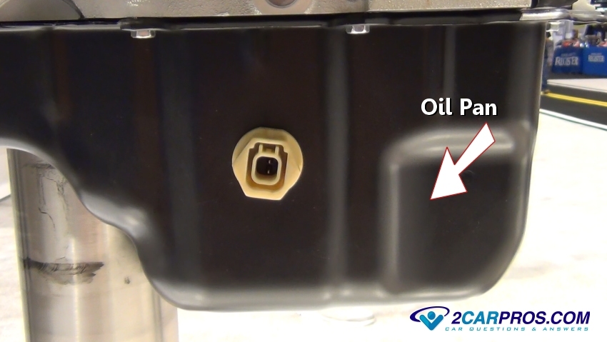

10. Oil Level Sender Leak
Some cars use a oil level sensor is used to provide feedback data for the PCM and illuminate a oil level warning light to tell the driver the engine oil level is low. This two wires sensor is located in the side of the oil pan and is submerged in motor oil. Mounted to the oil pan using an O ring seal this unit can become hard and leak in which case the oil must be drained and the O ring and sender replaced.
oil level sender
11. Oil Pan Leak
An oil pan is located at the bottom of the engine and is bolted to the block using many bolts and is sealed using a gasket. This oil pan is designed to collect oil into a centralized area allowing the oil pump to re-circulate it back into the engine. If the pan is damaged or if the gasket fails it can leak oil around the pan itself. In either case the oil pan must be removed and replaced if leaking along with the gasket. Depending on the car design this job can be difficult or quite easy.
oil pan
