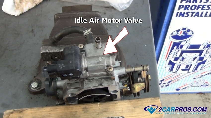

Step 2 - The idle air control motor (valve) is responsible for controlling the engine idle speed, if this part fails or becomes weak the engine idle speed could become erratic, additionally, this condition may or may not trigger the MIL (check engine, service engine soon light.) Because of the nature of this valve (large air volume processed) it should be serviced when a tune up is performed to remove "coking" which will hinder the valve's performance. To perform a rough check of the idle air control, remove the valve while reconnecting the wiring harness. While observing the valve with a flashlight, turn the key to the "ON" position, (DO NOT START ENGINE.) the valve should move slightly.
idle air control valve

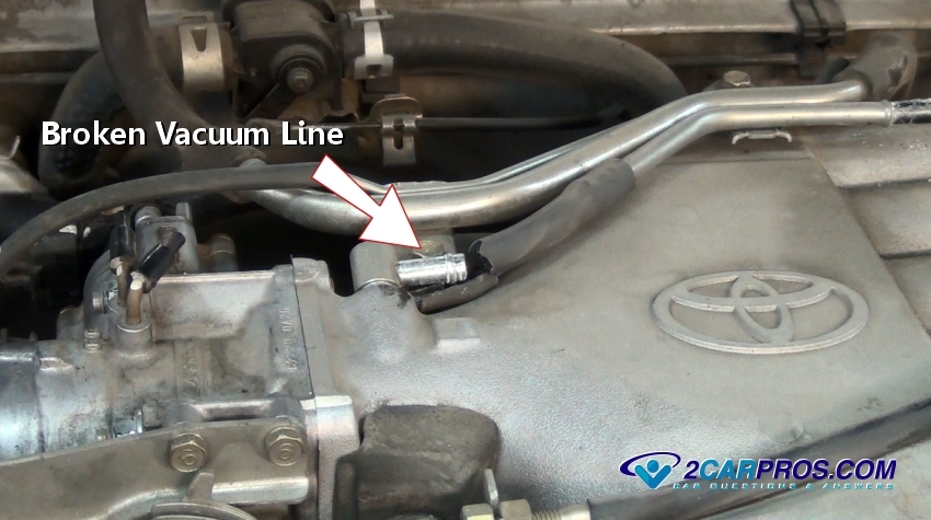

Step 3 - Engine vacuum is a sealed system and must hold a specific amount to maintain proper idle conditions, inspect the engine vacuum hoses and intake gaskets.
broken vacuum line

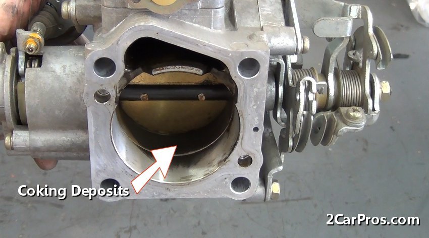

Step 5 - A throttle bore is used to regulate the volume of air flow the engine consumes. Controlled either by computer or by manual foot pedal this device must be clean and free from coking build up (light tar substance.)
coking deposits

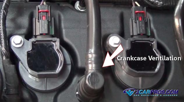

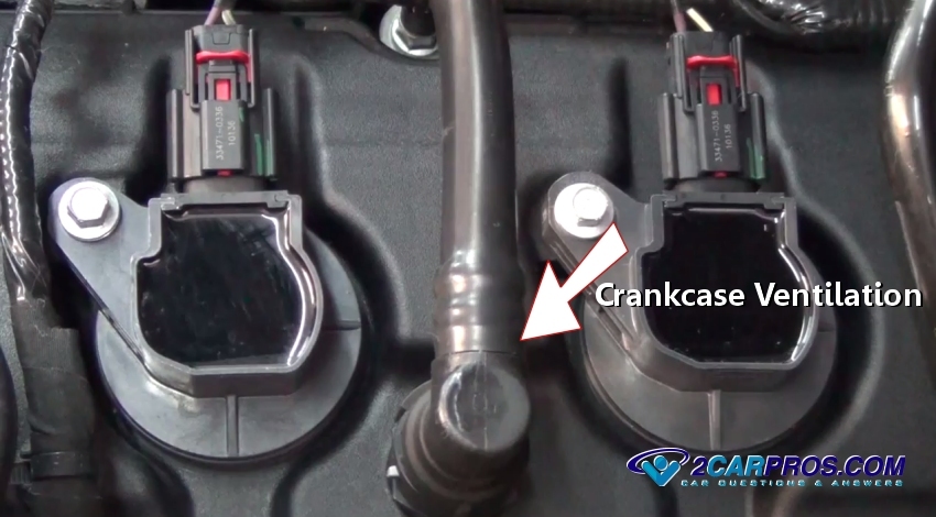

Step 6 - The crankcase ventilation system or PCV valve of an engine is used to scavenge vapors from inside the engine while running, if this system malfunctions erratic idle conditions may result.

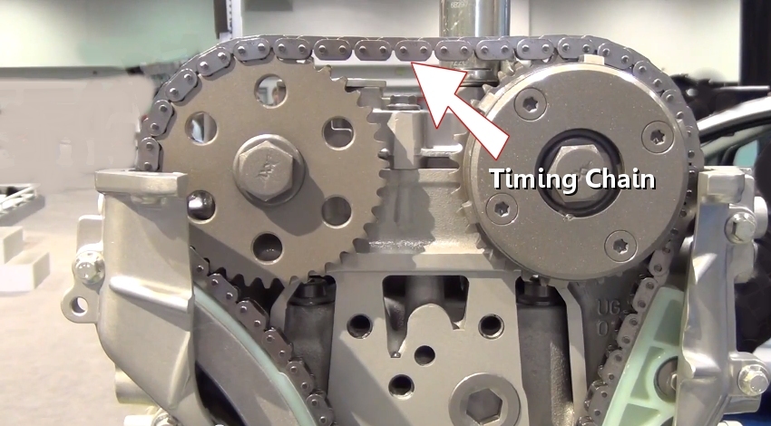

Step 7 - Engine timing, both ignition and camshaft orientation can effect the engine idle speed. When this condition exists the computer is rendered unbalanced and will not react correctly. These items must be checked and corrected before normal engine operation will resume.
timing chain

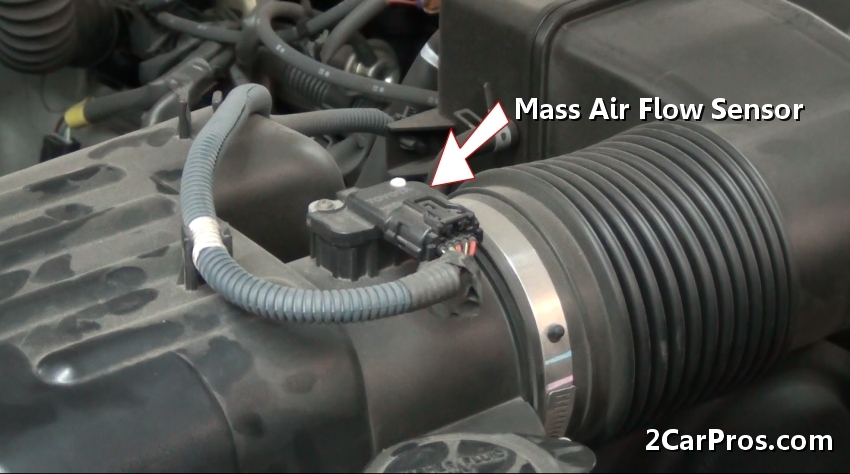

Step 8 - The mass air flow sensor uses a hot wire that changes in resistance as engine intake air is passed by it. The computer uses this information to make adjustments to the operating system. When this wire becomes contaminated which naturally occurs during usage, the sensor must be removed and cleaned.
