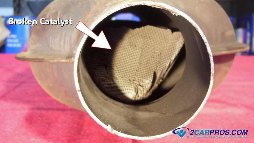

4. Plugged Catalytic Converter
In the exhaust system of most cars is a catalytic converter which is used to rid the exhaust of un-burnt fuel left over from the combustion process inside the engine. This un-spent fuel is a major cause of air pollution. Inside the catalytic converter is a catalyst material that resembles a honeycomb. When this material ages or is subjected to extreme heat from over usage it can crack and break apart clogging the exit port of the converter which in turn slows engine performance creating a low power condition.
broken catalyst
To test if the cat is plugged a temperature gauge can be used to measure the heat of ingoing and outgoing exhaust gases or the exhaust system can be temporarily disconnected to check the engine's power output.

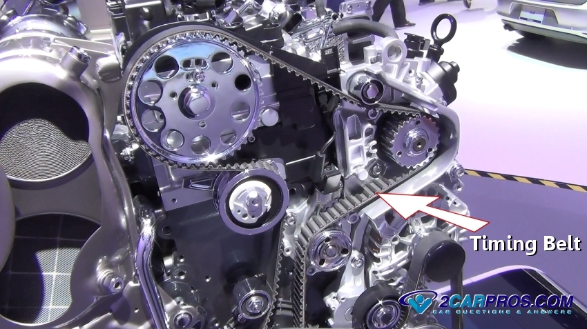

6. Jumped Timing Belt or Chain
A timing belt or chain is used to keep the engine's camshaft and crankshaft in correlation. As these parts wear they can become loose which will result in them jumping one or more teeth on the camshaft or crankshaft gear. When this happens the engine goes "out of time" but will still run with the result being low engine power. To check for this problem the engine front must be disassembled and the timing marks checked. When an engine goes out of time repairs must be made before resetting the engine back to normal.
