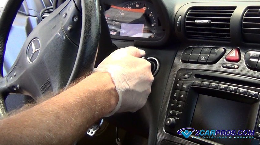

 Description: An engine should start up and run in about 2 to 3 seconds of turning the ignition key to the crank over position, if not you have a hard starting condition. This guide will help by starting with simple fixes and conclude with the more difficult.
