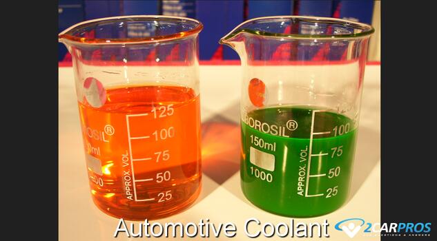

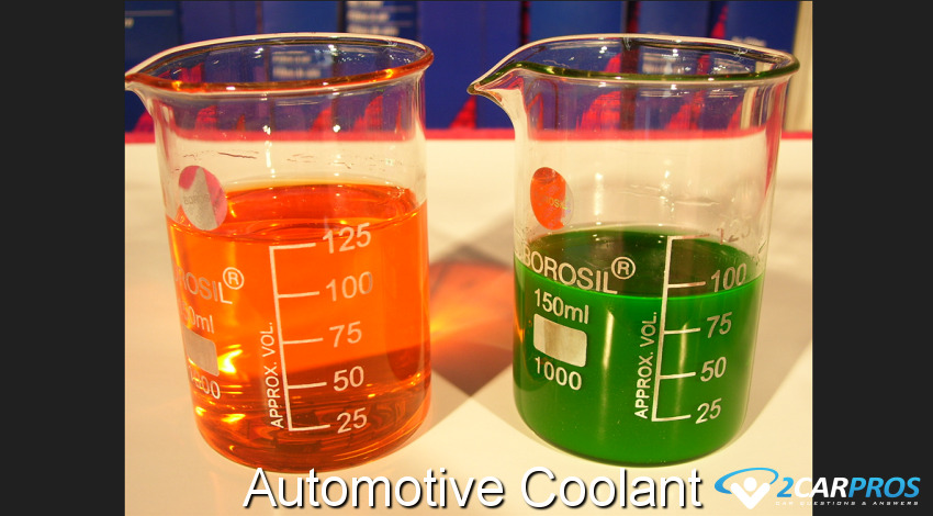

Introduction
A vehicles engine coolant (antifreeze) is one of the most essential fluid of your car no matter if the engine is gasoline, diesel or eclectically powered. This fluid is meant to remove heat from specific components while providing corrosion and freeze protection. Over the years car manufactures have developed different color coolants which represent various capabilities and performance characteristics.
These colors can signify the type of additives used, such as organic acid technology (OAT), inorganic additive technology (IAT), or hybrid organic acid technology (HOAT). Due to this situation their can be confusion on which coolant should be used which we go over in the following guide. Coolant color alone does not guarantee compatibility, refer to your vehicle’s owner manual before mixing or replacing coolant.
