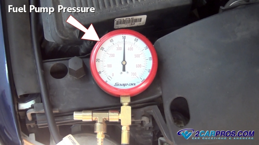

2. The #1 reason for an engine backfire through the intake manifold will happen under load or acceleration. The engine needs fuel to burn along with the air the engine is processing. Internal combustion engines run on a mixture of 14 to 1 which is fourteen parts air to one part fuel and when this is not correct (not enough fuel) the result will be a backfire. The most common cause for this problem is a weak fuel pump or clogged fuel filters which will cause a lack of fuel being delivered to the engine.
If you suspect this might be the problem test the fuel pump pressure which you can rent a gauge from the auto parts store for cheap. Also, if your car has a fuel filter change it out first.
fuel pressure gauge

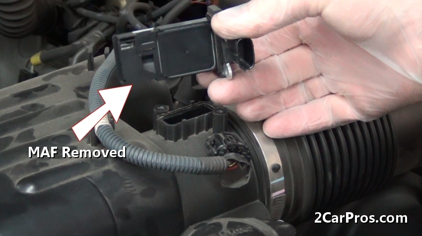

3. The #2 reason for an engine backfire is the MAF sensor that is muted due to the internal "hotwire" being contaminated. When this happens it will alter the reading to the computer which will create a lean mixture may not trigger a check engine light. This lean condition is because the computer thinks there is less air entering the engine than there actually is so it cuts down the fuel volume.
The first step is to remove the MAF sensor and clean it using carburetor cleaner, we have had better luck by replacing the sensor because once this condition happens the hot wire can become unresponsive in which case the sensor needs to be replaced.
mass air flow sensor removed

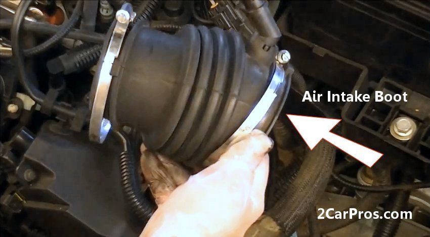

4. The air intake boot or tube, transfers air from the air filter to the mass air flow sensor into the throttle actuator and then into the engine intake manifold. If there is a problem with these parts such as a tear or rip it will allow un-metered air into the engine which the computer will see via the oxygen sensor and will try to richen the mixture but only to a certain extent, which may not be enough to compensate for the problem creating a lean condition. Remove the air intake tube or boot an check for tears or breaks in the integrity of the parts
air intake boot removed

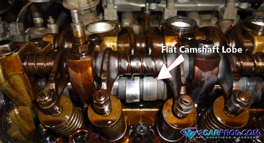

2. A camshaft is used to open the intake and exhaust valves of the combustion chamber to allow intake air in and the spent exhaust gases out. If the exhaust valve lobe becomes worn and loses its lift, the fire from the exhaust gases are still left inside the cylinder which is then released into the intake manifold once the intake valve reopens. To check for this condition you must first remove the valve cover(s).
After the valve covers have been removed, and with the ignition disabled (coils off) crank the engine over and observe the intake and exhaust valve operation, opening and closing. Also, if the intake or exhaust valves are not closing completely due to a broken valve spring it will allow the combustion gases to enter the intake manifold much like a flat camshaft lobe. Use a flashlight in carefully check the valve spring windings, these springs can break either at the top middle or bottom of the spring which can be sometimes be difficult to see.
A bent push rod can also cause the valve not to work properly by restricting the movement of the valve. While the valve cover is still removed look at each of the pushrods to see if there is an obvious bend to them. This also can be done by detecting poor rocker arm movement while the engine is being cranked over.
flat camshaft lobe

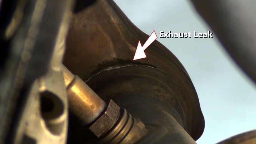

1. If fresh air is allowed to leak into the exhaust system it will ignite the unburnt fuel inside the system creating a popping noise. It is difficult to think of because most people think of a exhaust system to be under constant pressure but this is not true. The system is fed with a series of pressure and vacuum pulses which are created by the exhaust valve opening while the combustion charge being expelled into the system, and then the exhaust valve closing.
This is where the vacuum event is created by the pulse velocity and the fresh air let into the system. This is why you can get a lean mixture trouble code when there is an exhaust system leak. Inspect the system and repair any exhaust leaks present. This detection is done by looking for a flat back shoot which is evidence of a leak.
exhaust leak
