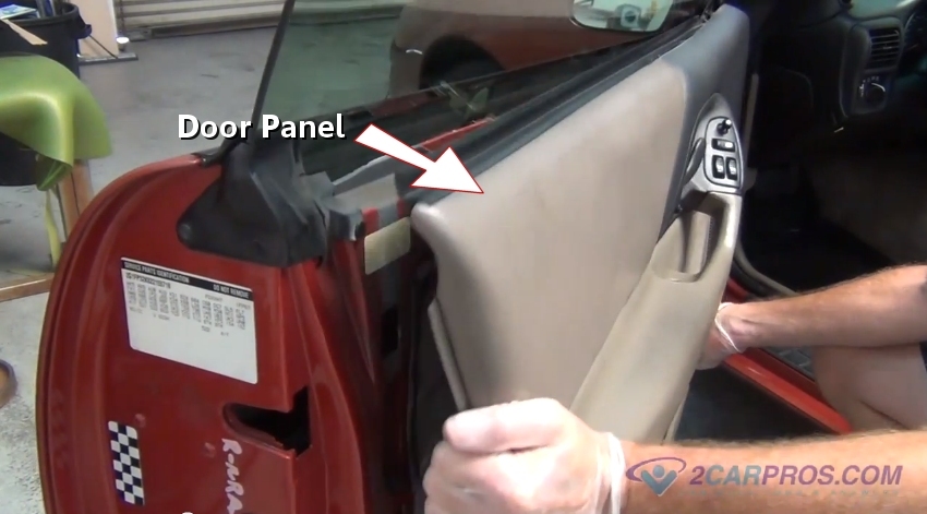

In this example the door panel will need to be removed to access the switch. To tell which type you have, look for a mounting screw near the switch bezel or try to gently pry up on the switch to see if it gives way and pops out, if not the door panel will need to be removed.
door panel

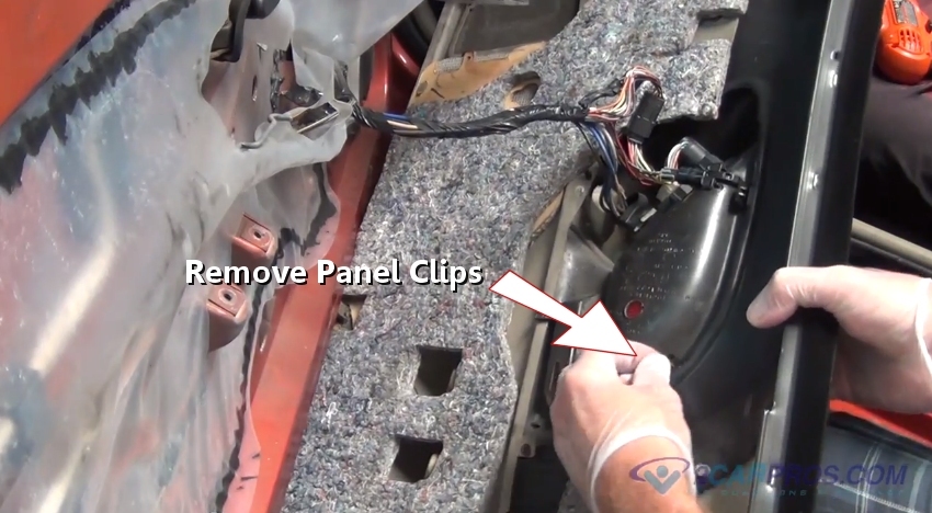

At the rear of the door panel disconnect the wiring harness from the switch or undo the switch bezel mount screws or clips to access the rear of the switch. Then reattach the wiring harness so testing can begin.
remove panel clips

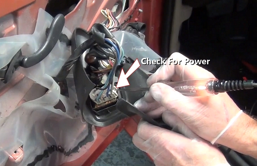

With the ignition key on, use a test light to probe the switch terminals or wiring connectors, one of them should have power. This test shows the window system is powered up and a fuse or relay is not the problem, (test light on). If power is not found, check the fuses in the fuse panel.

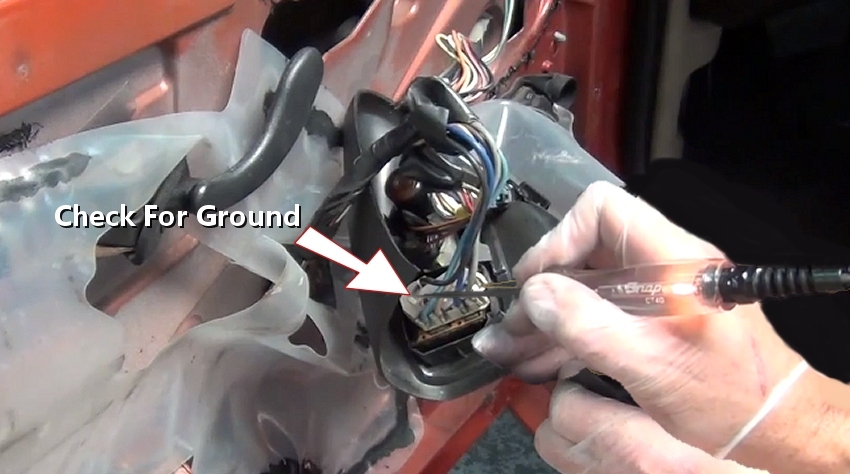

Next, connect the test light lead to power with an extender wire to the positive battery terminal and test the remaining terminals for ground, this wire is usually black or brown. One should light up, if not inspect the wiring and harness for damage and use a wiring schematic to trace the ground circuit and repair. It is common for the wiring to break near the door jam where the wiring harness goes from the door to the vehicle.

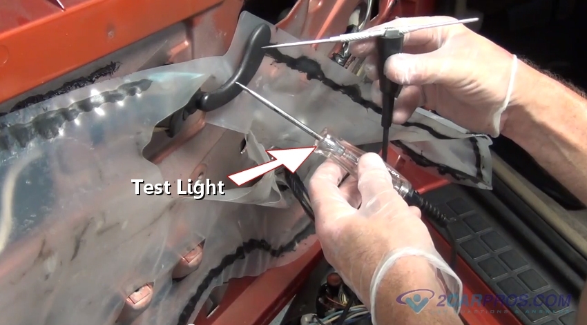

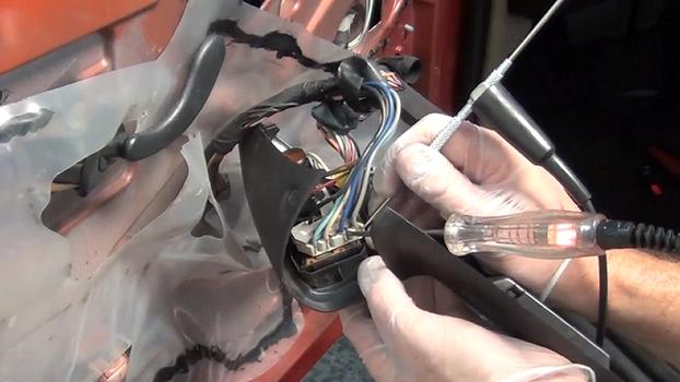

Insert a sharp metal object such as this scribe into the ground clip of the test light, this will be used to test the switches internal circuitry.
test light ground curciut probe
Using the circuit tester, insert both probe ends into the individual window activation terminals. Working the switch back and forth the test light should illuminate in both directions, this determines if the internal switch connections are working. Do not allow the probes to touch together during the test. If no illumination is detected in one or both directions the master switch has failed. You have just tested the electrical portion of the system much like a trained mechanic would have.

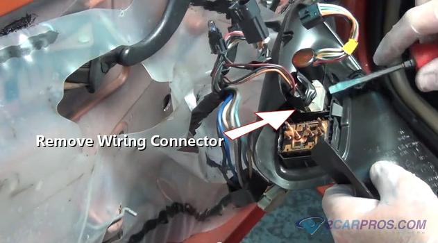

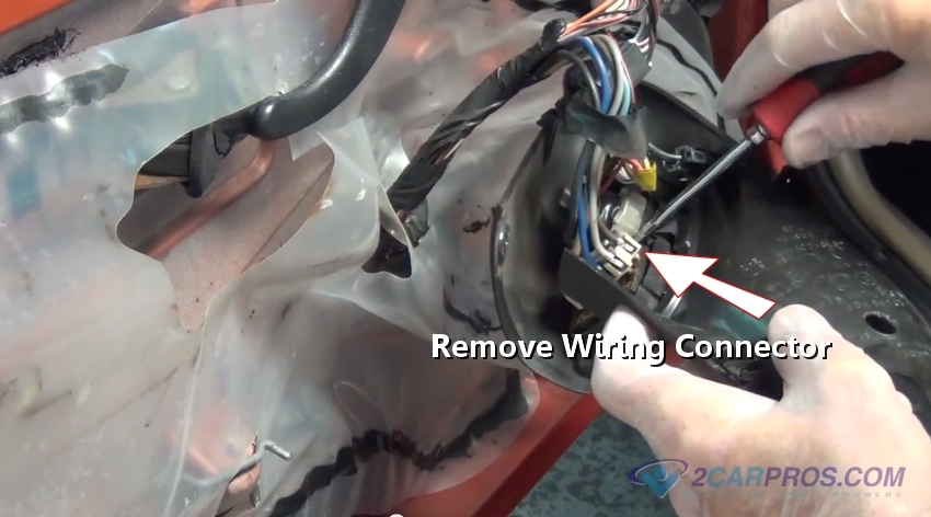

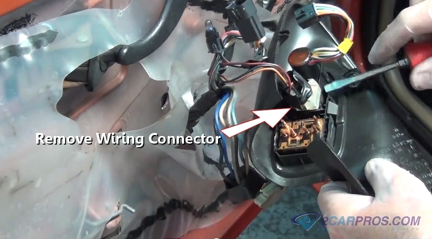

Turn the ignition key off and remove the wiring connector from the switch. Some master window switches are designed with a wiring harness connector attached.
remove wiring connector

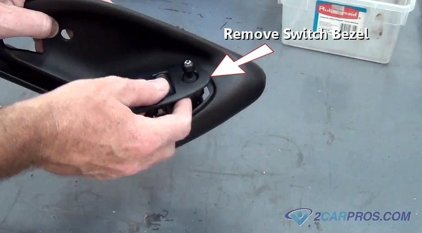

Remove the window switch plate by releasing the mounting clips which hold the bezel in place.
remove switch bezel

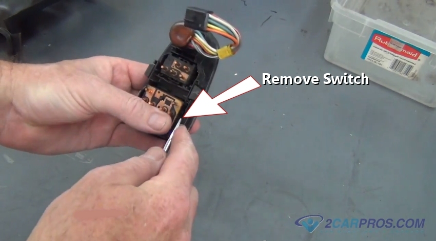

Use a small screwdriver to release the mounting clips to separate the window switch from the bezel, on some switches the bezel is included with the new switch.
remove window switch

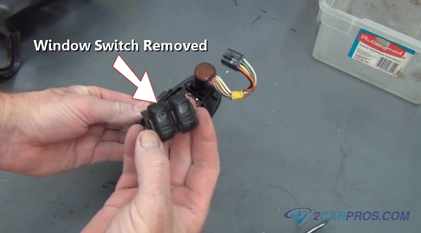

The switch will become free from the bezel.
window switch removed

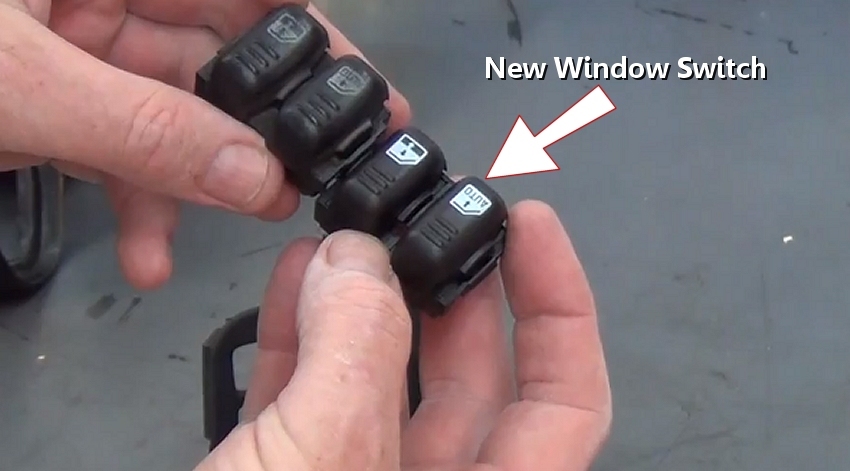

Remove the replacement window switch from the packaging and compare it to the failed switch.
new window switch

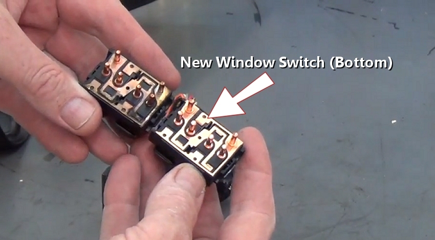

Flip the switches over to compare the electrical side terminals, they should match identically.
new switch bottom

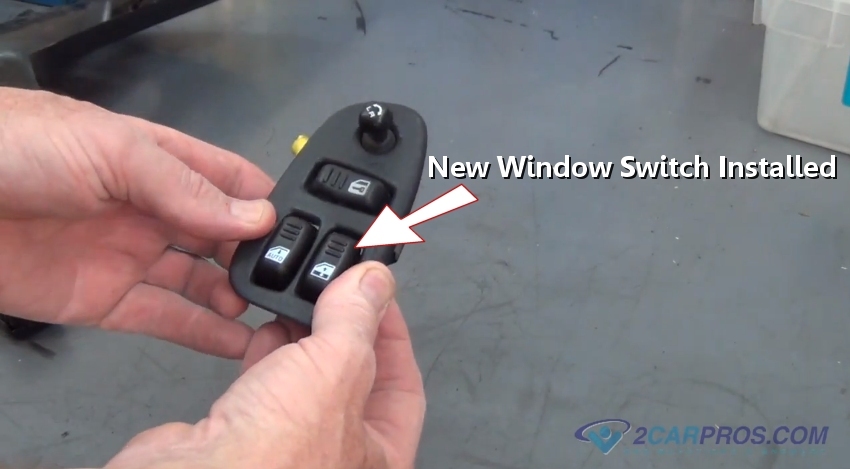

Press the replacement switch into the bezel which will be accompanied by a click, some switches are held in place by mounting screws.
new switch installed

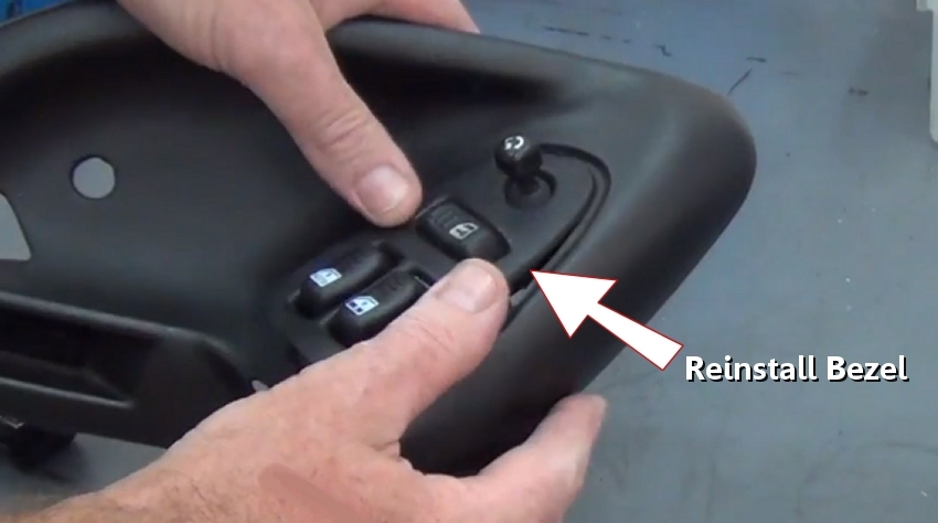

After the new switch has been installed, reinsert the bezel plate into the plastic cover plate and reassemble and you are all set.
reinstall bezel

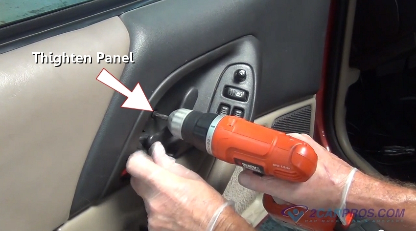

Continue the reassembly until completed, test the job by activating the window and checking the operation of all windows.
tighten door panel screw
