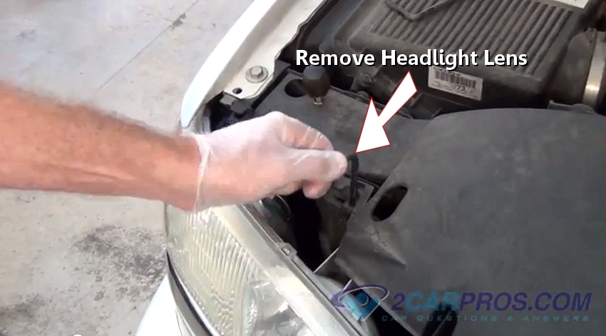

Locate the mounting pins or screws to remove the lens or inspect behind the lens to see if you can get to the bulbs without removing it. Each car is different and if you cant figure out how to get to the bulbs then a online repair manual is needed or you can check on Google images. In the example below the lens is held in by pins which are easily removed. This upper lens must be removed before removing the lower DRL lens.
remove headlight lens

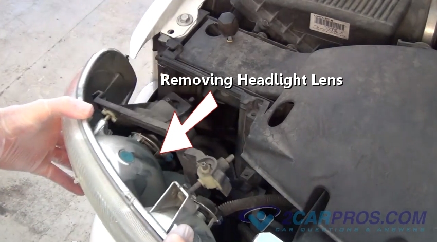

After the retainers or screws have been removed grasp the lens and gently remove it from the lens mounts. There will be wires attached so be careful not to damage them.
removing lens

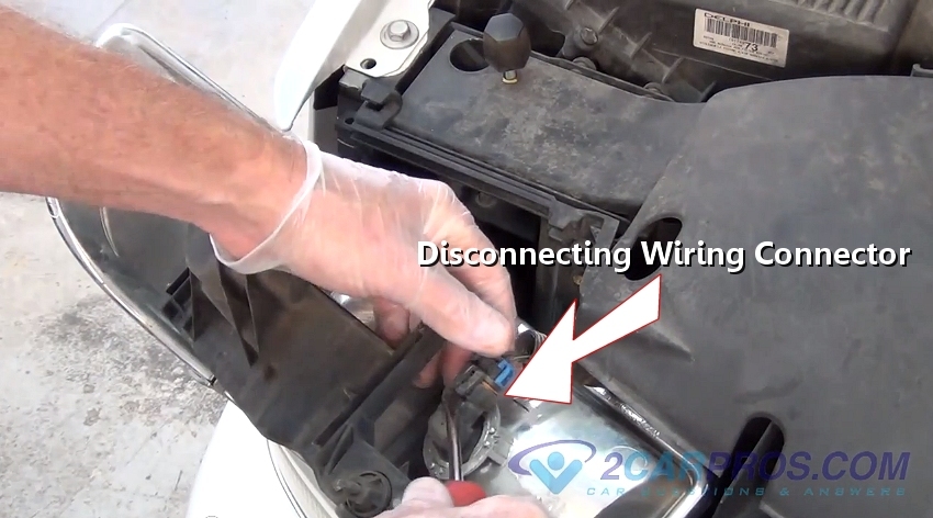

Use a small screwdriver or pick to release the wiring connectors by releasing the safety clips and pulling them gently outward. These connectors can be a little stuck because of the weather packing seal which is meant to keep water out of the connections.
diconnecting wiring connector

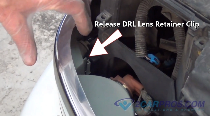

Once the upper lens has been removed locate and release the retainer clip or screws to the DRL lens.
release drl lens retainer clip

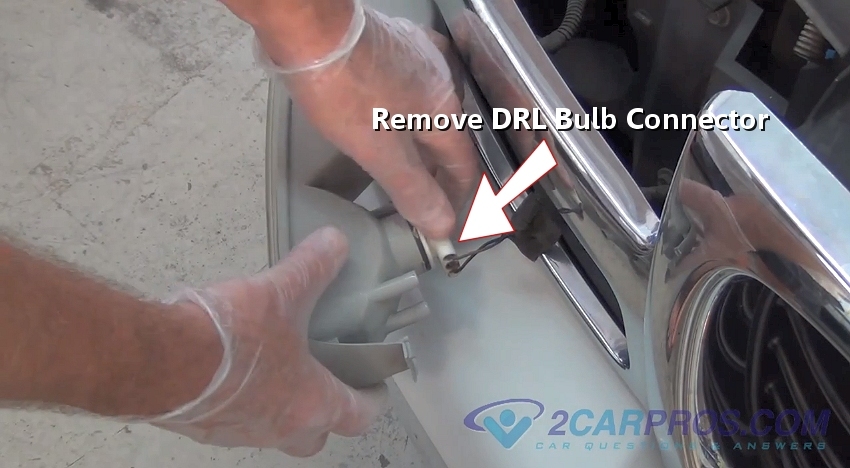

5. Remove DRL Bulb

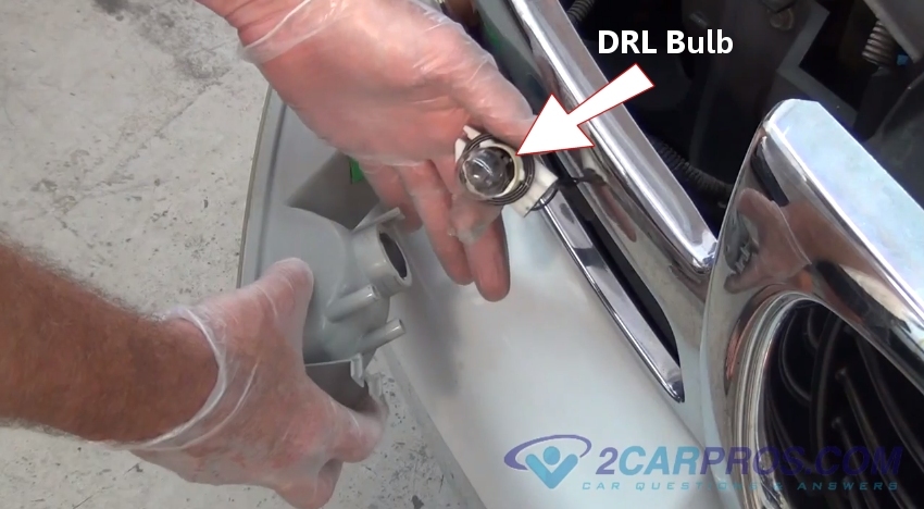

Grasp the DRL light bulb socket and gently turn it counterclockwise to remove the bulb socket. This can be done by removing a clip as well which will depend on the design.
remove drl bulb socket
Once the socket is removed the DRL bulb will be exposed.
drl bulb

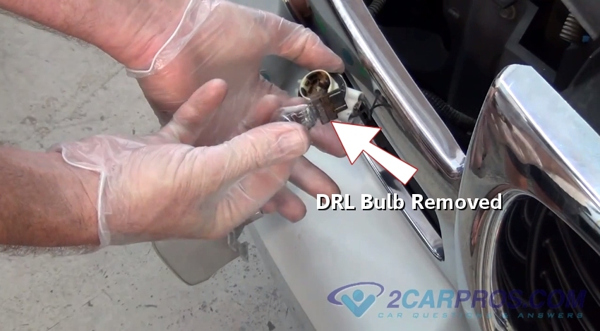

Gently grasp the bulb and firmly pull the bulb from the socket. The bulb is held in by pressure clips and they will release with a little pressure. Some bulbs you must push downward and turn counterclockwise to remove.
drl bulb removed

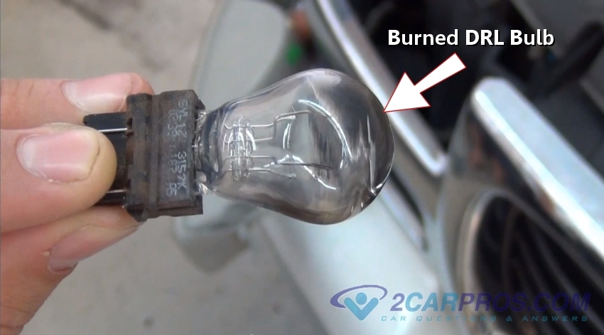

Examine the burned DRL bulb to confirm the failure. Match the new bulb to the old unit to ensure a proper installation. In the example below you can see a grey mark at the top of the bulb letting you know the bulb is burned out.
burned drl bulb

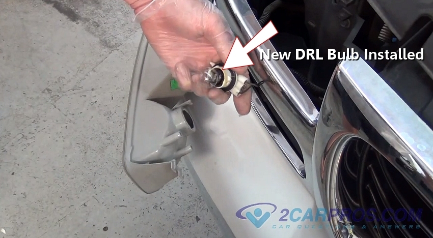

Gently push the new DRL bulb into the socket by pushing downward. The bulb can be installed either way so don't worry about installing it upside down.
new drl bulb installed

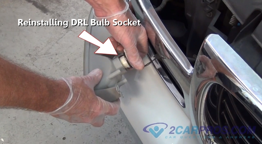

Insert the socket into the lens housing and turn clockwise to tighten. You will feel a distinctive click signaling the completion of the installation.
reinstalling drl bulb socket

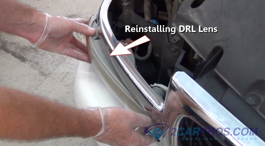

Reinsert the DRL lens back into its holder and secure the retainer clips or screws.
reinstalling drl lens

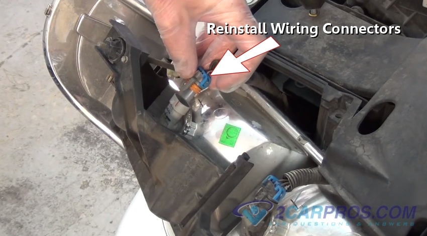

Once the DRL lens is in place reconnect the wiring connectors to the upper lens and reinstall into its mounts.
reinstall wiring connectors

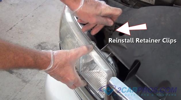

Reinsert the retainer clips or screws and start the engine to activate the DRL bulbs to ensure their proper operation and you are all set.
installing headlight retainer clips
