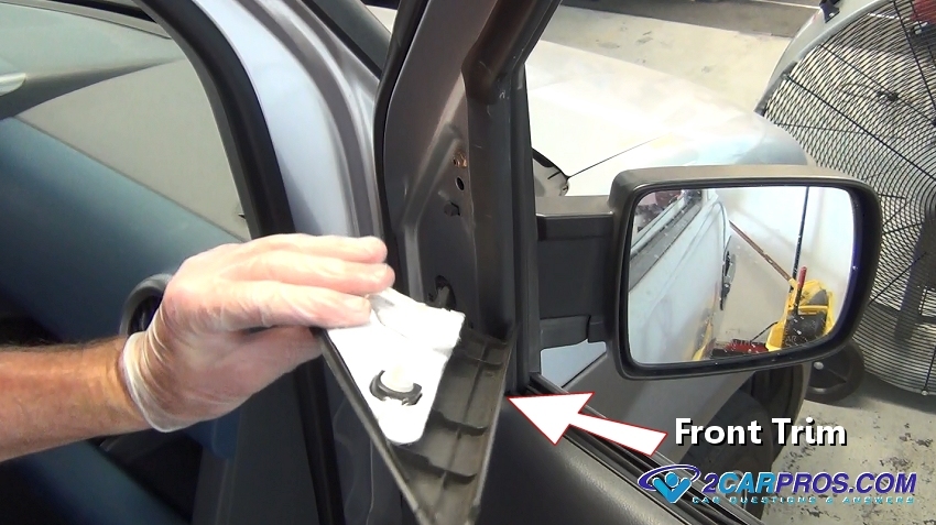

1. Remove Small Trim Pieces

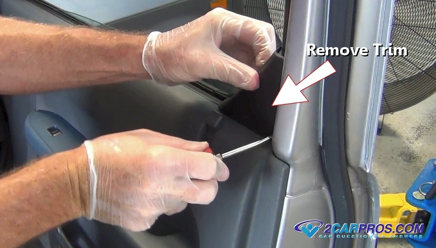

Most door panels will have small trim pieces located at the top of the panel at either the right or left side. Use a small screw driver or trim removal tool and detach (pop off) any trim pieces above the door panel.
remove trim
Here is an upper trim piece to the left of the panel. These pieces must be removed before removing the panel.
front trim

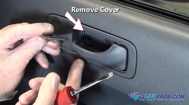

There could be a series of plastic fascia pieces that need to be removed which house the inner door handle, arm rest or window switch. Look for hidden plastic covers which will need to be removed to access the hidden screws.
remove cover

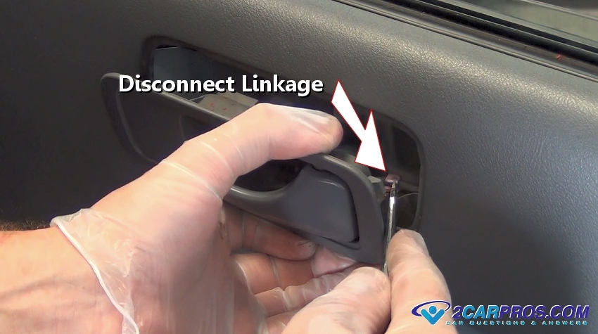

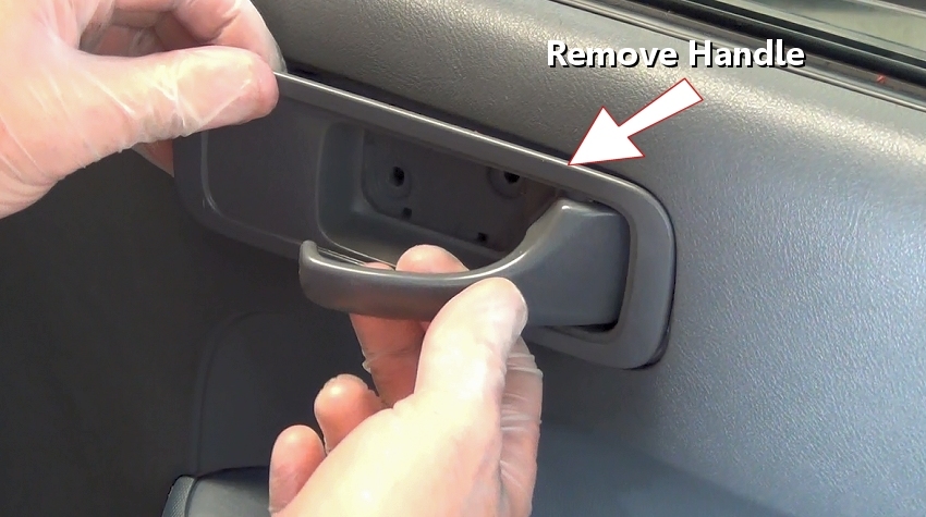

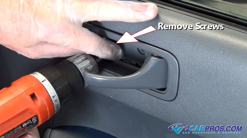

Remove any screws holding the inner door handle. Grasp the handle and remove it by pulling upward. Be cautious of the linkage attached to the handle as not to bend or break it.
remove door handle
Use a small screwdriver to push the plastic clip over the linkage and release it from the handle.
disconnect door handle linkage

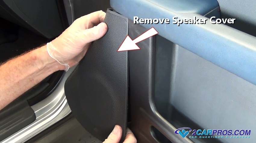

4. Remove Door Speaker
Some car door panels are equipped with a speaker which will need to be removed before the panel can be taken off in some cases. Grasp the speaker cover and gently pull outward to unclip the cover to access the speaker screws.
remove speaker cover

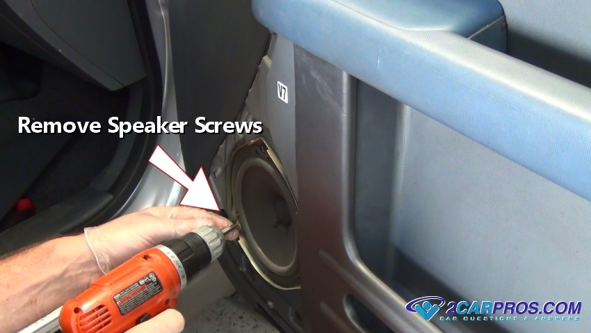

Remove speaker mounting screws to remove the speaker. Be careful not to puncher the speaker cone with the tool.
remove speaker screws

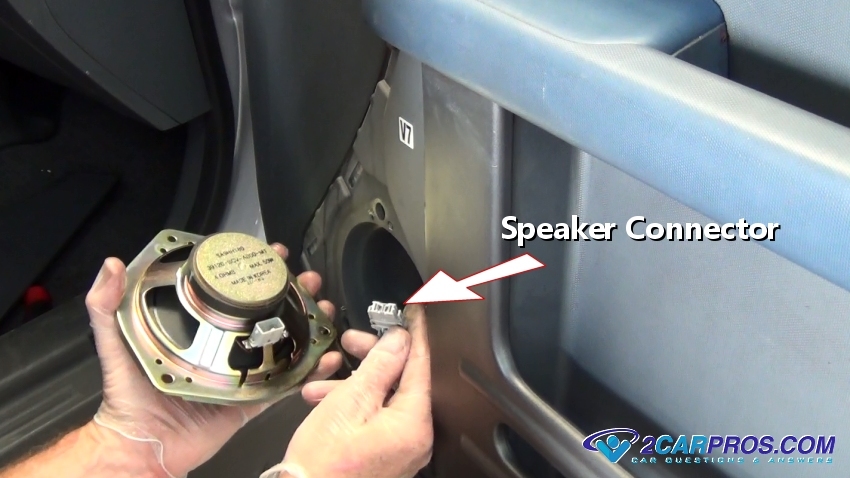

Once the speaker is loose disconnect the wire harness connector by releasing the wiring connector safety clips.
disconnect speaker wiring connector

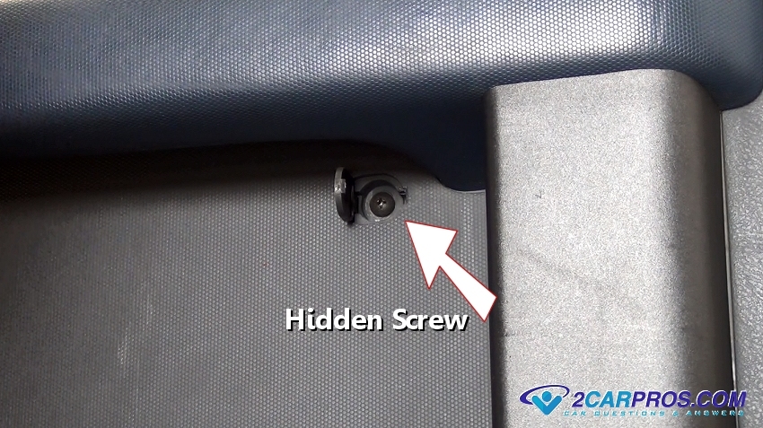

Check that all mounting hardware and small hidden doors have been opened. Some screws can be well hidden as in the image below.
hidden screw door panel

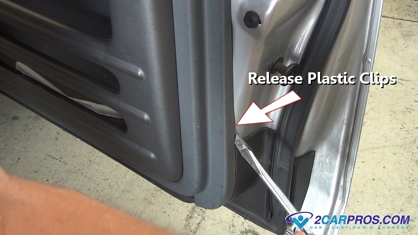

Use a screwdriver or door panel removal tool and wedge it in-between the panel and the door. This will release (pop) the plastic clips holding the panel to the door. Follow this action around the bottom of the door until completely released.
release door panel clips

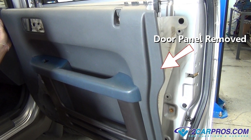

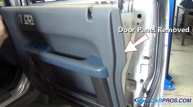

Once all mounting screws or bolts and plastic mounting clips have been released or removed lift up on the door panel to release it from the window sill. Hold it in place as wiring may still be attached at the rear of the panel.
remove door panel

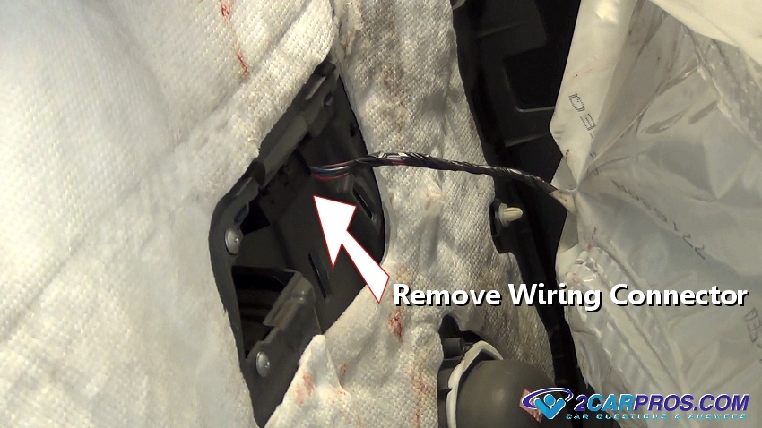

6. Disconnect Window Switch Wiring
Locate the wiring connector to any accessories such as a window switch or light. Some window switches can be removed before the panel removal.
remove wiring connector window switch

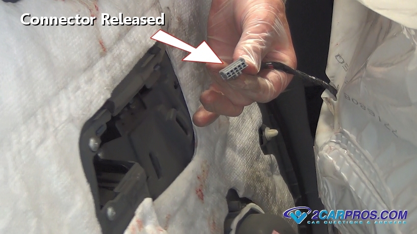

Release the window switch electrical connector by pushing downward on the safety release clip.
window switch connector released
7. Finish Removing the Door Panel
Once the electrical connector has been released the door panel will become free from the door. Remove it and gently place it away from the work area to keep it free from dirt and grease.
door panel removed

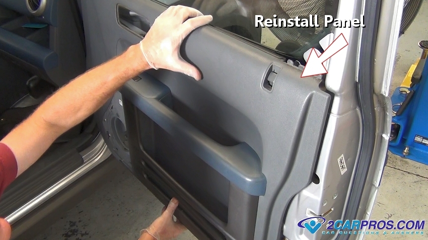

8. Door Panel Reinstallation

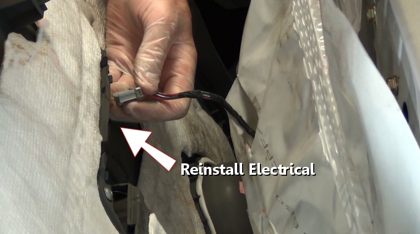

After repairs have been made and the door panel is ready to be reinstalled grasp the door panel and hold in position while reconnecting the window and door light electrical connectors.
reinstall window switch connector
Make sure the latch control rods are safely in place and hook the door panel into the window sill and push down to secure.
reinstall door panel

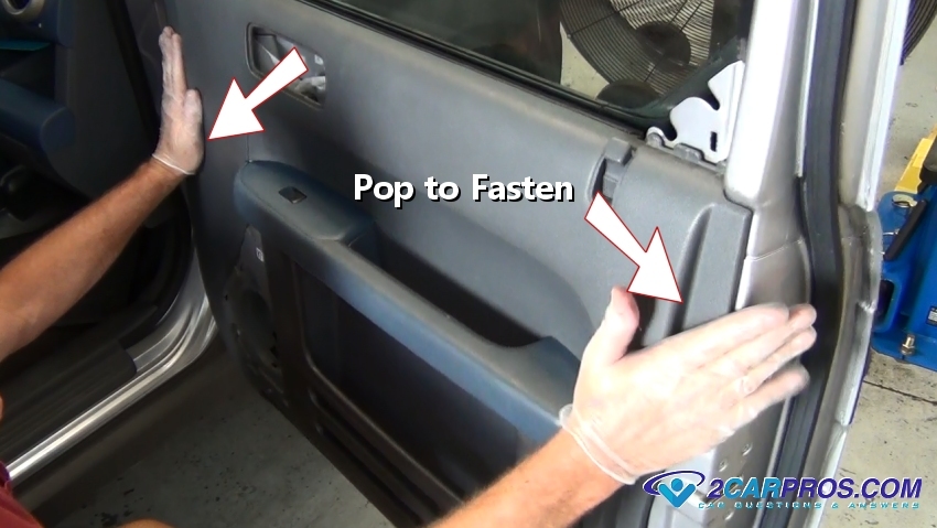

Once the door panel is secured at the window sill pop the plastic clips back into place. Physical alignment of the clips into their respective holes maybe needed.
pop door panel into place

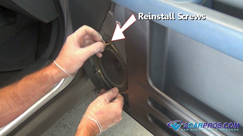

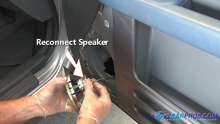

9. Reinstall Speaker
Hold the speaker while reconnecting the electrical connector and then set the speaker back into place.
reconnect speaker wiring
Reinsert and tighten speaker mounting bolts and reinstall the cover.
reinstall speaker screws

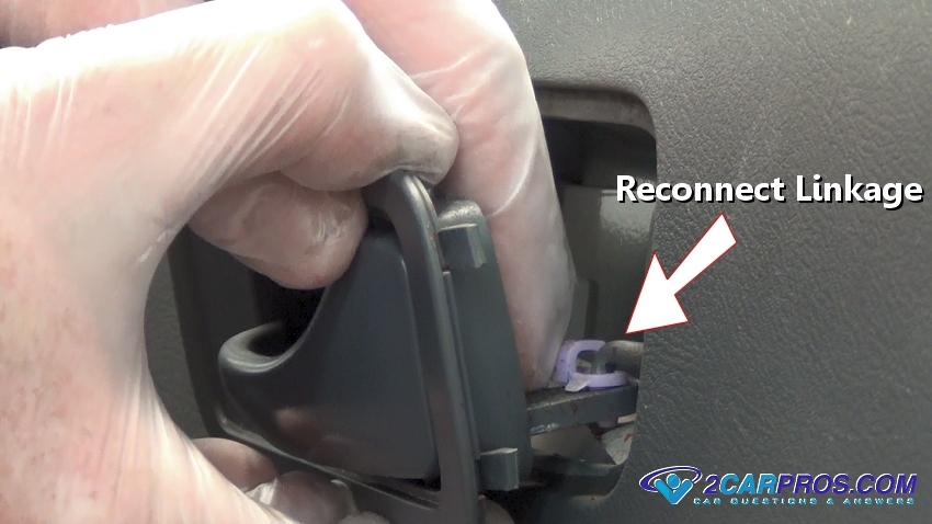

While holding the door handle reattach the door handle linkage by popping the plastic clip over the control rod.
reconnect door handle linkage

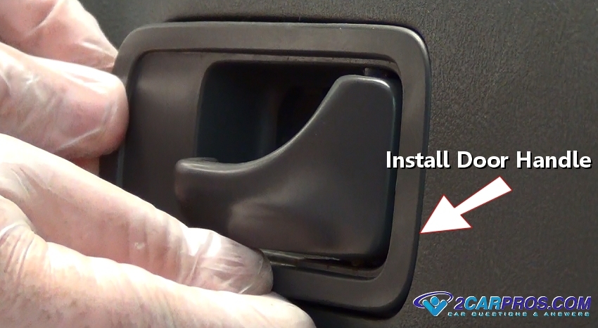

Snap the door handle back into place while ensuring the linkage can move freely.
install door handle

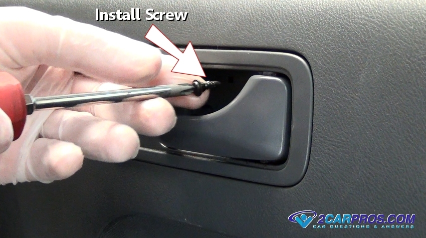

Reinstall and tighten the handle mounting screws.
install door handle screw

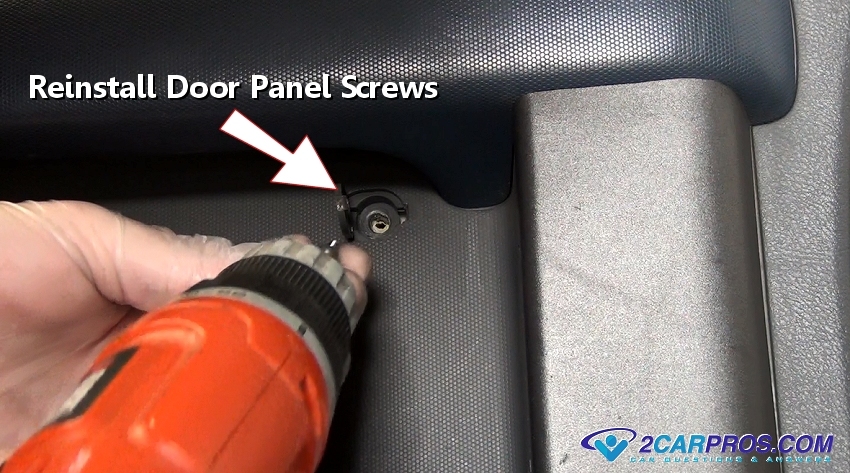

11. Reinstall Door Panel Mounting Screws
Reinstall all door panel screws or bolts and recover them with the small hidden plastic panels or doors.
reinstall door panel screws

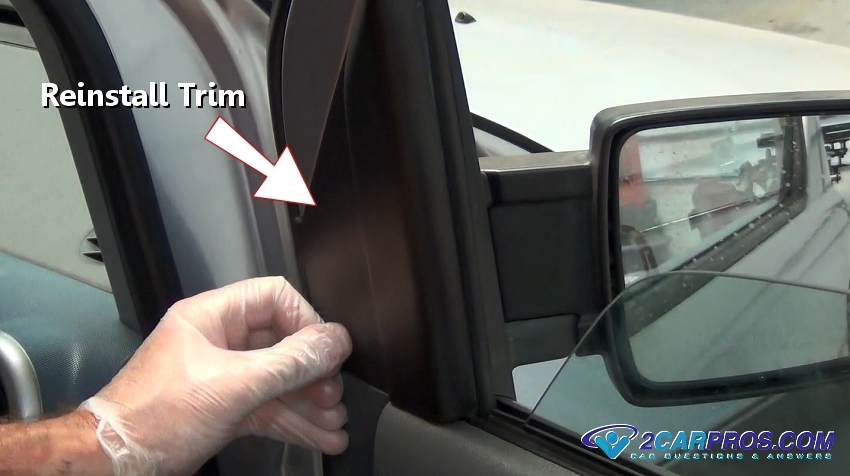

12. Reinstall Trim Pieces
Once the door panel is properly secured reinstall the front and rear trim pieces and you are all set. Be sure the watch the video of the job being down below this image.
reinstall front trim
