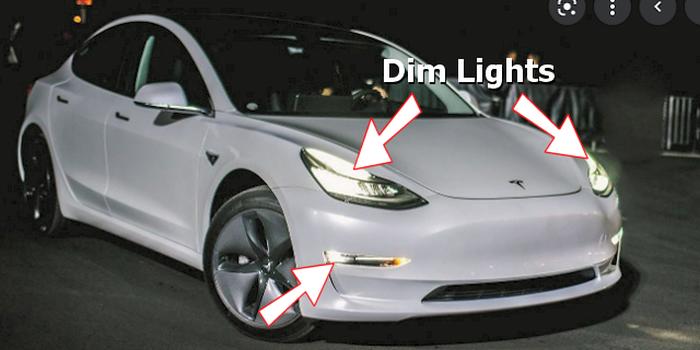

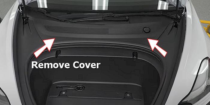

Dim exterior and interior lights are a sign that the smaller 12 volt battery is having a problem, in other words the output voltage of the 12 volt battery is too low, hence the dim lights. Open the front compartment, you will see two plastic covers, the uppermost cover simply pops off using clips. We have removed the lower cover by undoing the four 10mm bolts, then it pops off and out as well (simple).
remvoe under front hood cover

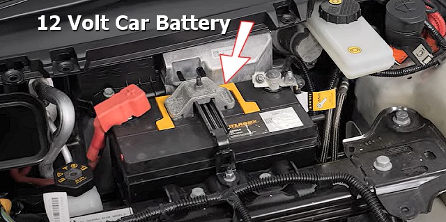

Here you can see under the covers, there is a radiator which is used to cool the battery packs, an electric air conditioner compressor, water pump and front drive motor. You may have also noticed the 12 volt regular car battery, this is what needs to be replaced.
12 volt car battery

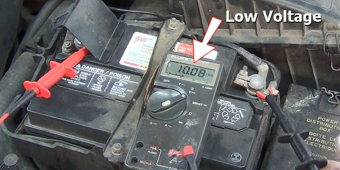

To confirm the failure, let's use a voltmeter to check the surface voltage. Here you can see the voltage is well below the 12.4 volts which is normal. Here you have confirmed the dead battery that needs to be replaced.
low battery voltage
