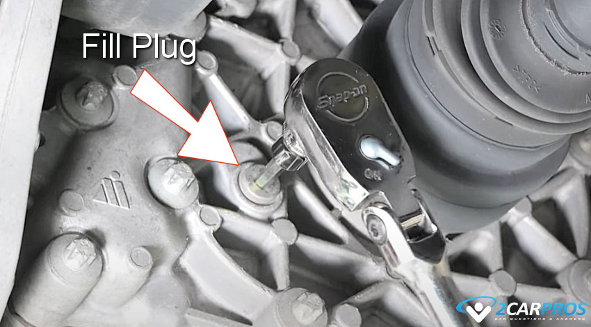

1. Locate Oil Fill Plug
The oil fill plug is usually located on the front part of the differential near the pinion gear flange, on the rear cover, or on the side of the case. It is a good idea to spray WD40 on the plug threads and allow it to sit, then use an appropriate tool to remove the fill port plug.
remove differential fill plug
2. Check the Gear Oil Level
Using a small wire or your little finger insert it downward into the hole to feel for the fluid, once removed the fluid should be present, and if not the fluid level is low, if the level correct will be just below the level of the plug hole, (If gear oil drips out, it is full and you can reinsert and tighten the plug).

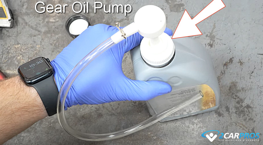

3. Prepare Gear Oil
Gear oil usually is purchased in quarts, its a good idea to purchase an inexpensive pump to make the job easier like in the image below. Use the correct type of gear oil specified in your vehicle’s manual.

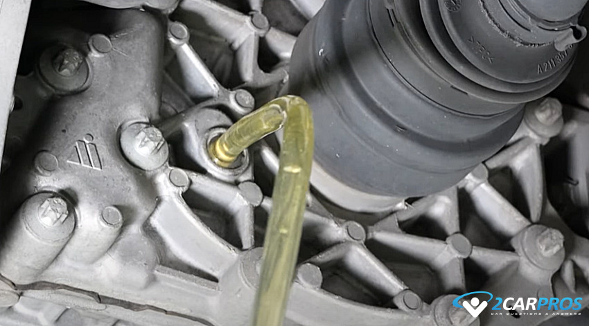

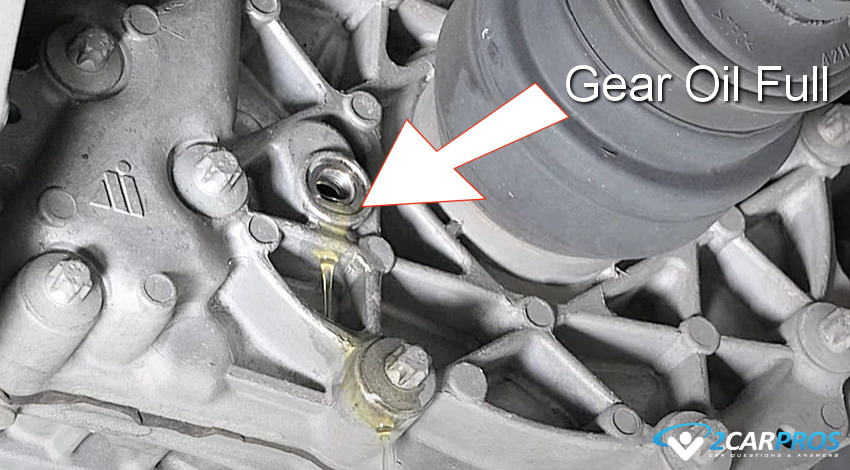

4. Add Gear Oil
Insert the tube into the fill port and continue adding fluid until it spills out from the service port. This is what it will look like once you have enough gear oil inside the differential, reinsert the fill plug by hand to avoid cross threading, finish by tightening the plug. Clean the excess gear oil from differential using a shop towel.
