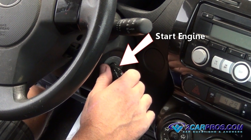

Step 1 - Start the engine and allow to warm up to operating temperature, then turn the engine "OFF".
start engine
Start Engine

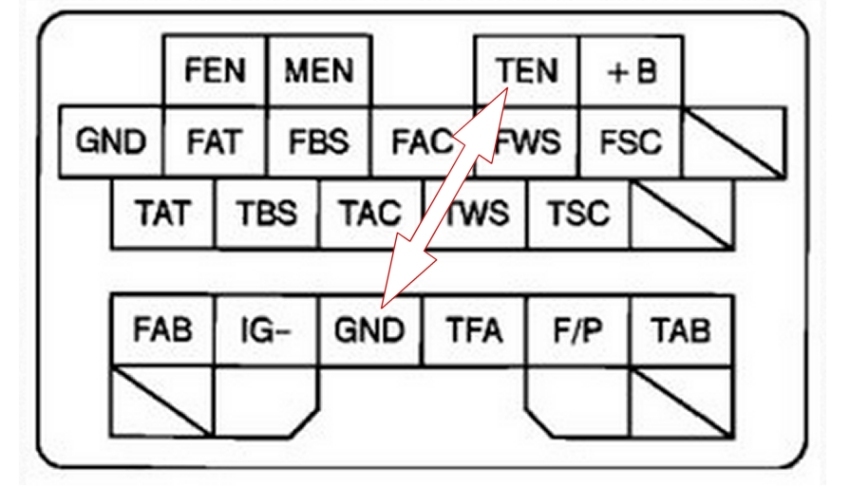

Step 2 - Next, install a jumper wire from the TEN terminal to the GND terminal, located either under the dash or hood depending on model.
gen1 mazda connector
ALDL Connector

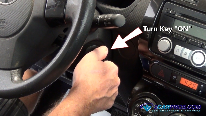

Step 3 - After the jumper wire has been installed, turn the ignition key to the "ON" position.
turn key on
Turn Ignition Key "ON"

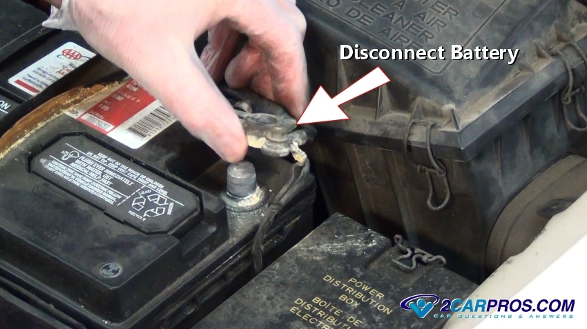

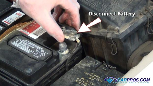

Step 5 - To clear trouble codes after repairs have been made, disconnect the negative battery cable, then reconnect after two minutes.
disconnect battery
Disconnect Negative Battery Cable
