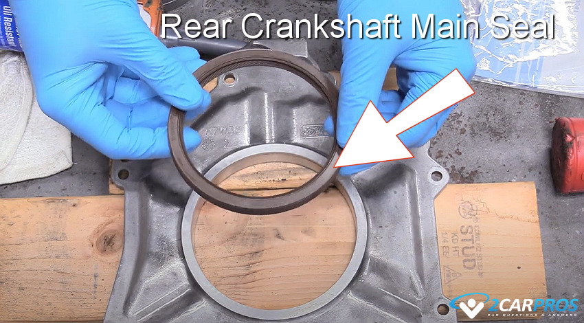

Usually the seal will come off with the housing, but sometimes they can get stuck on the crankshaft. There might be a protective layer over the seal called a "slinger" or "retainer" which is designed to keep the seal from moving while in operation, this will need to be removed before the seal. The seal retainer plate will need to be cleaned or replaced before it can be reinstalled. Without scoring the seal housing, gently pry the seal and retainer until its removed. Use a gasket scraper and carburetor cleaner remove the old gasket material, oil and grime from the seal housing.
5. New Rear Main Seal Installation

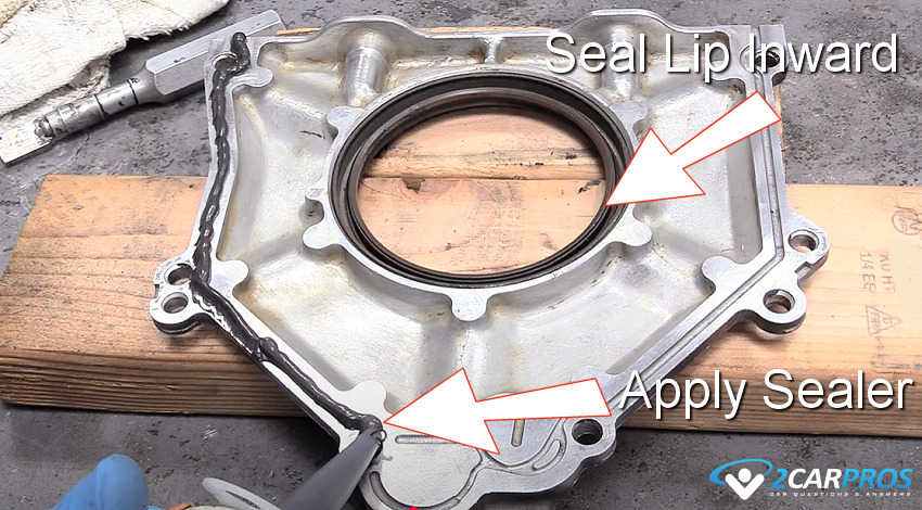

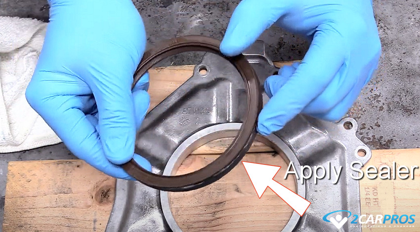

Match the new rear main seal to the old seal, they should match identically in size. Some rear main seals can be redesigned from the factory and might be slightly different in appearance, but should still have the same inner and outer diameters. Apply a thin layer of gasket sealer to the outer ring of the seal
apply sealer rear crankshaft main seal

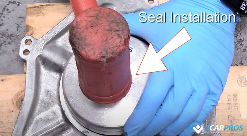

This part is important: The direction the rear main seal is installed will mean the difference between the seal working or leaking, the lip of the seal must go toward the engine. Using a flat piece of mild steel, wood or seal installer gently but evenly hammer the seal into place. You don't want to have the seal go in at an angle because this will distort the seal and may cause it not to work correctly.
automotive engine crankshaft rear main seal installation
The seal will be completely installed when it is flush in the seal housing plate. Check the installation by running your finger around the seal feeling for evenness against the housing.
