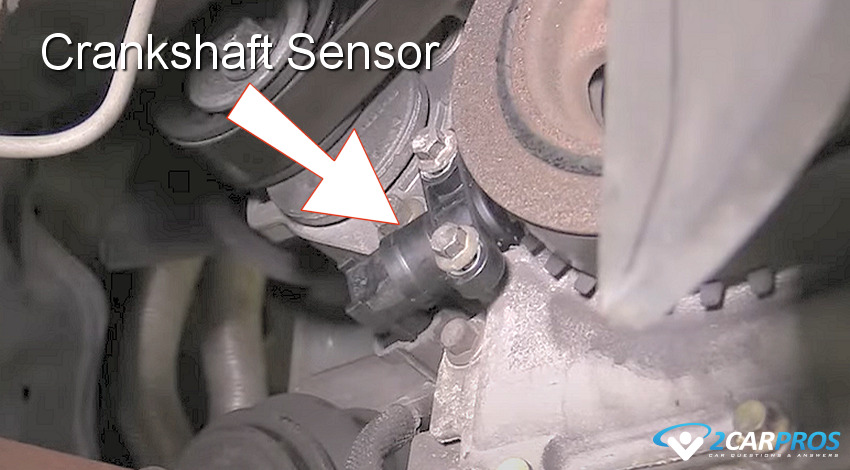

Location:
There is no "one place" a crankshaft position sensor is located because each manufacture has their own idea of where it should be on any particular engine. The sensor can be in an obvious location such as on the side of the engine block, or at the harmonic balancer, but it can be as difficult as being at the timing belt drive pulley inside the timing cover. If you are unsure of the sensor location, our experts are happy to help.

4. Crankshaft Sensor Removal
Most crankshaft sensors will have just one mount bolt which will typically be 10mm in wrench size. Use a small wrench or socket to remove the bolt by turning it counterclockwise and place to the side for safe keeping. Use a small pick or standard screwdriver to wedge under the sensor mounting tab to pry it loose.
Bock Mounted Sensors Only:
Removing the crank sensor can be a little difficult because they get stuck. Be careful not to apply to much pressure because these sensors have a long stem and have been known to break off leaving a part of the sensor inside the block. When this happens sometimes you will have the option of pushing the broken piece inward so it falls into the oil pan where it will stay, or you can remove the oil pan to remove the broken piece. Once the sensor is loose, firmly grasp it and with a twisting motion pull it from the engine block.
