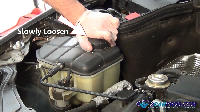

Locate and slowly remove the cooling system pressure cap to relieve the system of any residual pressure. You will then need to drain the cooling system because the sensor is submerged in coolant and when it is removed coolant will leak from the coolant port.
slowly loosen radiator cap

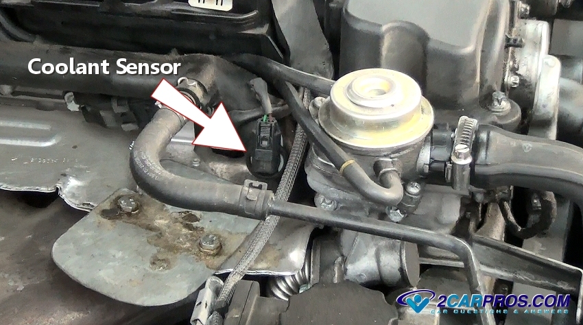

2. Locate the Coolant Temperature Sensor
There are usually only three places the coolant temperature sender can be located which are: In or near the thermostat housing, in the cylinder head, or in the intake manifold. To find where your particular coolant sensor is located, please ask one of your experts, they are happy to help. You can also purchase the new sensor and match it to the sensor on the engine.
automtoive engine coolant temperature sensor

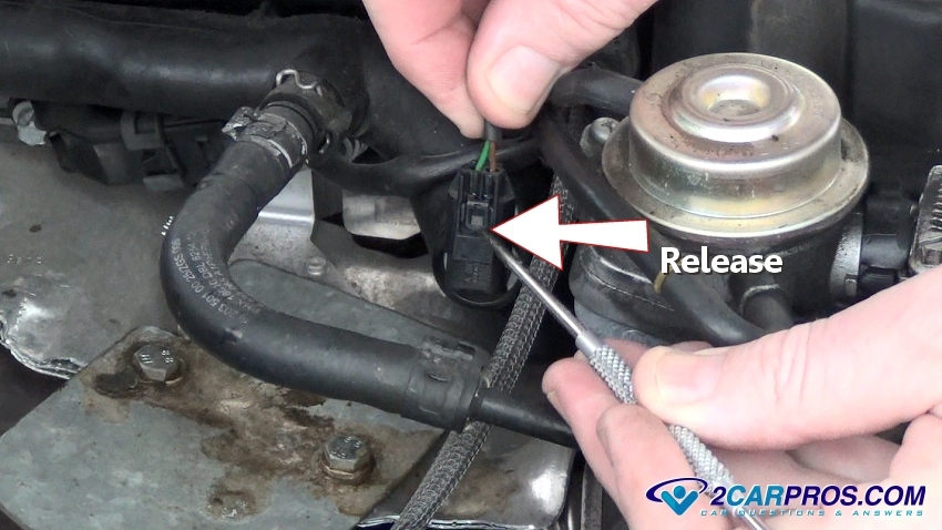

Remove the 2 wire electrical connector to the sensor which will be held on a by a safety clip. You must push down or lift upwards on the clip lever to release it.
release coolant sensor wiring connetor

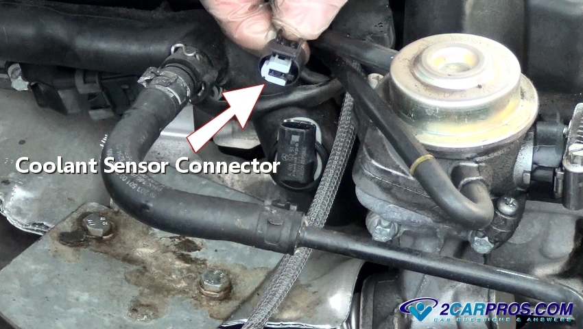

Once the safety has been released gently pull upward on the connector but be careful not to damage the wires to the connector. Also, check the electrical terminals for corrosion because this will alter the reading of the sensor which will cause false values. If rust or corrosion is present clean or replace the sensor pigtail.
coolant temperature sensor wiring connector

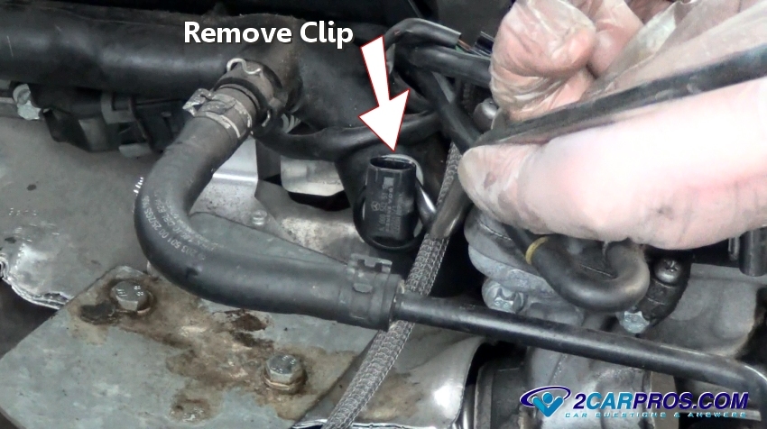

A coolant sensor will be held in place by one of two methods. The first, is a typical threaded housing which you will be able to remove using a large 22mm or 24mm deep well socket or wrench. In the example below the sensor is being held in by a large C clip. Use a pick to pull the clip upward and away from the sensor. This will enable the sensor to be removed from the coolant access port.
remove coolant temperature sensor retainer clip

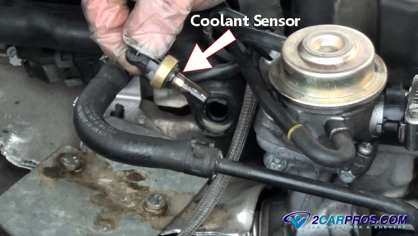

After the clip is removed or the sensor unscrewed, grasp the sensor to remove it from the coolant access port. A small amount of coolant may be expelled from the port. Use a shop towel to clean the access port free from dirt or grease.

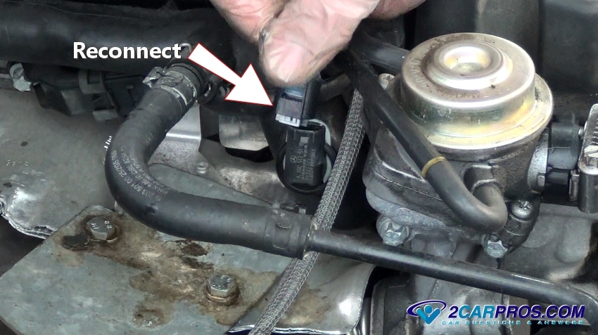

 Install the sensor by reinserting it back into the coolant access port and repositioning the clip. If the sensor is threaded in, tighten the sensor to manufacturers specific torque. Do not over tighten the sensor or you will crack the composite which will cause the sensor to send false information to the computer. Firmly grasp the electrical connector and gently push it back onto the coolant sensor until you hear an audible click signaling the complete installation of the connector.
reconnect coolant temperature sensor wiring connector
