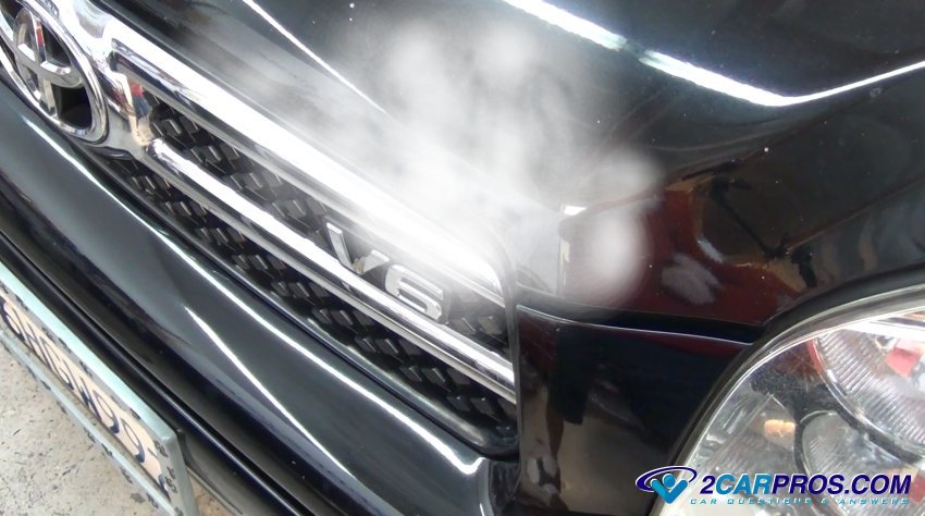

2. Steam will bellow out from under the hood, body line or grill at various times when the engine is hot.
steam coming from car hood

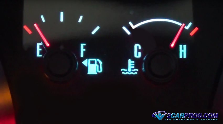

4. While driving you will notice the temperature gauge running warmer than usual or going into the red while causing the engine to overheat.

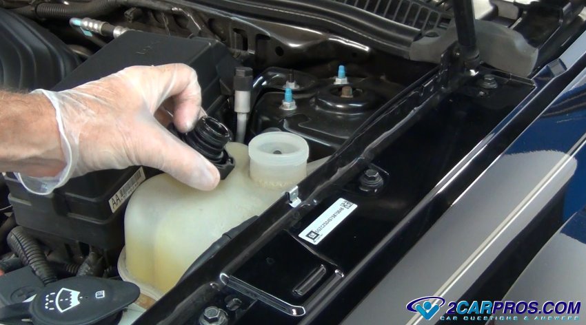

5. If you constantly add coolant to the radiator reservoir coolant is leaking internally, or externally from the system.
engine coolant reservoir empty
