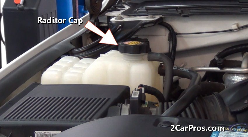

1. Locate and Remove the Radiator Cap
The radiator cap is located on the top of the radiator, or on the coolant reservoir. Some systems have two caps, one that holds pressure and the other just keeps dust and dirt out of the reservoir. Release the pressure inside the cooling system by pushing down and slowly twisting the cap counter clockwise. This will make sure there is no pressure in the system and it will allow air to enter the system while draining.
remove cooling system radiator cap

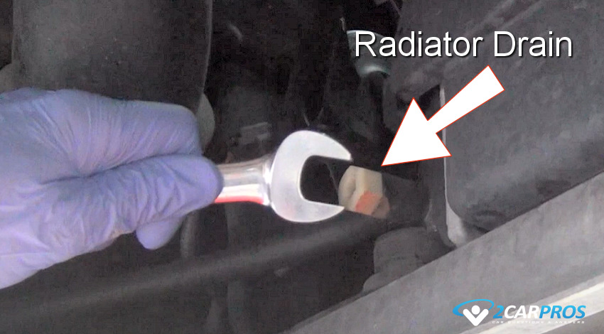

2. Coolant Draining
Most car's have a radiator drain valve that will be visible at the bottom tank or side tank. If a drain valve is not available loosen the lower radiator hose and slowly remove it from the radiator to initiate the draining process. Open the drain valve by turning the it counterclockwise, have a fluid catch basin ready to catch the draining coolant. After a short time the coolant will stop flowing which means the coolant is done draining.
You should have between 1 1/2 and 2 gallons in the fluid bucket or catch basin. Be sure the radiator cap has been removed which will help get most of the coolant out if the system. Then tighten the drain plug or reinstall the lower radiator hose.
automotive cooling system radiator drain valve

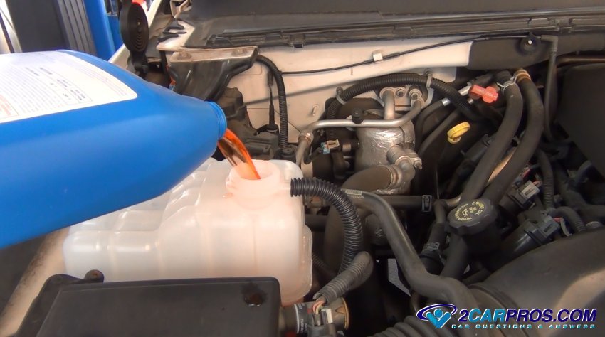

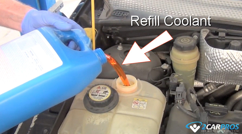

4. Radiator Coolant Refill
When you are ready to refill the system with coolant, use a funnel to avoid spillage while slowly pouring the coolant into the radiator or reservoir until full. Then start the engine and allow it to warm up while slowly adding coolant. If you have flushed the system there will be no need to mix coolant with distilled water because there will be a sufficient amount or water still remaining in the engine block.
Continue to add coolant and distilled water until you have reached the full line in the reservoir or the top of the radiator. Start the engine and allow it to warn up until the thermostat opens, you will notice the level in the reservoir or radiator drop. Continue filling the system until the coolant level reaches the hot line in the reservoir or near the top of the radiator cap.
refill automotive cooling system reservoir radiator
