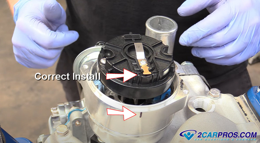

1. Remove the distributor cap to note the distributor rotor position in relation to the distributor housing. Use a felt pen to mark the location onto the housing, and then again from the housing to a reference point somewhere on the engine, this is the most important part. You can use your phone to take an image to help as well.

6.  Now, match the marks from the old distributor to the replacement unit and install it so the marks line up the same as the old one. There might be an issue caused by the distributor drive gear which will cause the rotor to be off slightly (one tooth) which is normal, simply rotate the housing to match the rotor to housing marks. If you want to have the alignment directly as the old unit please follow down this guide to show you how, also watch the video below.

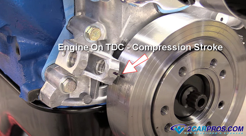

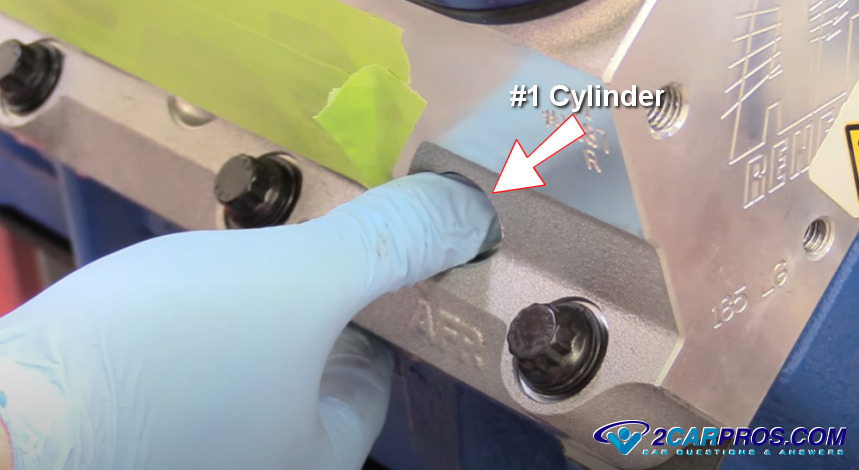

1. The engine must be on top dead center on the compression stroke to begin the process. This is done by removing the #1 cylinder spark plug and rotating the engine over by hand until air is felt escaping from the spark plug hole, and then stopping on the timing mark on the front balancer.
Here is what the timing marks on the front balancer will look like:

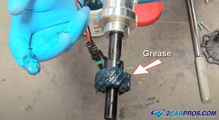

2. Use engine assembly lube or grease and apply it to the distributor drive gear, this will help lubricate the camshaft and distributor drive gears which will avoid damage.

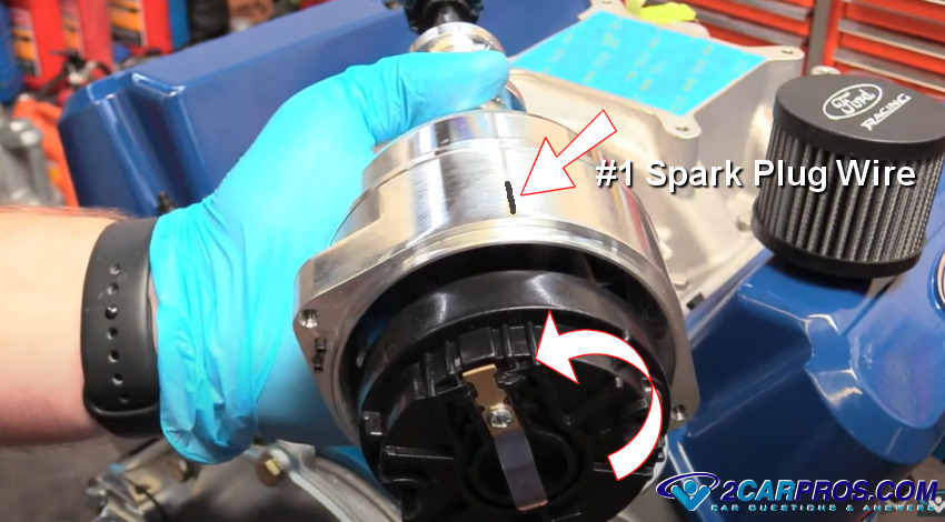

3. Located the number one cylinder spark plug wire on the distributor cap and mark the location on the distributor housing. This is where the ignition rotor should point to once the installation is complete, since the rotor will move slightly due to the "pitch" of the gears when installing it so you want to start with the rotor off to the side. Please check out the image below to see what I am talking about.

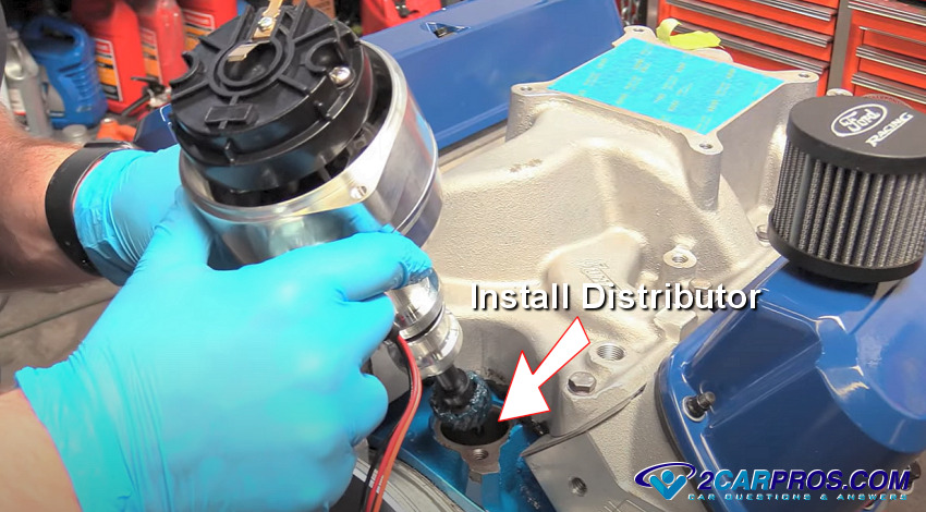

4. With out moving the distributor shaft gently install the unit into the engine block.
5. The distributor might not sit down in the block completely so don't force it. At the bottom of the distributor shaft there is an oil pump drive connection which might need be rotated slightly to get the desired rotor and housing position particularly on GM products. This can be done using a long standard screwdriver to move the oil pump drive shaft and might take more than one try. The distributor installing should look like this when completed, the ignition rotor aligned with the the #1 spark plug on the distributor cap.

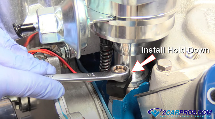

6. Install the distributor hold down bolt assembly and tighten, do not tighten completely at this time, just snug it down. Take note to confirm the housing is down completely before tightening the bolt or internal damage can occur.

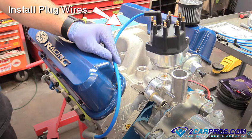

7. Install the remainder of the components such as the cap and spark plug wires by following the engine firing order.
