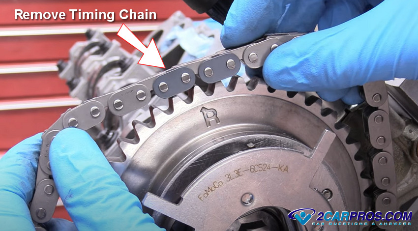

Step 6. Remove the timing chain guides and tensioner to carefully remove the timing chain. For some engine configurations a wedge can be placed between the chain and guides which helps to hold the chains in place. Use a permanent marker to help distinguish the timing marks. (Non-overhead camshaft engines can skip this step.) Note: In block camshaft engine's will have push rods and rocker arms which will need to be removed, do not mix these up, they must go together the way they came apart.

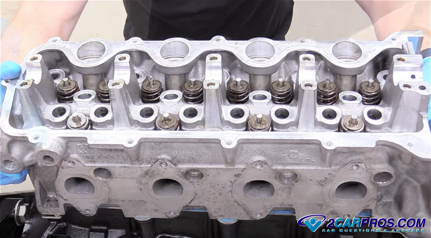

Step 7. The next step is to remove the cylinder head bolts in order to help prevent warpage. Start with the outside bolts and work your way inwards in a spiral pattern. Use a small pry bar to help break the seal of the old head gasket while keeping your hands on the cylinder head so it doesn't fall. Now, lift the cylinder head from the engine bay and inspect the combustion chambers, intake and exhaust valves. Pro tip: Take the cylinder head(s) to an automotive machine shop where they can be cleaned, pressure tested, resurfaced and a new valve job if needed.

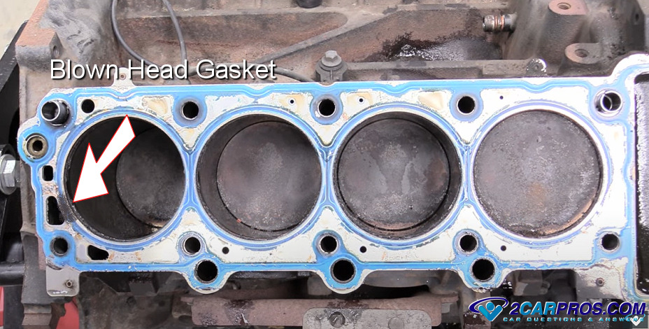

Step 8. Now that the cylinder head has been removed you can inspect the head gasket for failures which is good to find and confirm the problem. This failure is usually on the ring that seals the cylinders or the coolant passages. Check out the image below for example:

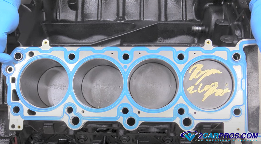

Step 9. Clean the gasket surfaces using a gasket scraper, carburetor cleaner and shop towel. This is very important and should be done with the care that if this step is not done correctly, you will be doing the job over again due to leaks. Pay attention to the block, valve cove gasket, intake and exhaust manifold surfaces which are machined smooth. Do not allow any grit or dirt to enter the cylinders of the engine or the intake manifold, this can cause damage. Once clean, install the new cylinder head gasket.

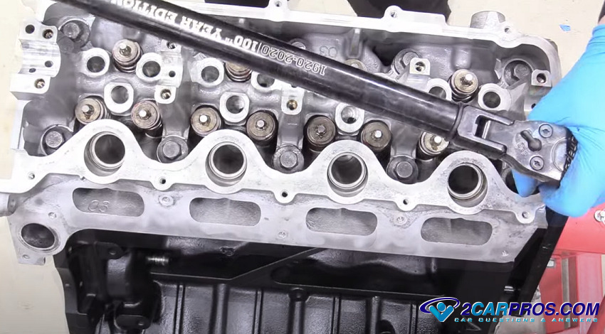

Step 10. Gently lower the cylinder head onto the new gasket and engine block, there will be alignment dowels the head will fit onto to unsure a proper installation. You must check the manufacture's tightening instructions because on some applications the head bolts are called "torque to yield" which need to be replaced each time they are used.
Tighten the head bolt evenly according to the instructions supplied by the manufacturer, if you you need help finding them please ask one of our experts at no cost. Use your torque wrench to tighten the head bolts in steps and in a spiral pattern. You will need a torque wrench capable of measuring degrees along with the torque specifications for your engine.
tighten torque cylinder head bolts

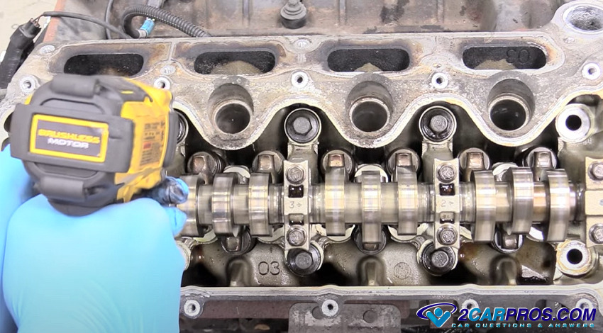

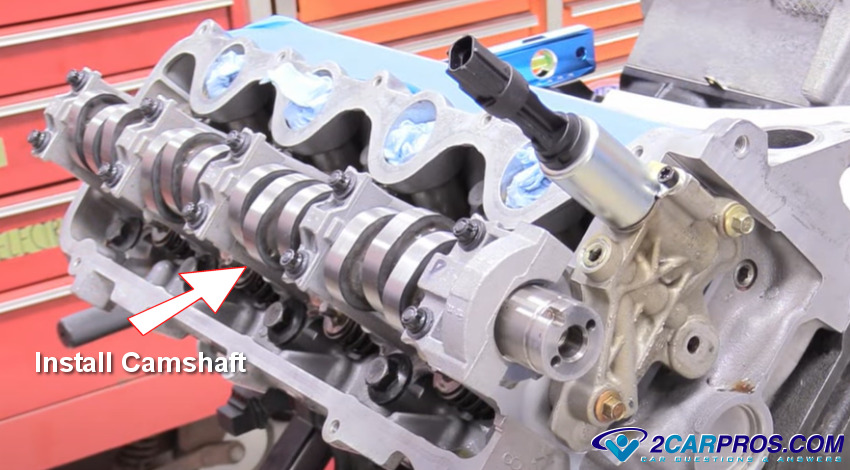

Step 11. Once the cylinder head has been installed it is time to insert the camshafts. Apply engine oil onto the bearing surfaces of the cylinder head to ensure proper lubrication for the camshaft upon start up. These camshaft journal caps will have a torque setting as well, make sure the camshafts can rotate once completed.
install camshaft

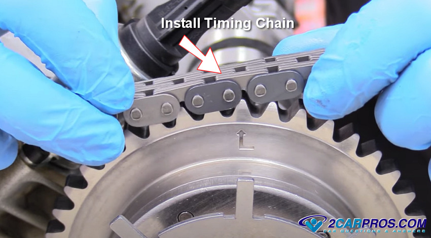

Step 12. Install the timing chains while aligning the timing chain and sprocket marks. If the timing chains, tensioner or guides look worn it is advisable to replace the timing chain and guide set at this interval.
