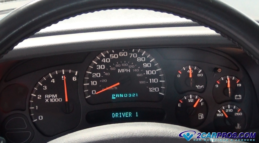

1. Clutch Slip: The clutch is responsible for transferring the engine power to the transmission and when the clutch wears it allows the engine RPM to rise without the power transfer commonly known as clutch slip. This problem will usually present itself when going up an incline in fourth or fifth gear.
Also, the clutch pedal "free play" will be gone or almost gone letting you know the pressure plate fingers have traveled outward taking up the air gap between the flywheel, disc and pressure plate. This problem is normally accompanied by a burning smell, while the clutch overheats and starts to burn up.

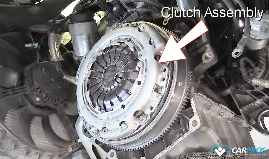

2. Grinding Gears: If the disc lining material comes apart it will "jam up" the clutch assembly not allowing the disc to freewheel within the pressure plate and flywheel. This problem causes the gears of the transmission to grind, signaling the clutch must be replaced. Also, rear wheel drive cars will be equipped with a pilot bearing which is fitted into the end of the engines crankshaft. When this bearing fails, it can seize onto the input shaft, causing symptoms similar to those of a faulty pilot bearing, indicating that the pilot bearing needs replacement.

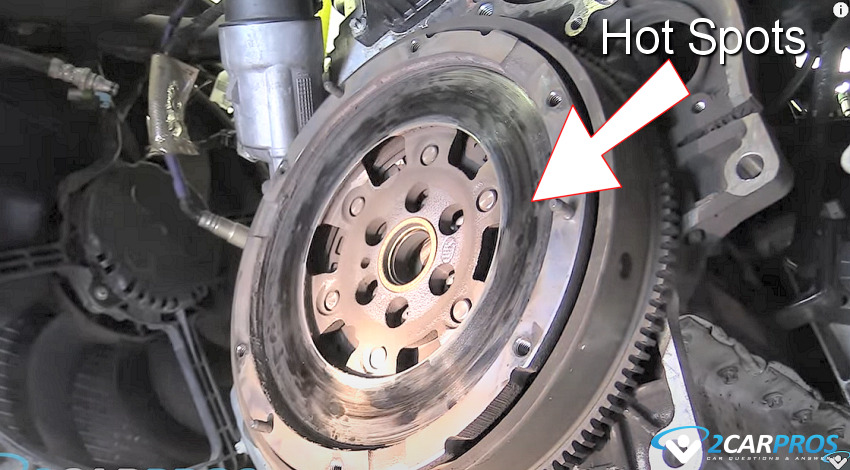

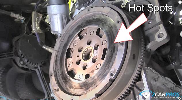

3. Clutch Pedal Chatter: When releasing the clutch pedal after engaging a gear, if you feel chatter or vibration through the pedal, it indicates the flywheel or pressure plate surface may be burnt, scored, or have hot spots. The flywheel must be removed and resurfaced, and the clutch assembly replaced.

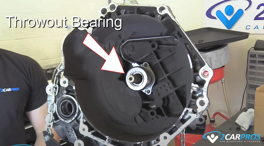

4. Unusual Noises: Strange sounds coming from the transmission area can be a sign that the clutch or associated components are failing. Listen for squeaking, grinding, or rattling noises, particularly when depressing or releasing the clutch pedal. The most popular clutch part to make noise is the throwout bearing which will make noise only when the clutch pedal is pushed downward.
