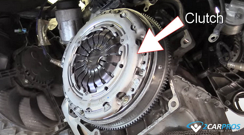

Clutch Pedal Works Normally - Wont Go Into Gear
There are two parts to the clutch assembly, the disengagement system: Pedal, clutch master, secondary cylinder, and throwout bearing, and the actual clutch assembly on the rear of the engine. Even though the clutch pedal is working as intended, the clutch may still not operate correctly.
  • Clutch Disc Failure: Clutch material has come off of the disc.
  • Pilot bearing failure: Will not allow the input shaft to stop turning, (RWD only)
  • Broken Pressure Plate: Will not release the disc.

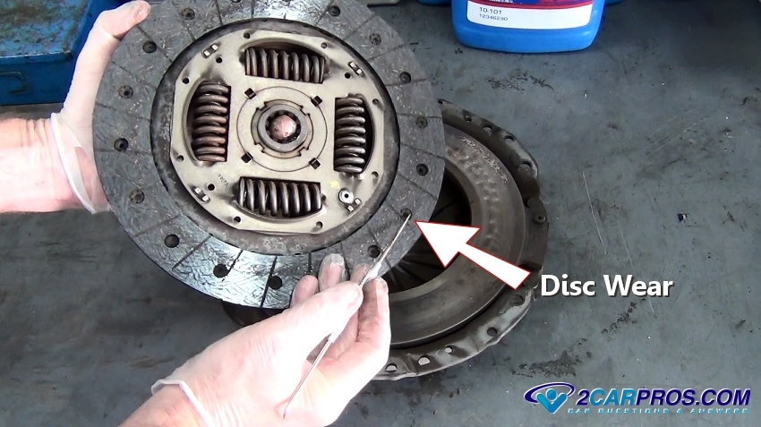

Slipping Clutch
The clutch disc and pressure plate are subject to wear over time due to friction during engagement and disengagement. A clutch is a normal wear item and should be replaced between 90k and 140k in most cases. When a clutch disc fails, the disc lining can become worn which will make the clutch slip, while not allowing the power of the engine to transfer through to the transmission. In this case, the clutch must be replaced.
clutch disc wear
