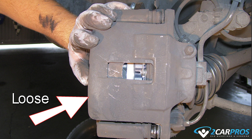

1. The brake pads and calipers are designed to slow the vehicle when applied. If the caliper is loose, or if the brake pads are not fitted properly, they will make a clunking noise when the brakes are applied. Remove the tire and gasp the brake caliper to wiggle it back and forth to check for movement, also check the brake pad fitment and ensure the anti-rattle clips are in place.

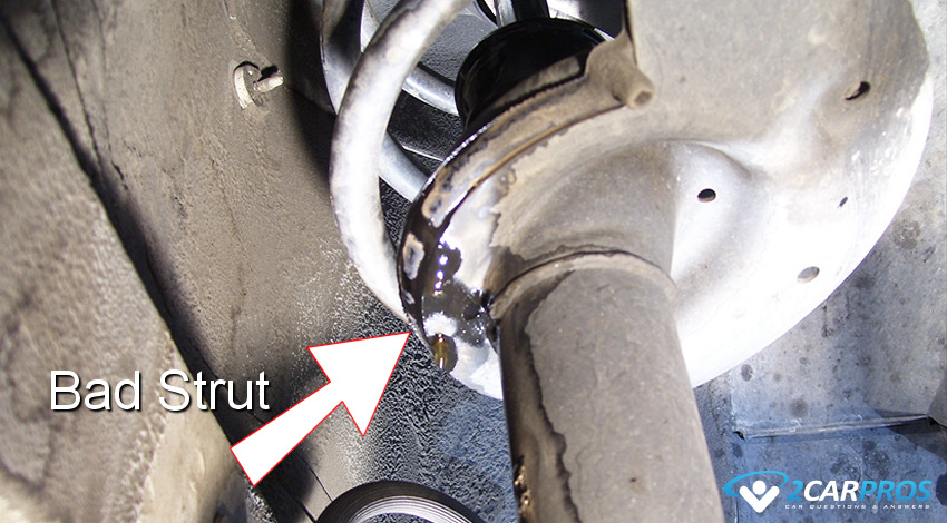

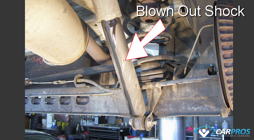

1. Struts and shocks are created with hydraulic dampening valves which fail causing a clunking noise. Use a flashlight to looks for obvious signs of leakage which indicates the strut or shock has failed, and needs replacement. In the example below the seals have let go and the shock is blown out.
