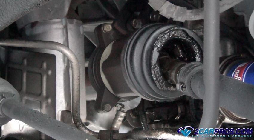

1. CV Axle Failure: On front wheel drive cars there will be two CV axles, one on either side, right and left. After time and usage these CV axle can wear causing a clicking noise when turning right or left, or when accelerating. As expected if you turn right and hear the noise, the right side CV axle needs replacement, and vise versa. Look for any visible damage to the CV joint boots (rubber coverings). If they are torn, cracked, or leaking grease, this indicates the CV joints may be compromised.
Note: If the CV boot is torn some might say you can just replace the boot but it has been our experience once the CV axle starts to make noise most of the time a new CV boot will not help.

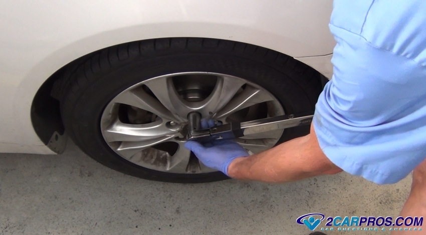

3. Loose Wheel Lug Nuts: Lugs nut are designed to hold the wheels onto the axle or bearing hub. When these lugs come loose they allow the rim of the wheel to move slightly which makes a clicking sound. Use a torque wrench or breaker bar to check the lugs nuts of each wheel to ensure their tightness. If you are using a torque wrench most lug nut need to be tightened between 75 and 95 foot pounds. If the lug nuts have been loose for an extended amount of time it could allow the wheel to come off while damaging the rim or wheel studs.
tighten wheel lugs
