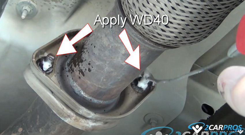

1. You will get a better result if you apply WD40 or an equivalent to the front exhaust flange and tail pipe flange connection bolts, along with the oxygen sensors before you begin. Allow time to pass for the penetrating oil to do its job while dissolving rust.
apply wd40 to catalytic converter bolts

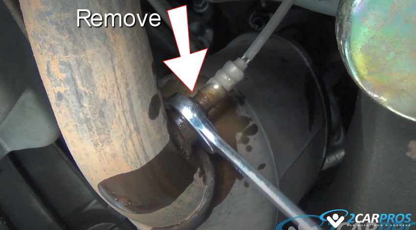

2. While the penetrating oil is settling in, locate and disconnect the oxygen sensor electrical connectors that are mounted on the catalytic converter, and sometimes in the head pipe. You can leave the oxygen sensor plugged into the wiring harness and it will just twist, which is not a problem.
remove secondary catalytic converter oxygen sensor

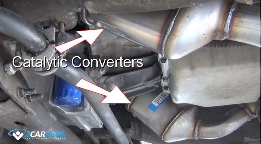

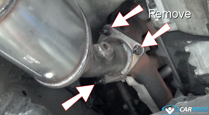

3. Remove the catalytic converter head pipe nuts, typically there will be two to three nuts, these were 15mm but yours might be different, this will help the converter come loose from the exhaust manifold.
remove catalytic converter head pipe bolts

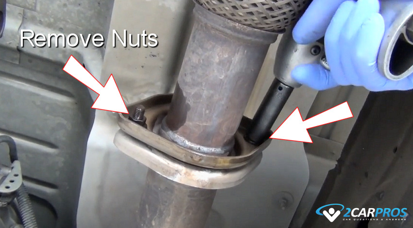

4. Continue by removing the exhaust pipe coupler mounting nuts using a 15mm or 16mm wrench or socket at the rear of the catalytic converter. Once the rear exhaust mount has been removed use a plastic or rubber hammer to separate the muffler from the catalytic converter outlet pipe. It may require some wiggling to free it from its position.
remove catalytic converter outlet pipe nuts

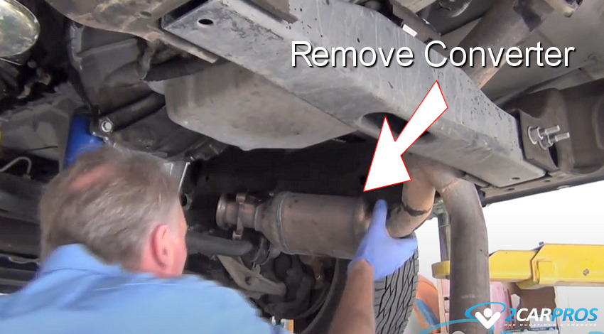

5. Grasp the catalytic converter with both hands and maneuver it out from the exhaust manifold and rear exhaust system. Some catalytic converter's have a heat shield which can be sharp so be carful not to cut yourself.

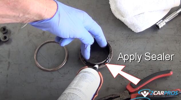

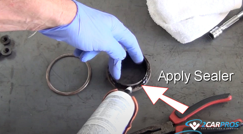

6. Match the old converter to the new unit to ensure a proper installation. Use a gasket scraper and a small wire brush to clean the gasket sealing surfaces, this will help the new gasket conform to the sealing surface which will avoid leaks. Also, apply a small amount of heat resistant gasket sealer.

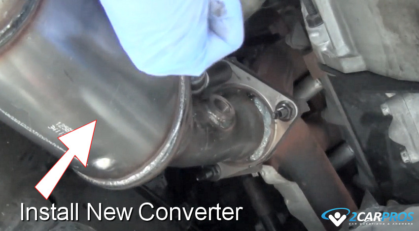

7. The new catalytic converter is now ready for installation, apply a small amount of anti-seize compound to the threads of the bolts. Gently position the catalytic converter back up into the exhaust manifold flange making sure the gasket is still in position. Guide the flange coupler onto the head pipe over the exhaust manifold studs. Some applications will use bolts instead of nuts, in which case simply align the bolt holes.
install new exhaust system catalytic converter
8. Hand thread in the mounting nuts or bolts and but do not tighten. Use a socket to take up the slack while still leaving them loose. The final tightening will be done after the rear of the catalytic converter outlet pipe has been reconnected. If you tighten these nuts or bolts prematurely it will cause a strain, and a possible leak as the unit will need to be forced into position to connect the rear of the unit. Look up the torque specs for your particular job for the final tighten and you are all set.
