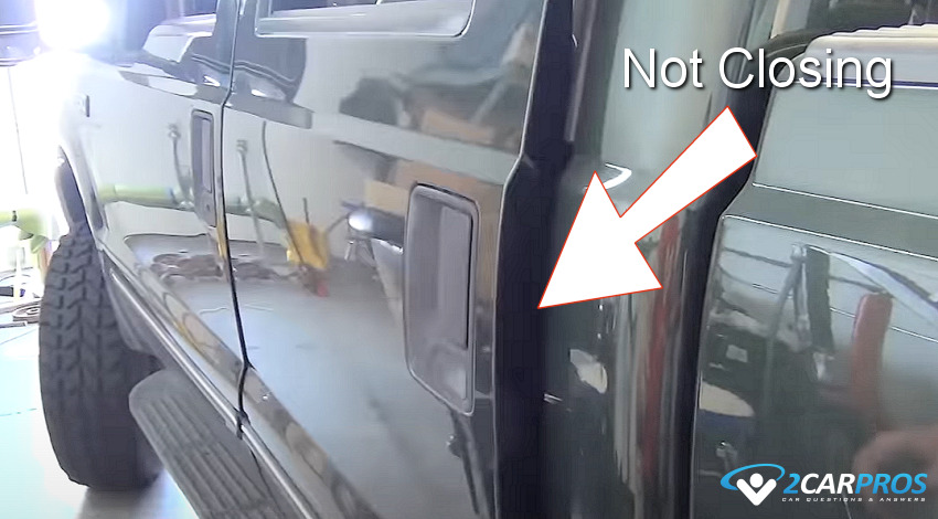

1. Check Latch Position

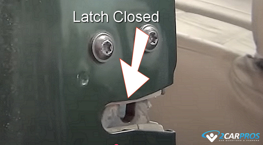

Occasionally, when a latch is opened it can have a rebound affect sometimes closing the latch just after being released. When you try to shut the door, it will bounce abruptly and then stay open. This is because the striker that is supposed to be inside of the latch clasp (pawl) is trapped outside and bounces off of the backside of the latch clasp.
automotive door latch closed position

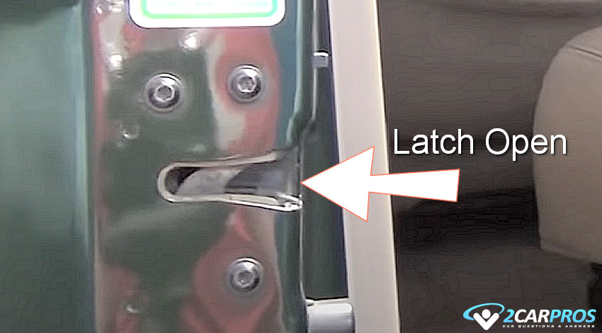

Use a screwdriver and insert it into the latch clasp opening while holding the door handle in the open position. Pull the screwdriver toward the car and outward from the door latch, this will reopen the latch. Once the door latch clasp has been released the door will return to normal working order. Close the door and reopen it to confirm the fix and you are all set.
automotive door latch open position

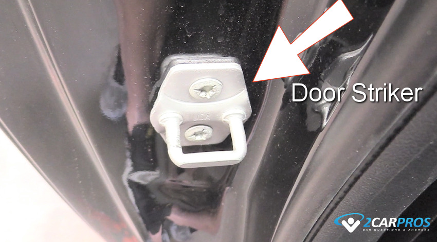

The door latch sticker sits in the door jam furthest away from the door hinge, and must be aligned with the latch to engage and disengage correctly. This alignment can be disturbed when the car door is over extended or forced upward or downward. Use a flashlight to check if the latch aligns with the striker when the door is nearly closed. The striker mounting bolts can be loosened and the location readjusted up, down, or in/out until it lines up correctly with the latch to regain the correct operation.
automotive door striker
