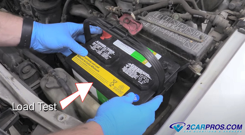

Battery Load Testing - No Equipment Required

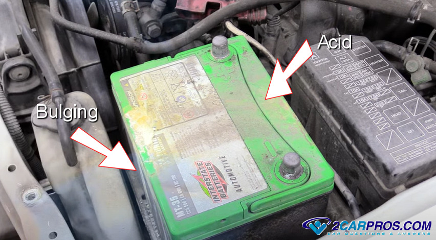

1. Open the you car hood to locate the battery to check its condition, (some batteries are located in the trunk, or under the rear seat). Inspect the battery case for leakage or bulging which is an indication of warped internal plates which can short circuit.

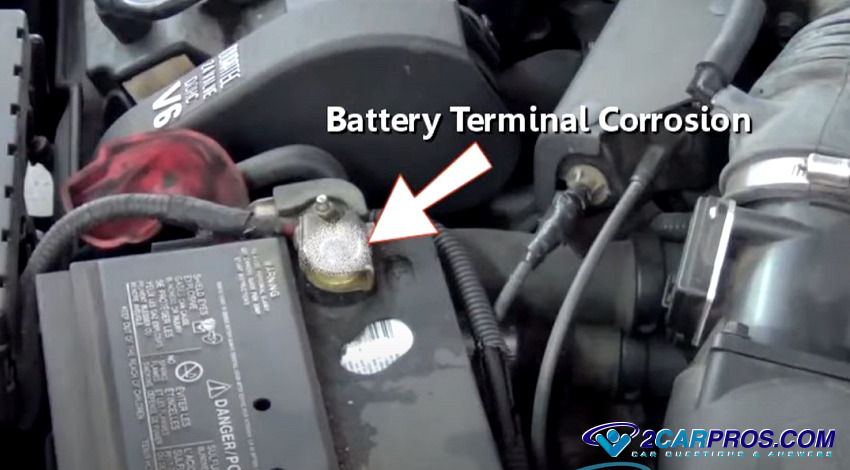

2. Look for corrosion at the positive and negative battery terminals, which can eat away at the metal inside the battery cables and can cause a connection problem.

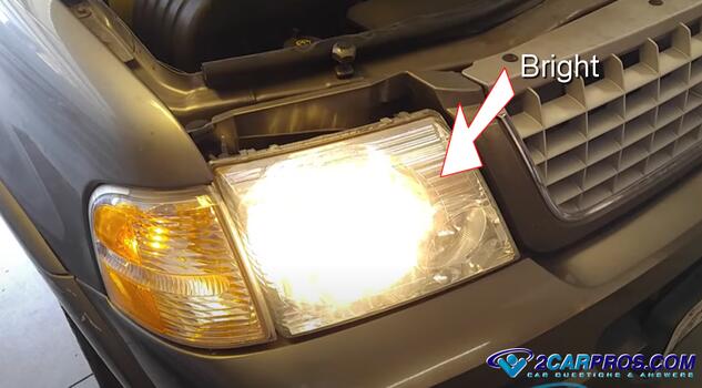

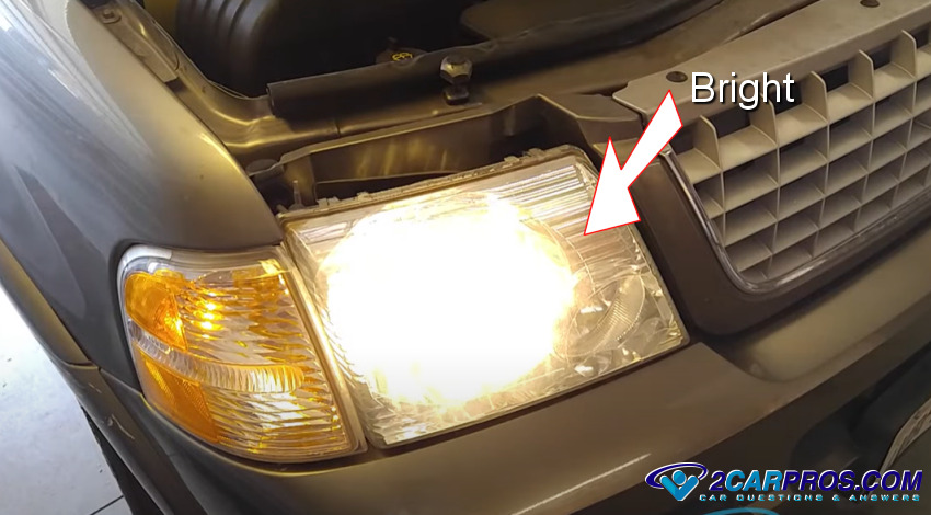

1. Turn the headlights on, and leave them on for about 15 minutes (do not start the engine), they should remain bright much like when the car is running.

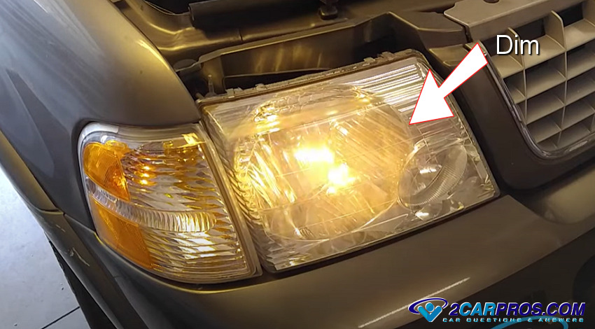

2. After the fifteen minutes is up and while the headlights are still on, try to crank the engine over while observing the headlight bulb brightness. The lights should only dim slightly when using the starter. If the headlights dim way down and go out, or you notice the engine is cranked over slowly followed by a ratcheting style of clicking noise the battery has failed and it must be replaced.
