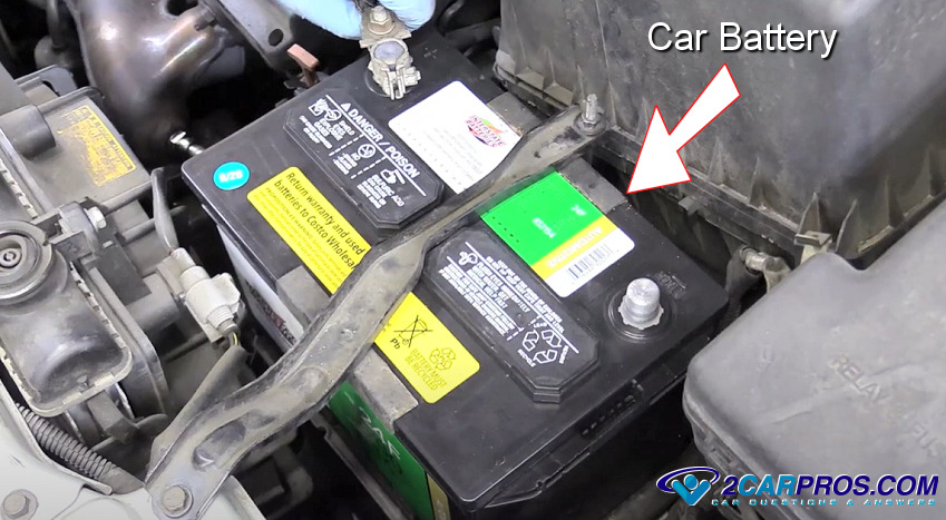

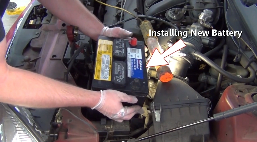

1. The most common problem for a battery to be dead in the morning or after the car has been sitting for a while is a weak battery. To confirm this issue charge the battery, then use this battery load test guide which is easy because there is no tools or equipment needed. If the battery fails the load test it will need to be replaced. A sure sign the battery is bad is a sulfur or rotten egg like smell. A battery will typically last between 4 to 5 years in most cases, if the battery is okay please continue.

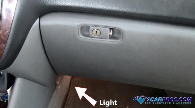

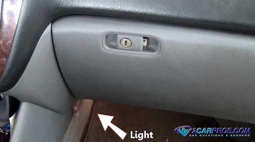

2.  Inspect the glove box light which is controlled by a small pin switch inside the box door frame. If this switch malfunctions or is misaligned it will allow the light to stay on draining the battery. This can be sometimes tough to see in the bright light of day so it's best to check this during the evening time. Look for light inside the glove box through the small cracks in and around the box door. If the light is on, open and inspect the light switch to replace if needed, or make minor adjustments to help it work correctly and turn the light off.
This can be applied to the trunk light as well. Pop the trunk open to observe the light, then slowly close the lid while watching the light through a small opening near the rear of the trunk lid, the light should go off. If the light stays on, replace or adjust the pin control switch or trunk latch.

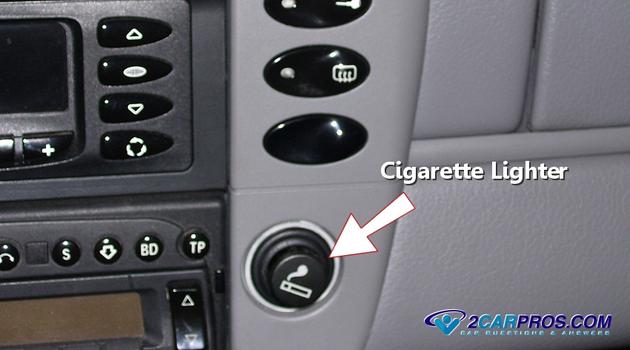

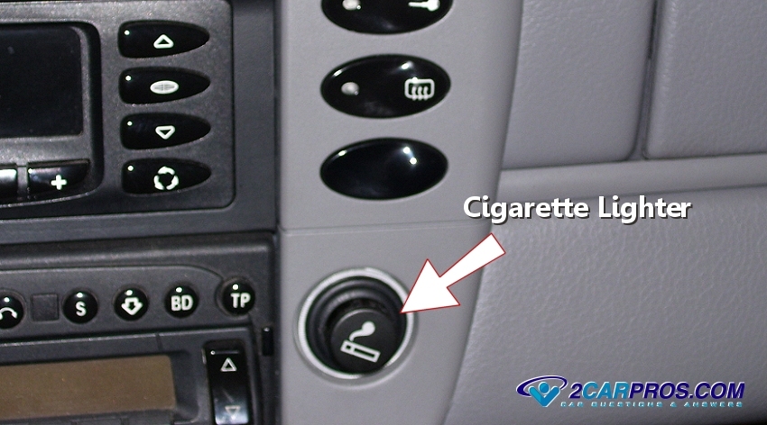

3. Check the cigarette lighters in both front and rear passenger compartments to see if the lighter itself is stuck down which is usually accompanied by a fair amount of heat, pull the lighter upward to stop the electrical draw, in this case the lighter has gone bad and needs replacement.

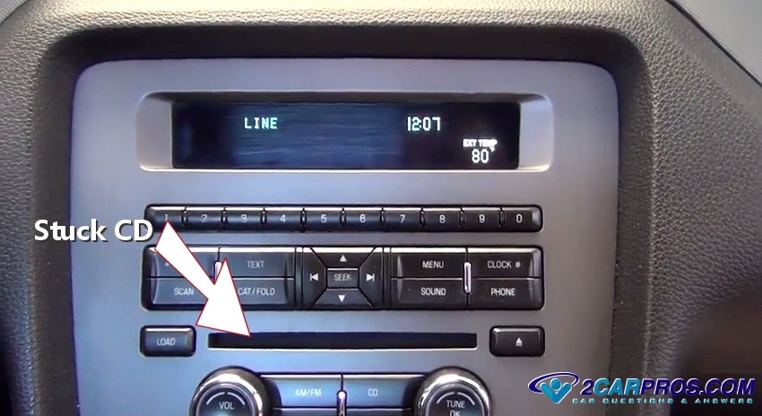

4. When you shut the ignition key off the radio turns off as well, this is not true for the CD player and changer. If a CD gets stuck in the load or eject position it will continue to work the small motor inside the player while draining the electrical system. With the key off listen closely to the player, if you hear a motor running a CD is stuck. Try to work the CD either in or out using a small tweezers or flat blade screwdriver. If you cannot retrieve the CD, pull out the radio fuse until you can replace the unit or have it repaired, this will stop the battery draw.

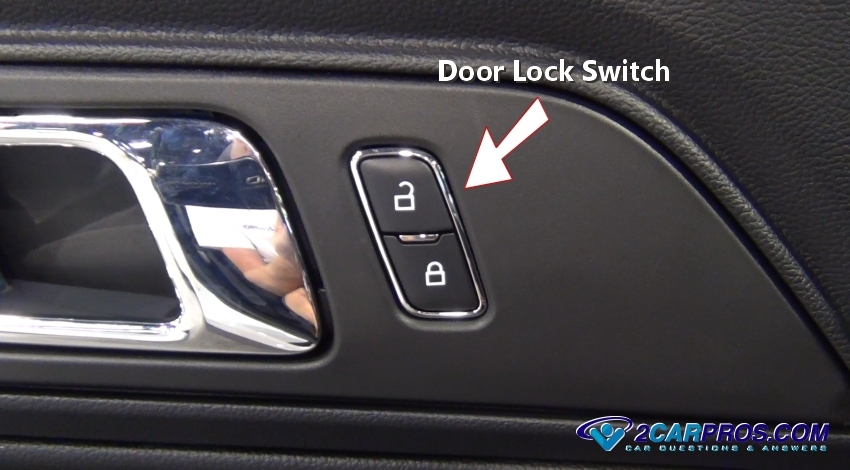

5. The door lock switch is constantly hot or live with electrical power. Sometimes the control switch will get gummed up with dirt or soda which makes the switch stick in the lock or unlock position. This will force the lock actuator in the door to stay on which will draw the battery down. Inspect the lock switch to make sure it returns to its neutral position. If this switch is broken or permanently stuck, replacement is required.

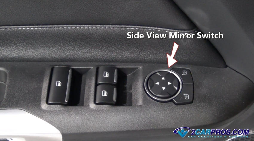

6. The side view mirror switch continues to get power after the ignition switch is off. This switch like other switches can get gummed up from grime and soda which can hold the switch on forcing the motor to draw power. Check the switch operation to ensure that it returns to its neutral position. If this switch is broken or stuck it will need to be replaced.

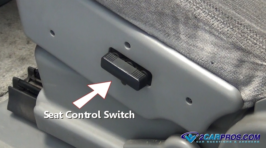

7. Inspect the electric seat control switches, this switch can become sticky or weak allowing the switch to stay engaged forcing the seat motor to draw power from the battery. To check for this condition observe the operation of the seat control switch if it doesn't return to it's neutral position or is sticking in one position replace the seat switch with a new part which you can get from Amazon or the dealership.

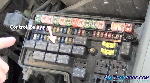

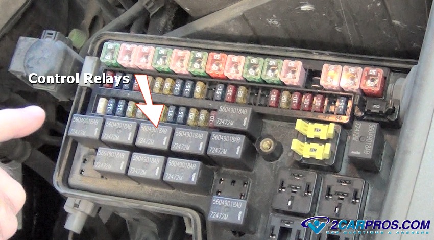

9. A control relay is a small electrical component that turns on and off larger items such as a fuel pump or an air conditioning compressor. When a relay goes bad they can "stick" causing the component to stay on even when the key is off. Locate the under hood and interior fuse and relay panels and remove their covers. Next, touch each relay to check for heat, if a relay is found remove and replace it with a new relay.

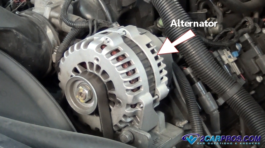

10. Check for warm components such as the alternator, air conditioner compressor clutch and electric steering rack motor (if equipped). Locate the alternator and feel it with your hand to check for warmth, if the alternator is warm with a possible burning smell there is an internal short and the alternator must be replaced.

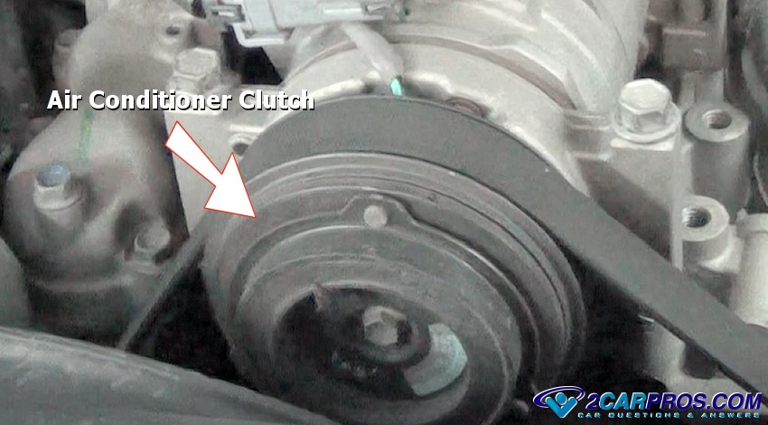

11. An air conditioner clutch is common to create a battery draw due to a stuck relay, to see if this is your problem place your hand on the front of the compressor to check for heat.

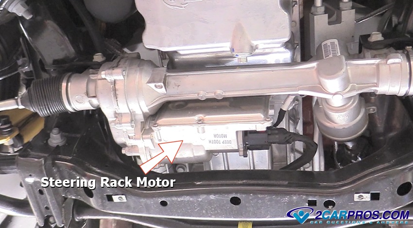

12. A steering rack is powered by an electric motor which is controlled by a relay or module, either should be cool to the touch.
