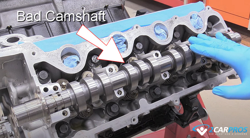

Symptoms of a Bad Camshaft
1. Engine Ticking or Tapping Sounds: By far the easiest way to tell if the camshaft is going bad is engine tapping or ticking sounds which increase in frequency as engine RPMs rise and is due to the extended clearance between the camshaft lobe on the rocker arm, or roller follower. Because the camshaft lobes are responsible for opening the intake and exhaust valves they can wear down, (lose metal). This is why it is important to find this problem early and before this rouge metal destroys the internal workings of your engine.
2. Check Engine Warning Light: The computer in your car is designed to detect anomalies in the performance of each cylinder so when the rocker are or camshaft followers do not open a intake or exhaust valve fully the computer will detect a misfire for that cylinder, Use a scanner which will give you a code that can tell you which cylinder the camshaft is having an issue on. Misfire codes like P0300 (random misfire) or specific cylinder misfire codes (e.g., P0301 for cylinder 1) could indicate camshaft issues.
3. Backfire Through Intake Manifold: While under load, the engine will backfire through the intake manifold due to the trapped combustion event, which is then released into the intake manifold, where it ignites the intake fuel air mixture charge creating the aforementioned backfire.
4. Phantom Camshaft Position Sensor Failure: A severally worn camshaft can cause inconsistent camshaft rotations, triggering diagnostic trouble codes like P0340 or P0341, which refer to camshaft position sensor circuit malfunctions. A scanner can be used to read the waveforms of the camshaft rotations where the inconsistencies can be detected.
5. Metal in Engine Oil: When you check your engine oil and notice metal sparkles, this can be sign the engine camshaft is going flat. This metal is a by product of a combination of the destruction of the camshaft lobe and the lifters or roller followers.
6. Cylinders Misfires: If a camshaft breaks, some cylinders will be affected but not others, for example: If the last two cylinders have no compression you may suspect a broken camshaft due the non operation of the valvetrain, this is not a common occurrence but it does happen.
