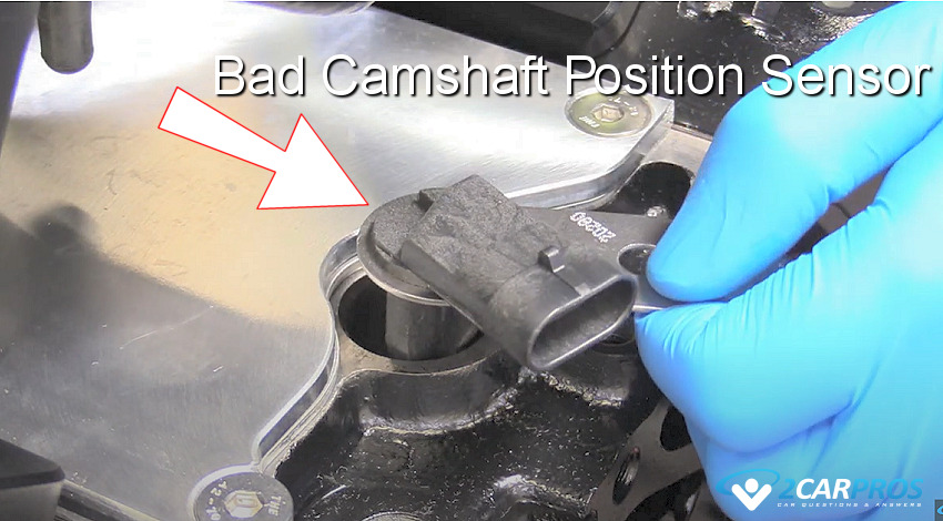

An automotive engine camshaft position sensor is a simple two wire magnetic sensor that triggers a signal to the engine control module. This information is then used to help refine the engine emissions through data matching and confirm variable camshaft positions as the engine computer advances camshaft timing. In this guide, we'll explore the common symptoms of a bad camshaft position sensor and how to identify them in your vehicle.

Inside the camshaft sensor there is small gauge copper wiring that is subject to the heat and vibrations, over time these windings can break or short circuit hindering the ability of the sensor to read the magnetic rotation of the camshaft. This can cause the engine to run rough while cruising or at idle, occasionally the engine can enter limp mode.

1. By far, the easier way to tell if the camshaft sensor is bad will be because the check engine light has come on. If you have any of these codes, the camshaft sensor may be bad and need replacement, but not always. If you need help located the camshaft sensor on your car please ask one of our experts to help, it's free.
