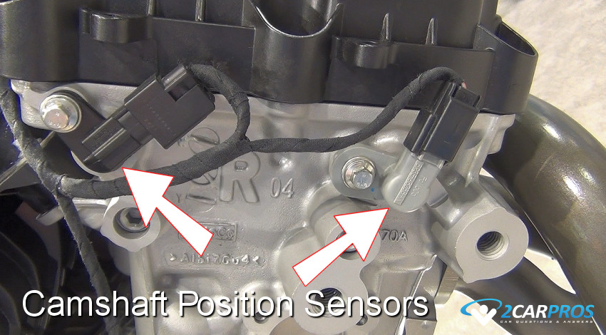

1. Camshaft Sensor Location: On overhead camshaft style of engines this sensor will be located at the top near the camshafts themselves. If you need help with the sensor location, please ask one of our experts, for free. Remove any components obstructing access to the camshaft position sensor. This may include the air intake hose, engine cover, or other parts.

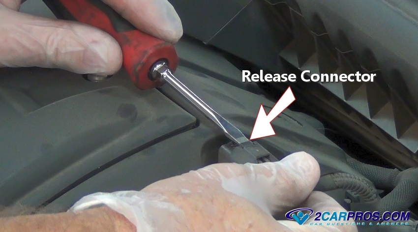

2. Remove Electrical Connector: Press the tab and gently pull the connector off the sensor, it can be a little stuck due to the weather pack seal inside the connector which is designed to keep out moister. Do not use excessive force as this could damage the wiring harness.
release camshaft sensor conenctor

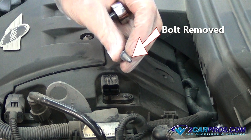

3. Remove the Camshaft Sensor Bolt: Using a 10mm (in most cases) socket or wrench remove the camshaft sensor mounting bolt by turning it counterclockwise.

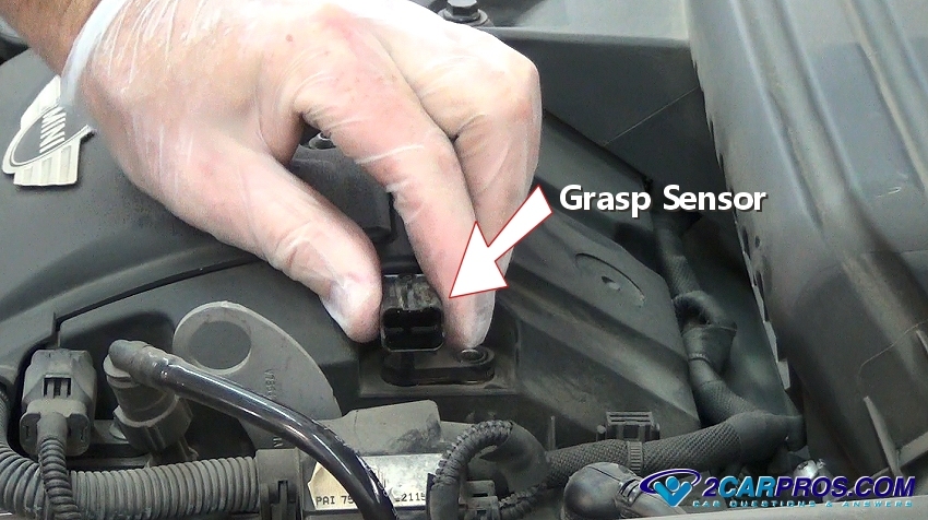

4. Remove the Camshaft Sensor: Grasp the sensor, and with a twisting motion pull the sensor from the engine. This to can be slightly stuck due of the O ring seal which is designed to control engine oil leakage.

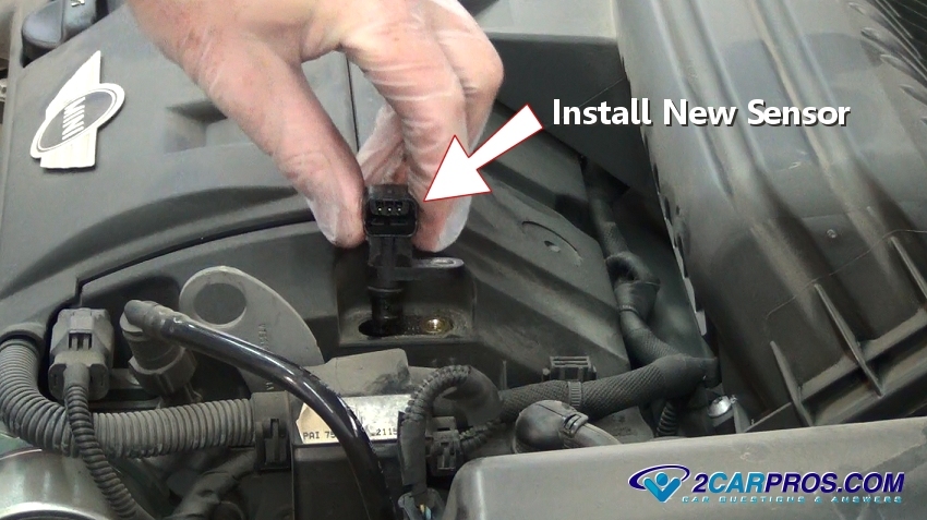

5. Install New Camshaft Sensor: After the old sensor has been removed, compare the new sensor to ensure a proper installation. Be sure the new sensor has a new O ring seal to avoid oil leaks. Use a shop towel to clean the area to help avoid leaks. Then apply a small amount of engine oil or WD40 to the O ring seal and gently push the sensor into position. The oil helps lubricate the seal, which will avoid damage during installation.
Insert and start the mounting bolt by hand to avoid cross threading, avoid starting the bolt while using a socket. Use a small socket or wrench and tighten the sensor mounting bolt, this bolt needs to be snug and not super tight because it only holds the sensor in place.

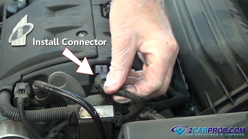

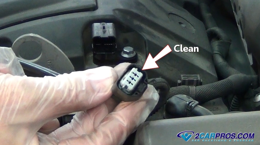

6. Reinstall Electrical Connector: Inspect the wiring connector to make sure it is free from grease, dirt and corrosion and clean if necessary, apply dielectric grease before installing it onto the new sensor. Inspect the wiring of the connector because this is usually where breaks can occur.
clean camshaft angle sensor connector
Firmly install the electrical connector by pushing it inward toward the connector. You should hear an audible click when it is completely installed. Once the repair is complete clear the codes and you are all set!
install camshaft electrical connector

  • If your vehicle has multiple camshaft position sensors, replace them in pairs to avoid future issues.
