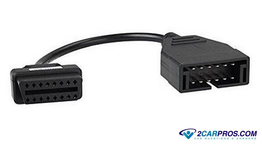

Chevy obd1 code- gathering adapter
 This guide demonstrates how to gather diagnostic trouble codes and their definitions for GM manufactured vehicles made before 1995. Most GM cars (non classic) made before 1995 are equipped with the ODB1 computer operating system. This system is unique to the GM manufactured cars which include: Buick, Cadillac, Chevy, GMC, Oldsmobile and Pontiac. To start diagnostic trouble code gathering locate the ALDL (assembly line data link) connector which is located on the driver’s side lower part of the dash on most cases. In this connector are two terminals that need to be connected with a wire jumper. Once the wire is inserted into the connector turn the ignition key to the "on" position without starting the engine. The check engine light will begin to flash, count the flashes, this will be the first digit of the two number code, example for code 14, one flash, pause, then four flashes.
