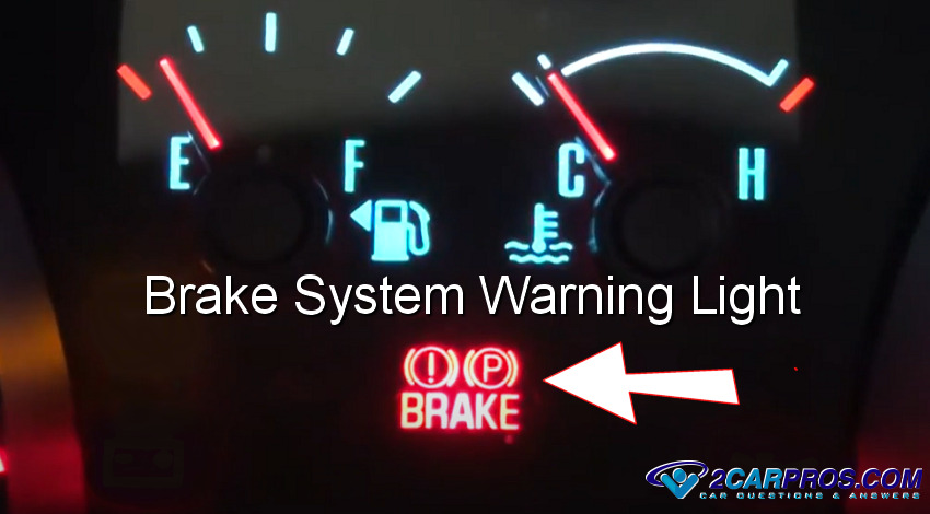

 The (red) brake system warning light is designed to warn you of a pending danger that affects the immediate braking ability of your car. Understanding why this light comes on and how to diagnose it can prevent serious accidents and costly repairs. The brake warning light is a multi functional light system which is connected to three different monitoring devices.
  • Brake fluid level sensor inside the master cylinder.
  • Parking brake lever or foot actuator arm.
  • Drop in brake system pressure.

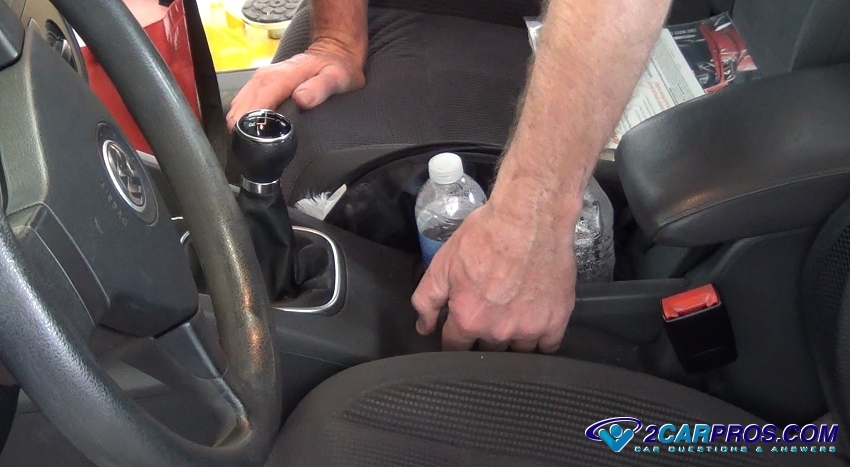

1. Check Parking Brake: The parking brake lever or pedal is equipped with a warning switch which is designed to inform the driver that the parking brake is still on, this is to avoid overheating the brakes and causing damage. Check to make sure the brake lever is all the way down, or if your car has a parking pedal, reach below the pedal and pull it upward. Occasionally the switch that monitors the pedal or handle can break or become misadjusted which can keep the light on.
checking the parking brake lever

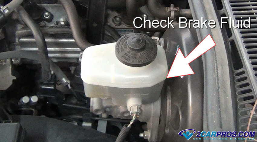

2. Check Brake Fluid Level: A minimum amount of brake fluid must be present in the system for it to work correctly, a fluid level sensor is located inside the brake master cylinder fluid reservoir which monitors the fluid level. With the hood open, locate this reservoir and use a flashlight to check the fluid level against the "MIN" and "MAX" marks, add brake fluid if low. If the brake pads are worn and need replacement, the brake fluid will be low which is normal.
check master cylinder brake fluid level
