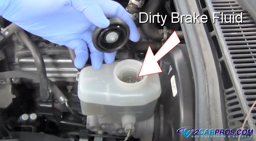

1. Dirty Brake Fluid: Because the brake fluid is circulated throughout the brake system, the fluid inside the brake master cylinder fluid reservoir will become contaminated with debris and moisture created by the normal operation of the brake system.

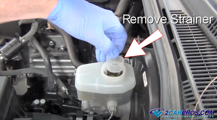

2. Remove Reservoir Strainer: Most master cylinder reservoirs have a strainer to keep large partials out of the brake fluid which will need to be removed to access the brake fluid.

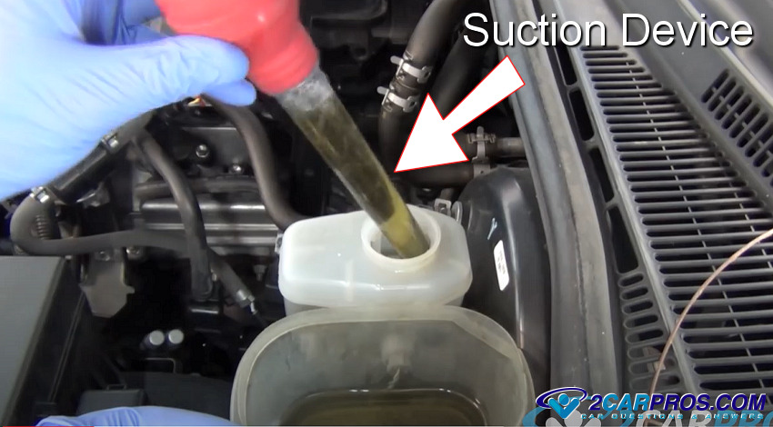

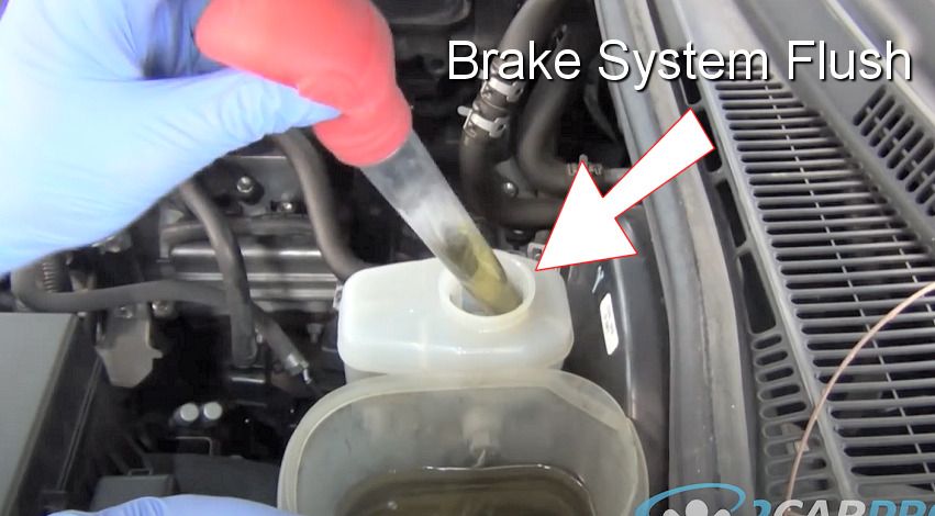

3. Use a Suction Device: Have a fluid catch container ready as you use a suction device to such as a turkey baster to help remove the old brake fluid from the brake fluid reservoir, sometimes it helps of you attach a small rubber tube to the end of the baster.
using suction device

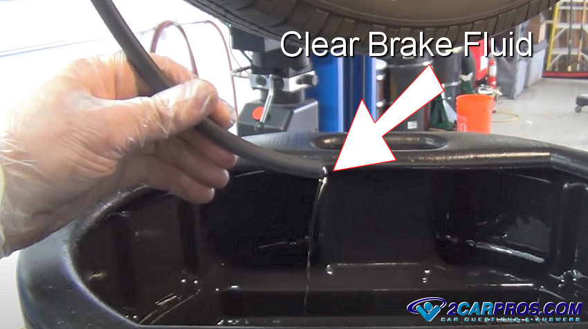

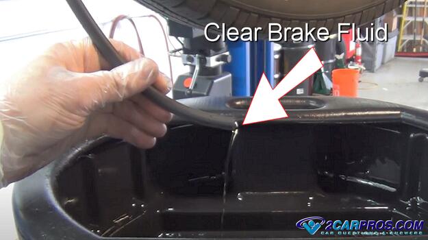

4. Clean and Clear Brake Fluid: The difference between a brake system bleed, and flush is the amount of fluid that is changed out. In the flush, the idea is to remove all old brake fluid and replaced it with new, repair shops will use a power flusher but you can simulate this by following this guide until the brake fluid runs clean: Brake System Bleed. It will take between 5 and 8 cycles to have the fluid run clear in most cases.
