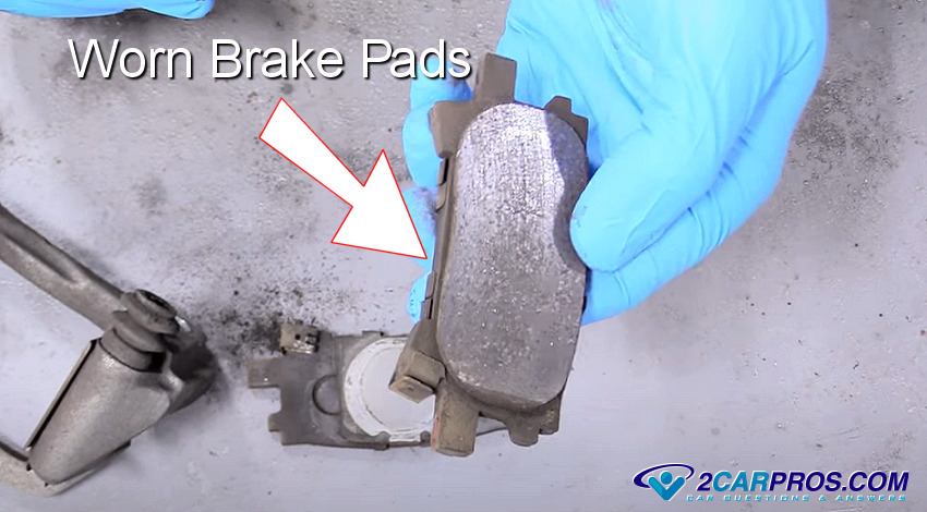

1. Squeaking while Driving or Stopping: Most brake pads are designed with a wear indicator called a "screamer" which contacts the brake rotor in such a way that when the wheel is rotated it will create a "screech", "chirp" or "squeaking" noise. This noise can be generated once the brake are applied, or simply driving along letting the driver know the brake pads must be replaced.
2. Grinding Noise While Braking: Though warning devices such as wear indicators and brake pad wear sensors are put into place to indicate replacement is required, they don't always work. In this case the brake pads will contact the brake rotor creating grinding sound as the metal backing plate contacts the metal rotor face.

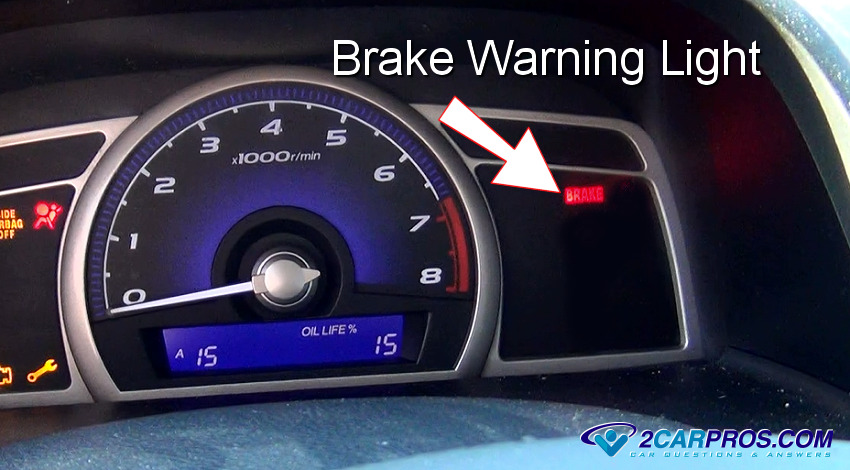

3. Brake System Warning Light: As brake pads wear, brake fluid displaces the missing pad material inside the brake calipers, when this happens the brake fluid present in the brake master cylinder will become low which will trigger the "brake system warning light" via the level sensor inside the fluid reservoir.
4. Brake Pad Condition: Brake pads require inspection from time to time to ensure their proper performance. During a brake inspection pad linings must be checked for minimal thickness of about 3 mm (0.12 inches). Also, if the brake pads are cracked due to excessive heat, or if they contaminated by brake fluid or grease they must be replaced.
5. Increased Stopping Distance: You might notice the brake system is not performing as it should, and it is taking longer to stop the car than usual. This can be caused by brake pad lining material that has come dislodged from the backing plate and only a small part of the material remains. When this happens the friction between the pad and rotor will be diminished causing the aforementioned poor braking performance.
