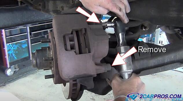

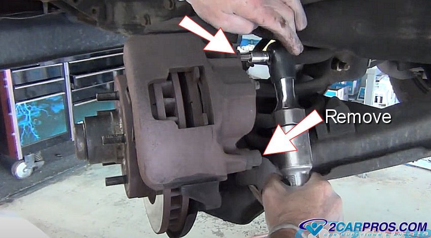

1. Using a wrench or socket remove the caliper slide bolts. These bolts can be tight so make sure the tool is squarely on the head of the bolt before applying pressure to loosen. Then grasp the caliper and forcefully and rock it back and fourth, or wedge a standard screwdriver between the pads and rotor. This is to create a small air gap between the brake pads and brake rotor, grasp and remove the caliper from its mount.

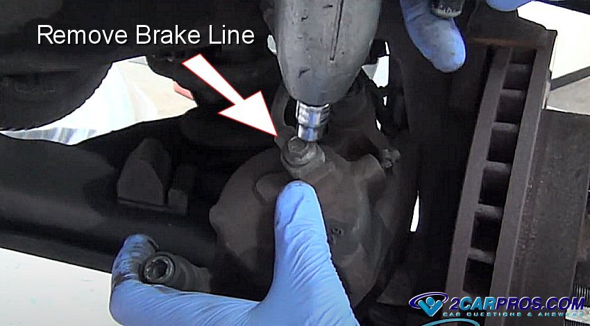

2. Remove the hydraulic brake line from the brake caliper, when this is done brake fluid will run out of the brake line which must be stopped. The preferred method is to remove the brake flex hose from the frame brake line and use a rubber cap to plug it off, an alternative method is to gently use a pair of vise grips with a rubber hose covers on each jaw and gently pinch the rubber brake hose off. Or you can work quickly to replace the brake caliper before the brake master cylinder runs out of fluid which will cause brake bleeding problems.
There will be two sealing washers that are made of copper or aluminum for the rubber brake line bulk head, these will need to be replaced.

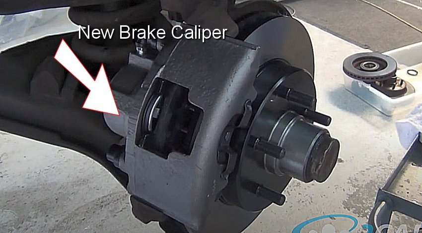

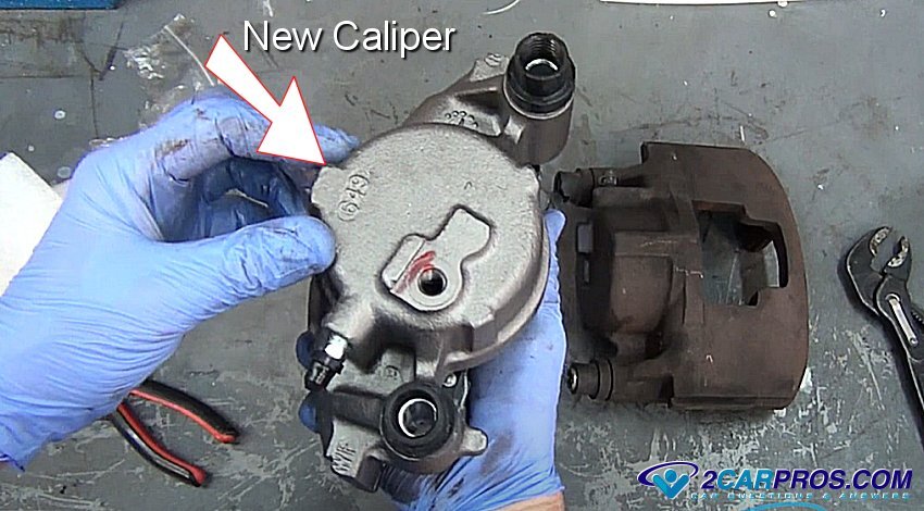

1. Match the new brake caliper to the old one to ensure a proper installation, new caliper slides, sealer washers, brake pads and mounting hardware should be included in the box.
new automotive brake caliper

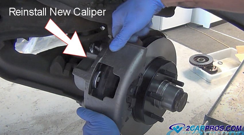

2. Clean the caliper mounting surfaces and the banjo bolt thoroughly using a shop towel and brake cleaner. When reinstalling the hydraulic hose, use the new sealing washers and tighten, use a torque spec for your vehicle, (Don't over tighten because the bolt is hollow and it can break). Also, install new anti-rattle-clips and caliper mounting hardware if any. This will complete the installation preparation and give the job a professional touch.
reinstall new brake caliper brake line

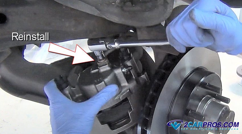

3. Gently set the new brake caliper back in place being mindful of the brake pads and mounting hardware (caliper it should drop into place naturally), then reinsert the brake caliper mounting bolts and tighten, most manufactures will tighten these bolts from 35 to 55 foot pounds so you should look yours up. Now, remove the brake line cap or vise grips and bleed the brake system, after bleeding press the brake pedal to the floor and let up slowly and repeat until brake pressure has returned and you are all set.
