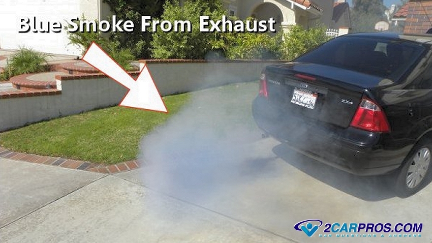

When a car is producing blue smoke it means oil is getting into the combustion chamber for one reason or another and being burnt along with the normal gasoline. This creates a blue colored smoke which is passed down the exhaust system and then exits the car along with normal gases. A blue smoke condition is typically present when the engine is under load and at first start up after sitting for a few hours.

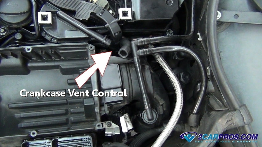

Engines are designs with a crankcase ventilation system of some kind to allow internal crankcase pressures to dissipate. This system can be built into the valve cover using an internal baffle system or the job can be done by the PCV valve (positive crank ventilation) and a breather. Both are typically found near the top of the engine or under the intake manifold on some four cylinders. Look for broken or disconnected hoses and remove and check the PCV valve. Shake it back and forth to make sure it rattles lets you know it is working.

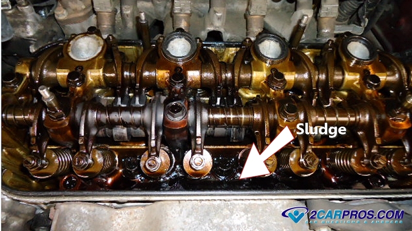

Due to poor maintenance sludge can build up inside the engine's cylinder head not allowing the lubricating oil of the valve train to drain successfully back into the crankcase (oil pan). As a result the oil fills the cylinder head forcing oil down the intake and exhaust valve stems (past the seals) and into the combustion chamber or directly into the exhaust port (fire). To check for this condition the valve covers must be removed for inspection. If sludge is found the drain back holes then must be cleaned and the sludge flushed down through the oil pan and out of the engine. After the repair it take about 2 to 4 days before the remainder of oil on the valve stems to dry up.
